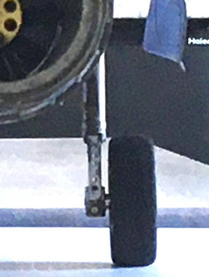

                Since first posting this in July, I have replaced both main gear due to gear servos beginning to act weird. Worth a reposting…took almost 3 months to need it.
                Did my first “adjustment” process on the “new” main gear axle pins today.
                The main gear axles eventually take a toe-out, bottom-out splay setting. The axle metal isn’t soft, but at least it isn’t brittle like the F-4 pin. You can tap the MiG’s axle with a hammer while the axle is secured in a vice without snapping it into two pieces. It takes several fairly hard taps with a hammer to bend the axle, but don’t overdo it.
                Consider the “flat” on the inside of the axle is “down”…the outboard tip must be bent forward and down. This takes a bit of mental gymnastics to ensure you are bending each axle correctly. Note: It doesn’t take but a few degrees of a bend to get the mains back like new… sitting vertically straight with no toe-out. This is not an elegant repair technique, but it works…and has been discussed in this forum before. Place only the area of the flat into the vice jaws.
                What hasn’t been discussed is how frequently the adjustment needs to be done. I reckon that depends on your landing technique and runway surface. I operate off hard surface and mostly make good landings. But I do have my share of not perfect landings. From what I have seen, the axle adjustment process isn’t needed very often. But, eventually it will be needed.
                This new set of mains probably has about 300 to 400 landings, so the axle pins hold up pretty well.

                Post bending….results below. Nice and straight!!!
                Click image for larger version  Name:	C5210261-9E4C-47B1-9D97-0BDC12899132.jpeg Views:	0 Size:	43.7 KB ID:	326367
