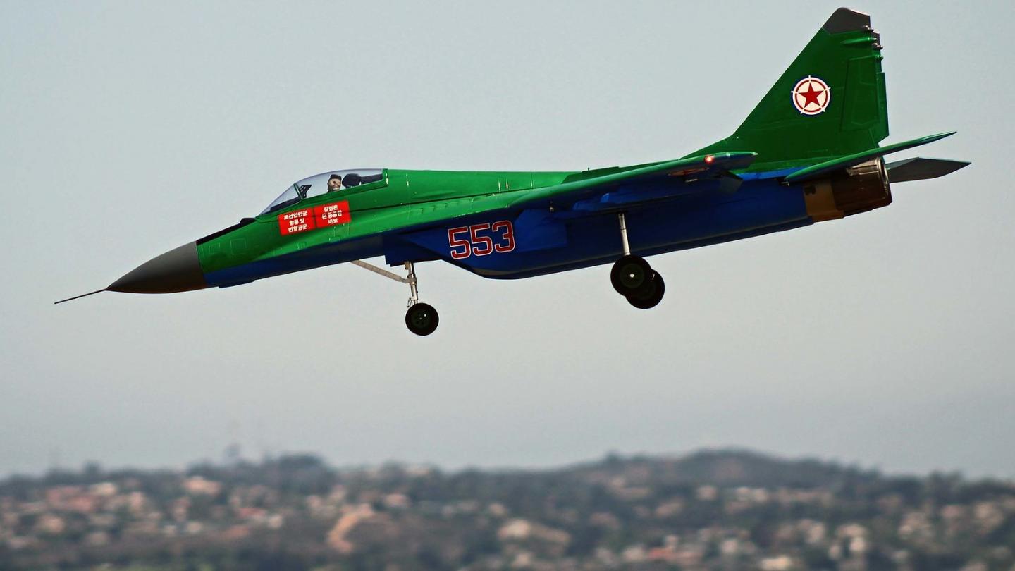

                      • Kim Jong Un doesn't take his Mig-29 out for a spin very often, but once in a while he needs to go up and unleash fire and fury on imperialist dogs.
                        I had some good flights, but nothing too fancy. I'm gentle with this one, given the crash history. I intend to reflux both ailerons and flaps up a few mm before next flights, there seems to be consensus that this helps (right?)

                        • Indeed, adding reflex will take some load off the elevator servos and require you to retrim pitch a little. Well worth it, I have about 3mm on mine.
