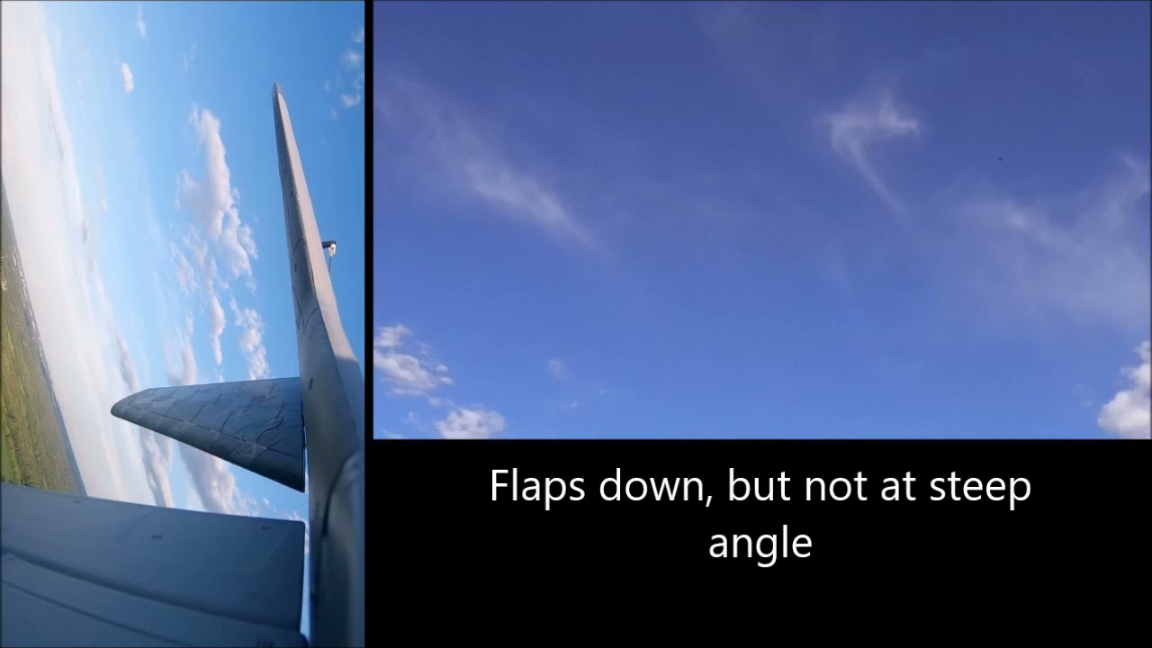

          More tests with bigger batteries. Caught early, stabilators can recover, but if with enough speed gained (last test), the problem appears; flaps-up fixes things. This might be a reason they went up to 30g.
          It may seem very brief, but you lose a lot of altitude quickly when at full throttle.

            It seems that a picture (or video in this case) is worth a thousand words. Those stabs really flex at full throttle and flaps!
              Excellent video study! What servos was this done with?
              The video shows why my first flights with the original 17g servos didn’t have issues…..I flew it like a grandpa: 1/2 throttle and no flaps until slowed on down wind after the gear was down. Faster flying was only done after upgrading the FFS servos.

                So very strong evidence of an aeroelasticity problem that may be overcome by brute force.
                A more elegant solution would be a redesign of the stab pivot geometry and mountings to reduce the flexing forces and increase the structural stiffness.

                      Last flaps-test video for now, including tufts to show airflow over the stabilator, with close-up clip of the dive at the end.
                      Captain MoMo in the background ("When are you going to dive?")

                          A Band-Aid fix today is better than a redesign years away.
                          Or just widen the flap span - they're not molded on the wings, and are an easy DIY project (balsa).
                          But probably not good enough for you, so just don't buy it (which I suspect is the case).

                                I already provided a much more elegant band-aid fix 'yesterday'.
                                Glass the stabs with a continuous ligthtweight cloth (WBPU will do), closing the profile.
                                Reinforce stab assemblies (easier way to do is by epoxying in the verticals).
                                Add some stronger servos too. Use a proper linkage. Shift CG aft, 15mm minimum, reflex airfoils. Boom, done.
