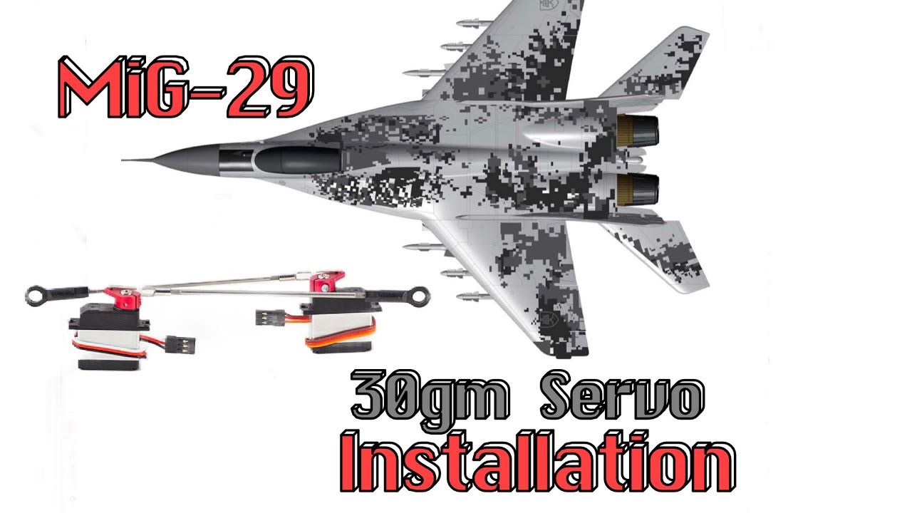

As an FYI, there was discussion about whether or not the new metal servo arms would fit the splines on the existing servos. And the answer is “Yes”. I removed the metal servo arm on the new 30mg servo and put the arm from the 17gm servo on it, and it fits perfectly. So for those who are thinking of ordering the kit “minus” the servos, when they become available— know that the new metal arms will fit your existing servo.
Those who got the 2nd run of the MiG-29 may have already installed the new 30gm servo kit. But thought I’d post a vid of how I got mine done for those who were wondering. Had just a small challenge this time around. But it was a simple fix.
When I changed out the first MiG-29 to the replaced 23gm servo there were no issues at all.

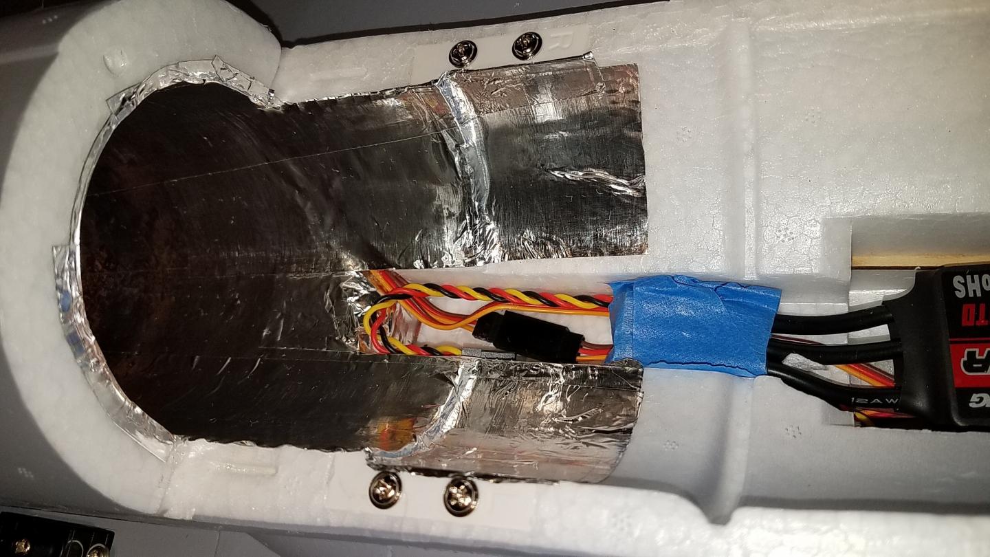

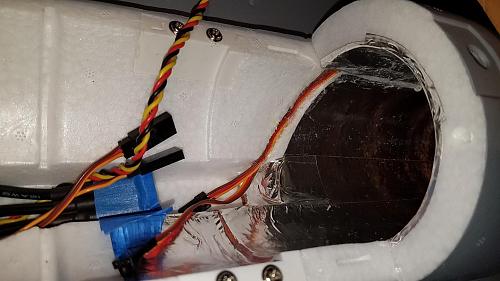

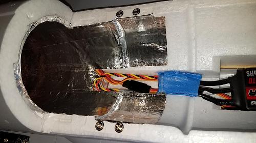

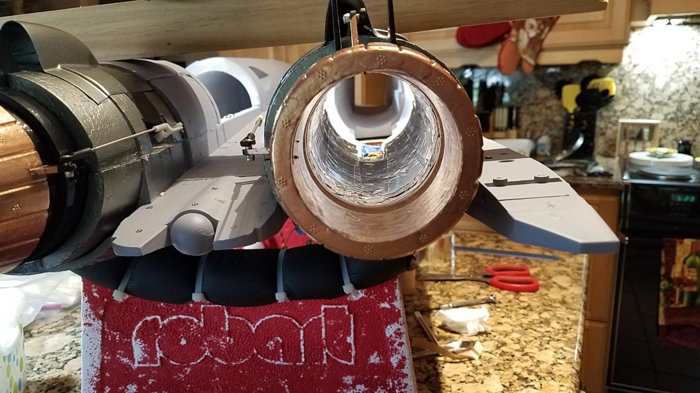

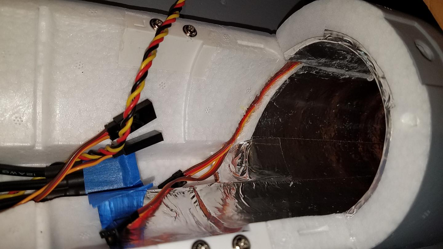

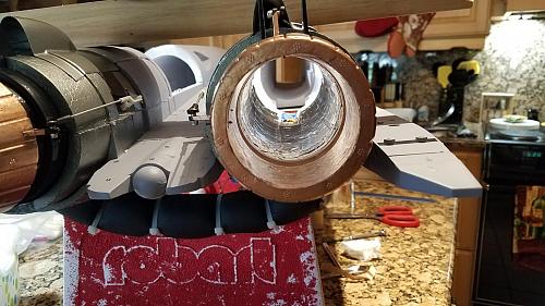

Got the TV units installed along with lining the exhaust nozzles with the aluminum foil for the AB's. I didn't particularly like the way James ran his wires outside on his installation video, so I followed some advice from RudyD54 and put the wires inside the exhaust nozzles, but cut a groove to imbed the wires and then pulled those and the AB wire through the channel under the ESC platform where the rudder wires go. Since I was installing the aluminum foil tape anyway, they covered up nicely without interfering with any fan exhaust. More later, but looks like much later!
