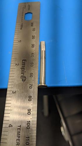

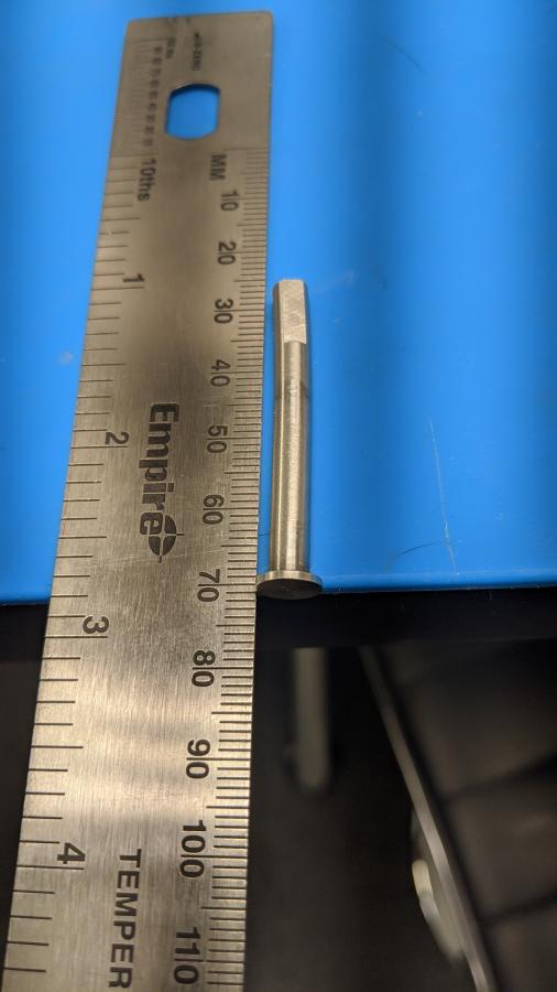

                            Originally posted by HaroldAnderson
                            Anyone had issues with toe-in or in my case toe-out on the mains? One main had quite a bit of toe-out after a few flights. I ended up forming the axle forward to fix the problem after disassembling the retract assembly and not finding a problem or an easy way to adjust the toe-in. Formed both axles but I had to form one so much that the wheel had to be pressed on the axle with some persuasion. Once on the axle the wheel worked fine and handling is great now. In the end the adjustment was quick and dirty but worked.
                            Yes, same issue here. Also disassembled the retracts but didn't find a good solution. So you just bent the axles?
                              Hello!
                              Same problem here! Can you post photos, how you fix this problem? :) Thank you :)

                                    Originally posted by Jacckall
                                    Hello!
                                    Here is a picture of the 'formed' axle. You remove the axle from the gear by loosening the 2mm set screw at the bottom of the gear. Place the axle in a vice and carefully tap it with a hammer in the direction you need it to go. You can see the vice mark on the axle at about 45mm reference point on the ruler. The short portion of the axle was in the vice and you lightly tap the outer part. It may take several tries to get it right but it only takes 5 minutes to do. It's redneck but no more toe-out. Happy landings again!
