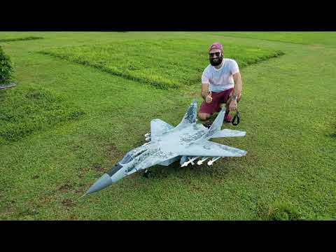

    Hey I got my Mig out for a maiden and 3 flights. It's kind on puny compared to my A-10 though!
    OK, OK, it's not mine. It's RudyD54 Mig (but when he's not looking I'm going to snatch it-he won't miss it crammed in that Mini Cooper). He flew it great, I'll upload a video of a couple flights tomorrow or Sunday. His missiles look awesome and it was a VERY successful day for him. He's definitely got some cajones flying it after several hours of rain resulting in wet grass, but it got off great, although the first couple take-offs it looked like the Space Shuttle blasting off. And he flew it from the get go fully loaded. I'll let him break down his set-up and how it flew.
    Radio: Spektrum IX20
    Receiver/gyro:
    Spektrum AR637T behind rear battery bay with antennas pointing outwards towards the wings and a Spektrum 4651T remote receiver attached via a 24 inch extension and sitting in the front battery bay. One antenna pointing forward, and another pointing vertically. With this setup I’ve got full diversity in all three planes and didn’t drop a single frame while doing the reduced power range test.
    Batteries: Liperior 6S 5000mah 45c mounted rear and middle
    Elevators:
    Upgraded Freewing servos attached through blue box. Stock pushrods swapped out for Hangar-9 4.5” 4-40 titanium turnbuckles (HAN3556), Dubro Heavy Duty Ball Links, and Dubro Safety Lock Kwik-Links (HIGHLY RECOMMENDED!!)
    Final CG: ~10mm behind factory CG marks
    Experiences may vary but the following was mine:
    Maiden:
    Timer set to 3 minutes and I used the book throws and decided on 40% expo for the high rates as that’s what I’m using for my F-22 but that was a huge mistake. She does not like high expo rates. Everything was incredibly slow to respond and numb. This and the fact that I had the CG a little too far back made for a very scary flight. I used half flaps at takeoff and after a long rollout (spongy wet grass) the jet took off like a rocket at a 45 degree angle and required a constant pushing down of the nose to maintain forward flight. It kept pulling into a high alpha position on its own and I felt like I had very little elevator authority. After cruising around at around 75% throttle while trying to figure out why it felt so off, I realized I still had the flaps down. Oops. Flaps went up and suddenly boom. Elevator authority was there and everything was so much better. The tail was still dropping so I brought her in for a landing and she basically flared herself due to the rearward cg. Came down with plenty of voltage left in the batteries and flight one was in the books.
    Flight 2:
    I reduced expo on aileron and elevator to 30%, increased the timer to 3:30, and using my incredibly accurate patent pending CG machine (index fingers 😆) determined my CG was about 20-25mm back from the stock CG point. Oops number 2. I moved the middle battery forward a bit and the CG was now about 15mm behind the CG marks. Second takeoff was a bit better, although still a little steeper than I liked. The wet grass and the still excessive expo wasn’t making it easy to get off smoothly as it would just leap into the air. Gear up, flaps up, cruised between 50-60% throttle and re-trimmed the elevator a couple of clicks. Even at 50% throttle this plane just moves. It seems to cut through the air really nicely. After a few passes I lowered the gear, dropped half flaps, and came around for a landing. Came in a little hot, but made it down in one piece.
    Flight 3:
    I still noticed the tail wanting to drop a bit in turns during flight 2 so I moved the middle battery as far forward as I could (where it was butting up against the bottom of the canopy) and this put the CG somewhere around 5-10mm behind the factory CG marks. I also reduced the expo on the elevator to 25% and extended the timer to 4:00. Much better. I pulled a few loops and even got a flip out of it. Coming out of the flip I ended up in a falling leaf which I was able to get out of easily knowing what others have experienced. Chop throttle, nose down to pick up some speed, and add throttle back. Easy as long as you’ve got enough altitude. I decided to try and see what happens with the flaps at higher speeds and I can confirm what a couple of others have stated. There is a pretty significant reduction in elevator authority so I would definitely recommend you not forget to retract them once you’ve taken off. I’m not saying this is the cause for all the accidents we’ve seen, but I could definitely see it being one of multiple compounding factors. After a few more passes, I dropped the landing gear, half flaps, and attempted to land. Man this thing just glides. Came in a little hot again, but better than the last.
    Flight 4:
    Dropped elevator expo to 20%. Left ailerons and rudder at 30% which I still may lower but we shall see after a few more flights. Upped timer to 4:30 and taxied out to the runway. I did notice something interesting this time as the grass had started drying up and became more spongy and that’s that the jet likes to slide around like a drift car. It was so bad I actually brought it back in thinking something was loose, but Hugh and I could find nothing wrong so back to the runway. Until this point, I hadn’t turned on my gyro at all (frankly this jet is very stable without it) so I decided this would be the flight to set the gains. Half flaps again, and this takeoff was PERFECT. By this flight my nerves had finally calmed down and my hands had stopped shaking so I upped the gains via the knob to the default AR637T max which is 40/50/60 Yaw/Pitch/Roll and flew her around pretty hard, a couple lower passes across the runway at full throttle, a few more loops, flips, and a snap or two. This may be my new favorite jet. It’s so incredibly locked in, looks beautiful, and sounds incredible in the air. I think I still need to up the roll rate but I can’t wait to see how this will perform with the thrust vectoring. I had a blast. Once my timer was up I dropped the gear, half flaps, and lined up for landing. This time I was able to get the speed and attitude perfect and touched down exactly where I needed to, but didn’t pay attention to my heading and ended up in the thicker grass/weeds off the side of the runway which is known for tearing the nose gear out of lesser jets (my E-Flight F-16 included) but amazingly zero damage. The gear on this jet are incredibly tough and the weeds made for a very effective braking zone 😆
    All in all it was a very successful day and I’m very happy with the MiG. I can’t wait to get it out again and explore some more of the flight envelope.

            Great Flight RudyD54, this jet flies awesome, or maybe it's the pilot! Nah, no way! Attached is the video I took of his flights (didn't include the maiden though cause all I got was the take-off and then shut it down cause I got nervous and couldn't track it-but not Rudy), sorry it's a little longer than I usually do, but just couldn't take my eyes off of it and I wish I could have zoomed in a few times but I'm blind as a bat, had enough trouble just keeping it in the frame of my cell phone. Definitely tons of extra power, unlike the SU-30 pig. Oddly enough, with almost 500 members, this is the first Mig-29 at our field (and definitely not the last cause now I gotta have one also and I know who is going to set it up). Happy Halloween to everyone and a big congratulations to Rudy!
