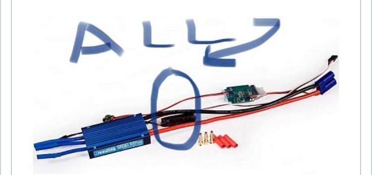

                                    Click image for larger version  Name:	011C2207-6181-4593-85A1-CC28BFAE12ED.jpeg Views:	1 Size:	49.4 KB ID:	282687 See photo / also placed one near the green ring near the receiver and recently added near tail servo.
                                    They are light and easy to install. Put on the ESC wires where ALL is marked...a total of 3 up front snd 2 in the rear...can run multiple wires thru one choke.
                                    Place the 2 larger ones on each side of the rear battery...plenty of room. One per ESC.
                                    Enter “ferrite”! in the search window for more details in other posts.
                                    Here is the link:
                                    https://www.amazon.com/Cedmon-Pieces...8870654&sr=8-4

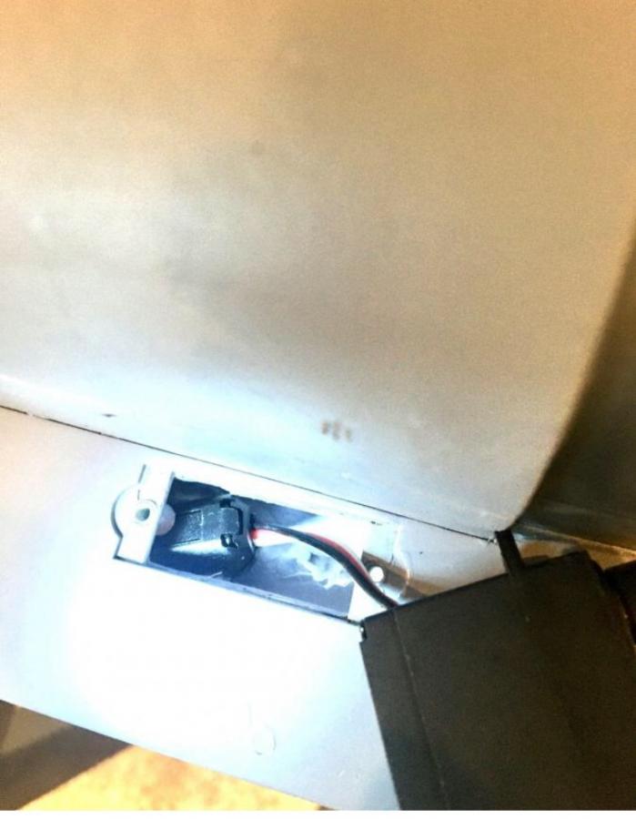

                                      Short update: The telemetry servos arrived today, unfortunately i found out that the actual firmware version of my Rx (jeti rex 12 assist) does not support servo telemetry yet. So - a new receiver is on the way now...
                                      Find attached some pics of my servo and cable installation (drilled 20AWG) and the added ferrite rings on the elevator and rudder cables. I will exchange the pushrods as well, just installed them for testing.

                                          That will provide very valuable information, thanks for the effort!
                                          I think since your servo is bigger it looks like the angle of attack of the pushrod also decreased which will help out but gotta have that in mind when translating the loads to a stock setup.
