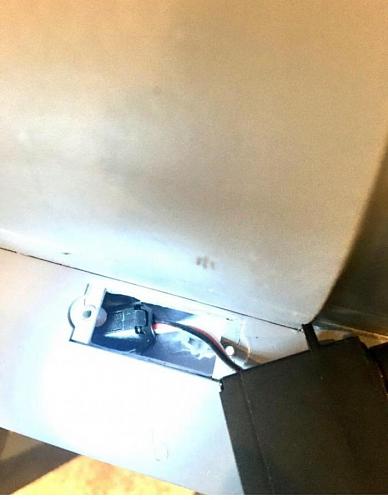

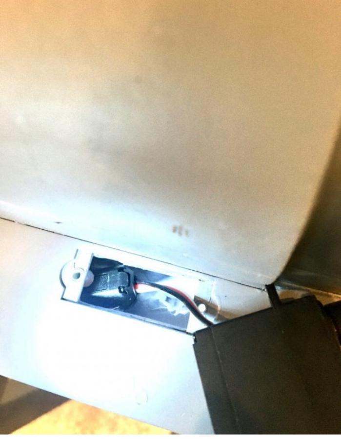

                                Anxiously waiting for the telemetry from Firebird’s Hacker servos....
                                If the signal noise is at the end, then adding chokes at the servos should attenuate it. There is plenty of room for the small barrel-type clip on chokes. I won’t know if these help because I wasn’t having issues. But, now....less likely to have issues, if noise at the end is the culprit.
                                The photo is looking down on the inverted bird...the servo is on the lower right after being pulled out. Next step was to tuck in the choke, remount the servo and position it for trim alignment so both servos match on the trim setting. They can move fore and aft a bit, so alignment had to be re-done.
                                All this can be done without disconnecting the push rod as I found out “after” doing this first one.
                                Hint: Leave a couple of cm space between the choke and servo....helps with the re-mounting process.
                                -GG
