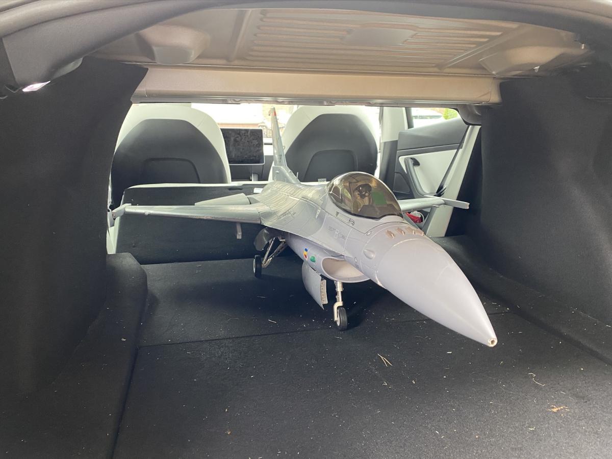

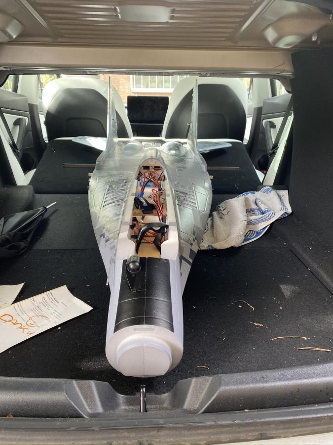

                            #2273
                            Originally posted by janmb
                            Yep, brilliant, right?
                            How is the Model 3 for model transport?
                            It's great for transport! It's much larger than it seems from the outside.
                            My Mig-29 easily fits:
Name:	Mig in Tesla.jpeg
                            And my Freewing 90mm F-16 even fits including the wings and with gear down:
Name:	F-16 in Tesla.jpeg

                              #2274
                              Nice! I thought the hatch opening (fixed rear window) might make life difficult, but if the mig fits like that, anything does :D
                              Been contemplating trading in the X for a 3, but this particular bit has held me from it. Hmmm

                                          #2280
                                          haha. It barely fits.
