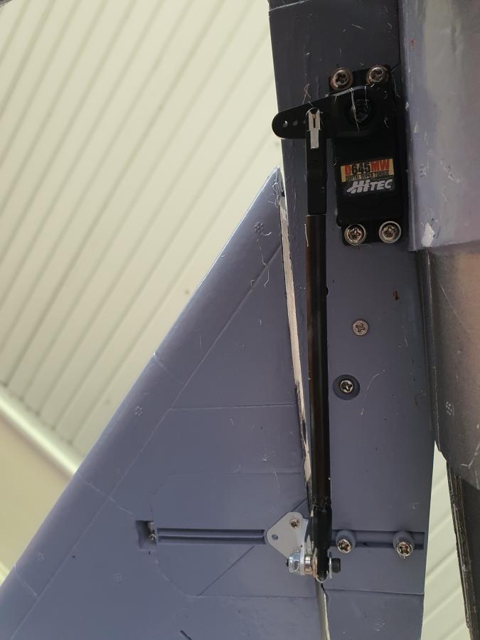

                So, I make no representations as to the adequacy of the servos supplied with the Mig, but in the interests of tinkering I carved out some room to fit a 57g 8kg Hi-Tec.
                I couldn't have imagined it would change the handling of the jet as much as it did. It will almost snap itself on the pitch axis lol. I had to dial down rates a fair bit, even with the same throws, to get a smooth flow back in the turns. It's incredible how responsive it is now, I need to relearn the plane.
