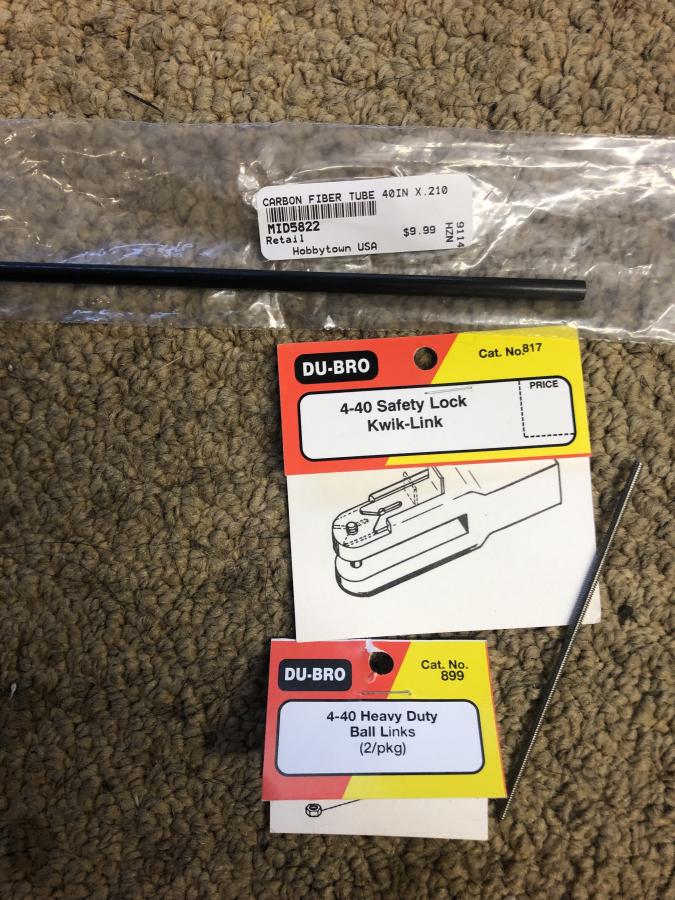

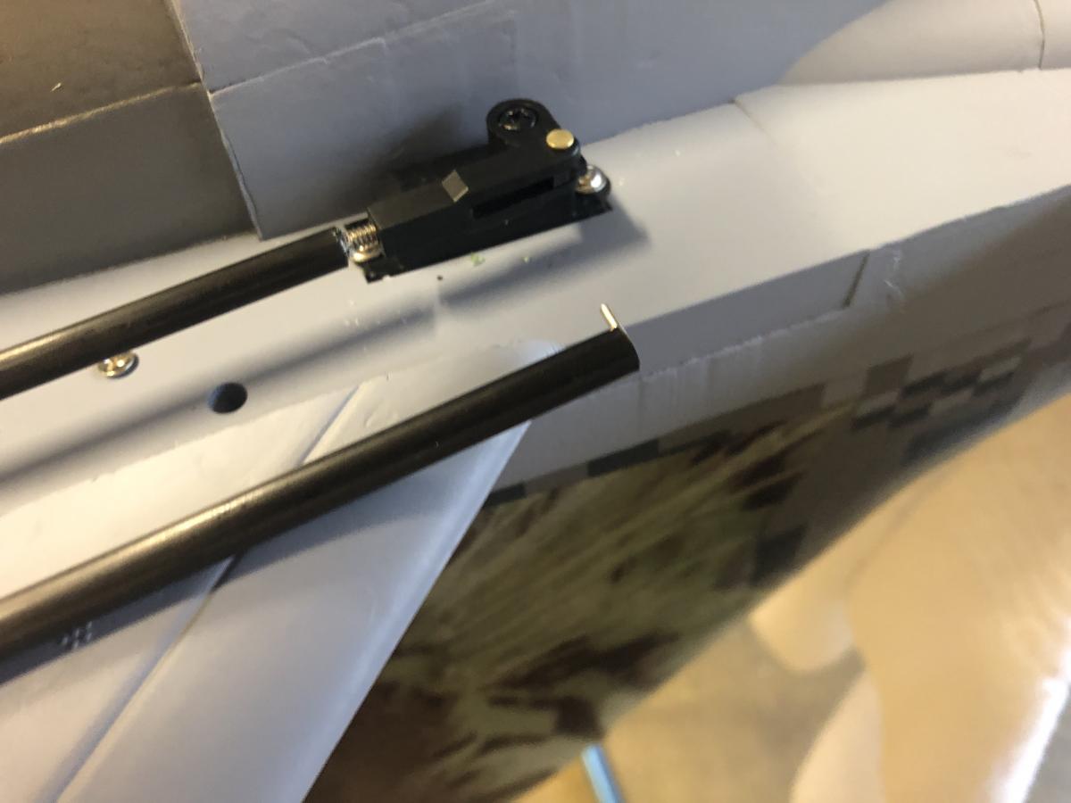

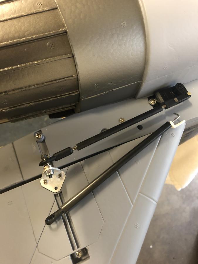

      Replaced mine with DuBro links, 4-40 all thread and smaller carbon rod than factory piece. Stabs had about 3/16” play originally. Upgrade reduced play by 75%.

          The carbon rod slides over 4-40 piece. I added a few drops of medium CA to secure carbon rod at both ends. The 4-40 rod removes the majority of play. The carbon is more for looks.

            Yes it does but mine had very noticeable flex when doing exactly what you suggested. Mine flies like a totally different plane after changing the linkages. Most of the flex shows up in the very end where the clip goes on the bent end.

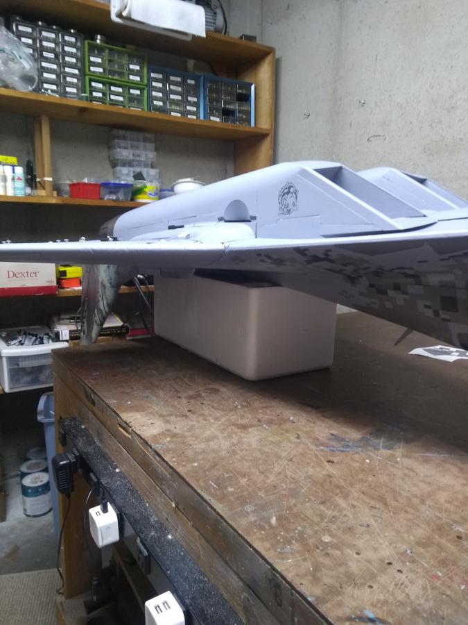

                  I made a stand for the MiG out of the styrofoam box it came in. I cut it down with a hot hacksaw blade so that the plane could sit on it’s flat surface. The stand was just wide enough to allow the main gear to come down and just short enough so the nose gear could come down unimpeded. The whole plane rested on the two belly bulges. It’s much more stable than that HobbyKing stand. Also, those styrofoam stands you buy at the hobby shop is not the right shape for the MiG to sit on.
                  It ain't purdy, but it works. Since I already paid for it when I bought the model, why not use it? Imagine the MiG pointed towards you in the picture, with it's "skids" resting near the edges of the box. Wheels can come down without touching the box or the ground (should you put it on a set up table or right on the ground). Did a similar thing with my AL-37 - even the correct shape for the big fuse. But if you need to spend extra money before you think it's worth it, then you don't want to do this. I have a standard foam Robart stand for all my other planes.

                    Inverted too Click image for larger version

                      Good video mshagg. I notice that a significant amount of the plastic servo arm flex is prevented by the Du-Bro safety lock quick link.
                      Some report a perceived softness pulling out of loops at the bottom. This overall flex might be the cause.
                      With the upgraded link+pushrod+stronger servos, I perceive a nice crisp loop recovery response.
                        I found no play at control horns with setup I used and the upgraded servos with supplied horns.

                          No doubt - The 4-40 rod + Du-Bro hardware with or without a carbon tube sleeve (for looks) is a worthwhile addition. I also have very little play (tiny) using the stock servo arm.

                            I did what Glider Guy did except I used rods that were threaded on one end and I soldered a threaded end onto the other side of the rod.
                            At first I was cursing GG, because I droped one of the clips for the quick clip clevis. Took about 20 minutes of crawling around the floor with a tac light to find it. After it was all installed the dubro quick clip clevis does keep the servo horn from flexing.
                            Overall the elevators go from having a ton of slop to feeling very rigid.
