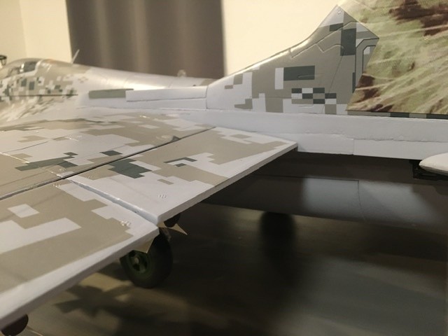

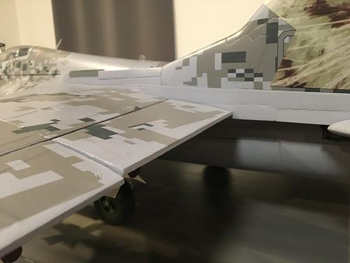

              Click image for larger version  Name:	31DC0FAC-5319-414F-B82F-96803317D19A.jpeg Views:	0 Size:	47.4 KB ID:	279050
              Originally posted by Reaper911
              "negative 1 mm flap when up". Where does the flap trailing edge end up in reference to the fuselage?
              Sorry - Missed seeing your question. See photo....may be 2mm vs 1 mm.
              Absolutely no pitch change with speed changes.
              Aileron is flush with the outer trailing edge of the wing. Others have adjusted the ailerons to match the flap. I may also. But it flies so nicely like it is.
              Note: It is a result of one flap push rod being slightly too long. Adjustment of the ball link was maxed out. I decided to leave it and made the other flap match. Full scale sailplanes use negative flap, so I wasn’t concerned. I didn’t want to mess with modifying the push rod. Visually, for display, I can always add a touch of transmitter vernier knob positive flap input.
