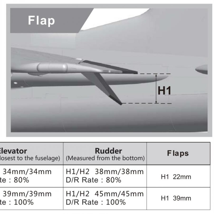

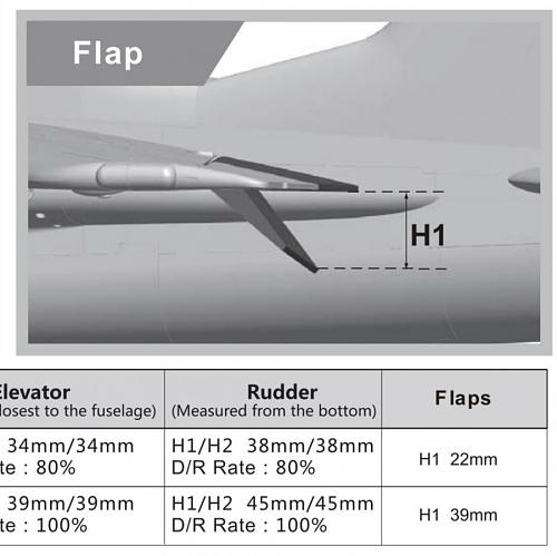

                                Falcondriver - Can you quantify take-off flaps? What are your flap travel/deflection measurements? I have seen some photos that show a lot of deflection. My bird....not so much so.
                                -GG
                                • Falcondriver
                                  • Sep 2020
                                  • 40
                                  #1776
                                  -GG
                                  22mm as per the manual.
                                  Click image for larger version  Name:	56FD28E4-1F32-46E0-9691-2FB6FBD89F49.jpeg Views:	0 Size:	63.1 KB ID:	278693
