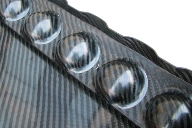

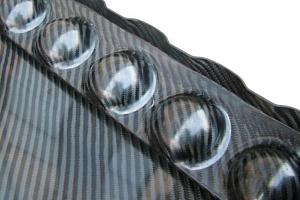

      Adding to my prior post and the thoughts presented here about a possible wing/elevator interaction due to being in the same airflow plane, here’s a thought....
      In full scale sailplanes, we use self-adhesive turbulator tape to control airflow on the wing and reduce drag...counter intuitive, but you can do the research. All super ships use this tape to reduce drag.
      Two types: Zig Zag and Dimple
      Why couldn’t we use it on the MiG to forestall any possible negative wing/elevator interaction...if it even exists? In full-scale sailplanes, placement of the tape typically is.... span wise, along the bottom of the wing about 6 inches ahead of the trailing edge ( need to scale this).
      Basically using the tape not what it was designed for (reduce drag), but as a easy to apply vortex generator.
      Might consider placing it parallel to the leading edge of the elevator along the full length of the elevator. Distance from the leading edge is TBD. Top? Bottom? Both? I haven’t a clue.
      This is readily available at sailplane parts stores such as Wings and Wheels. Search TURBULATOR TAPE.
      -GG
      An example of both types shown below. I couldn’t find a good image of the dimple type, but you get the idea.

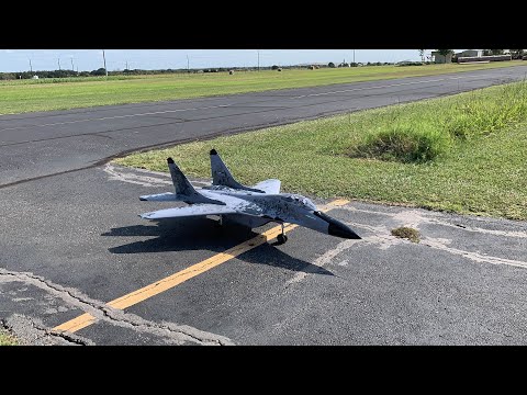

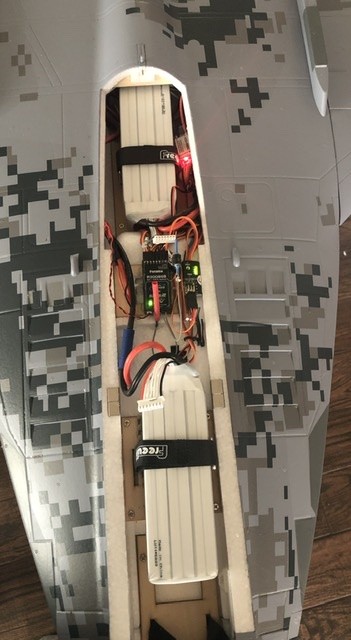

        Here is an uncut video of yesterday’s 12th flight and first time without armament. My set up.
        Tailerons mixed with small amount of ailerons
        Statically balances vertical stabs( @1oz of weight on each)
        RT5500 45c
        CC BEC Pro set at 5.6v
        Hitec servos on elevators (HS 5085)
        CG @ 15mm behind book CG ( I think could be moved back a few more mm) Elevator trim is about 1mm above bottom of fuse. Rx mounted in center bay
        BB moved to rear battery compartment.
                This may or may not work... first we would have to make sure that blanking is the problem at all. As I said, so far it's just a theory.
                Then, these tapes are designed for gliders that will be flying slightly faster than the MiG-29 so the effect may not be the exact same but if we indeed have a boundary layer problem, then yes, use of such a tape or other means of vortice generators could improve something. But the placement of vortex generators has to be very specific, usually in the 'still laminar' portion of the wing to induce the vortices right ahead of where the boundary layer would detach. We do not know where that is on the MiG-29 (or whether it is a problem at all).
                A way to find out (to some degree) would be to place short threads over one wing and use an action camera to film it while flying in different conditions... ideally in elevator blanking conditions which may be hard to replicate, and dangerous at that. :/
                Placing it on the elevator would make little sense IMO. You would want it on the wing's top OR bottom at a very precise chord length which, as I said, should be determined by some experimentation or trial and error.
                We'd be trying to prevent boundary layer separation on the WING, causing the elevator to live in a wake of turbulent, de-energized flow.
                In that condition, adding turbulator tape on the stabs themselves would pretty much do nothing.
                  Congrats, well done!
                  So far the most interesting flight video to surface yet!
                  And just as forseen, the jet seems to fly much better with a more balanced CG.
                  There definitely didn't seem to be much of a problem with 'falling leaf' scenarios, at least with this more-rearwards CG setting and proper handling.
                  Keep it up! :D

                    TURBULATOR TAPE (counter intuitive)
                    More info on this stuff to add to my prior post. This stuff impacts the drag at ALL speeds. Most high performance sailplanes achieve their max L/D (best glide ratio) at around 55 to 60 mph. Much slower than the MiG is flying. Glide rations of 75:1 have been achieved (75 miles forward for every mile lost in still air). High speeds L/D at 100+ mph are still north of 35:1. We also carry several hundred pounds of water in the wings to increase the achieved L/D at high speeds (also counter intuitive). Heavier gliders go better.
                    Genius aeronautical engineers at sailplane factories figured out that the air molecules don't want to let go of the trailing edge of the wing/tail. So turbulator tape is place about 6 inches ahead of the trailing edge (typically on the bottom surface of the wing running parallel to the trailing edge) to generate turbulence that causes the air molecules to more easily "let go" of the trailing edge. It's purpose is not to generate any effect on the boundary layer ahead of the turbulator tape. It generates turbulence downwind of itself to help break up the boundary layer so the air molecules will detach from the trailing edge more easily and decrease drag.
                    Thinking about the function of the turbulator tape, I came to an "assumption" (correct or not) that maybe it could solve the MiG issue (if indeed there is an aerodynamic issue at all). I wanted to post the information in case it might just work. Who knows? It sure is an easy experiment. It might just possibly have a good effect on the MiG.
                    -GG

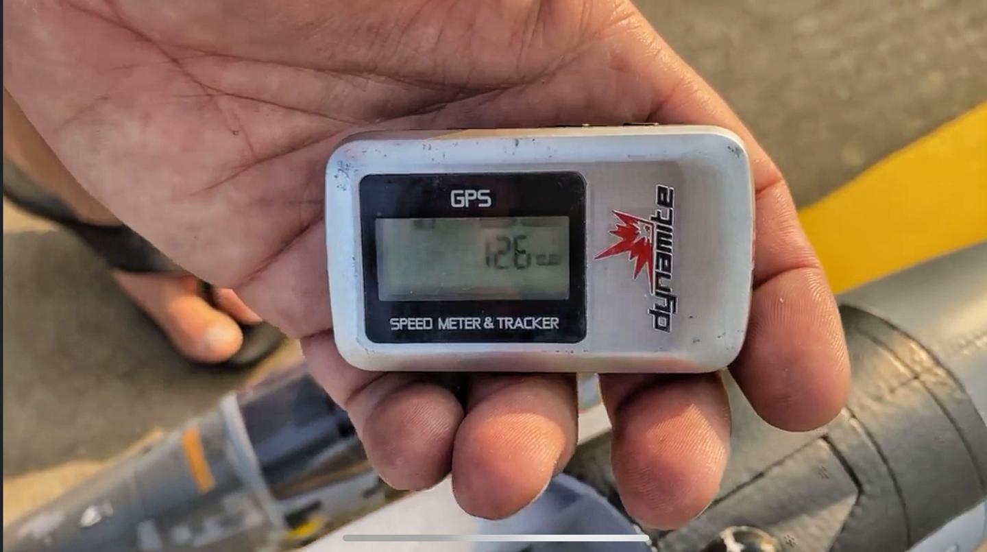

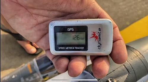

                            S25....126 mph is VERY respectable in my books. Is that adjusted for natural wind effects? Missiles on or off? Thanks.
                            -GG

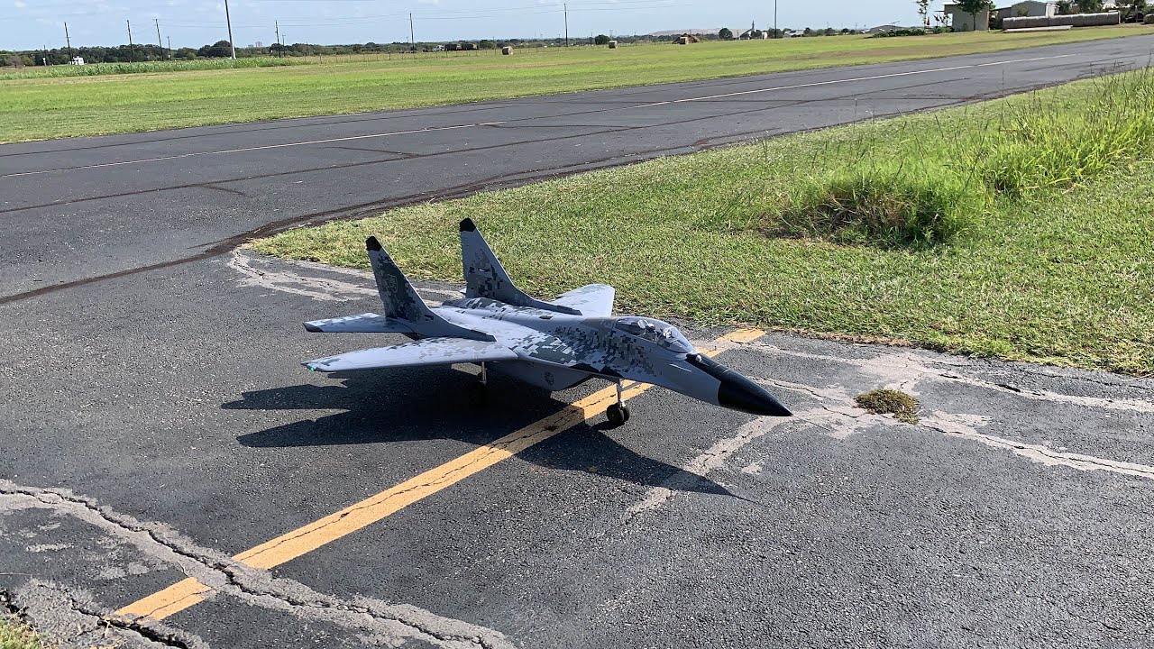

                            Clean jet (no weapons/pylons) 5500mah, 70C Roaring Tops, CG on the CG marks. Calm winds.
                            I did the flight LIVE on FB, otherwise people jump in with all kinds of speculation. (Especially people who haven’t flown it)
                            Video intentionally shows battery placement, and the windsock being dead calm. Temperature was 82° and the density altitude was over 7,000ft.
                            They were also my oldest pair of Roaring Tops. Still faster than the latest top Spektrum 4000-5000, HRBs, Admiral HDs, CNHL 70C, Pulse, Zeee, etc. I have 52 6S lipos, my Mig-29 now has almost 100 flights, the Roaring Tops even after 100s of cycles are still the best. I’ve literally tried everything that is out there and commercially available. Every battery besides the Roaring Tops was a minimum 5-6mph slower, no joke. I don’t work for Roaring Top or any other vendor, and I pay for my batteries.
                            That said, I said multiple times during the flight that we were trying to achieve maximum AIRFRAME speed. NOT level course or timed speed. That it was GPS over the ground max speed.
                            I turned around pretty high after the first two speed passes from mostly level. Because it was around 300ft up, I left it at idle after pulling over the top until I started pulling to level off over the runway, then punched it. Because she is so big, she doesn’t look as fast as she’s actually moving.
                            The T-33 and L-39 are both faster with the inrunners.
                            Look forward to seeing everyone else’s speed mods on it.

                                        Thanks for the positive comments on my last video!!!
                                        The loss of elevator response during a dive issue is quite interesting, not sure if CG (fwd/aft) has anything to do with it. The only flight video I've seen that I can, with all certainty, say that it was an extremely nose heavy CG was Pilot Ryans maiden flight, I even think he still had the stock servos. No issues from what I could tell, he did do a few dives and if CG had something to do with it, that flight would have showed some evidence related to CG.
                                        Going back to my flight, on maiden flights, after trim, pitch and roll, and CG check, I always, always check stall charactersitics regardless of plane type. The MiG behaved quite differently and recovery was even more interesting. Once I reached about 3-4 mistakes high, I slowed the MiG, reducing throttle and adding elevator, as the AOA increased, lets say past 50 degrees, there was no elevator response, the only way the nose would move was by throttle, the more throttle I added the nose kept going up, adding down elevator did noting. I maxed the throttle and the plane "flipped" and once the nose pointed down and speed increased, I regained elevator control. I did the same maneuver a few more times and it reacted the same way.
                                        If during the "flip" you keep adding up elevator and reduce throttle, the MiG will enter another stall and the dreaded falling leave, at this point there are two viable options, elevator to neutral and zero throttle and allow the plane to drop the nose on its own. Once the nose drops, add a little throttle to increase speed and gently add elevator. The second option that I like is to reduce elevator input but max throttle, the nose will go up and it will "flip" again and once the nose points down add throttle/elevator and fly away. I think the safest way, with less altitude loss, is zero throttle/neutral elevator. One thing to keep in mind is that my MiG is set up with tailerons and ailerons so I do have more roll control than standard configuration.
                                        If you watch the video of the F22, it sort does the same inputs, also note how it uses up flaps to help get out of it. Maybe a mix to explore

                                          I got in two flights on the new mig 29 this weekend. Using HRB 5000’s and a 1 1/2 ounce of nose weight. Both flights went very well although I will remove a half an ounce of weight for the next flight. I did not notice any negative tendencies but I have not really rung it out hard yet.
                                          I do like the size and large wheels. Very happy with it.
