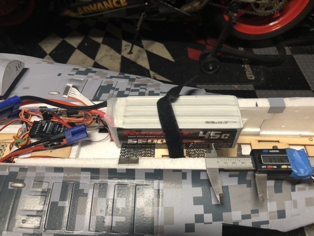

              Originally posted by Lcacing
              Here is an uncut video of yesterday’s 12th flight and first time without armament. My set up.
              Tailerons mixed with small amount of ailerons
              Statically balances vertical stabs( @1oz of weight on each)
              RT5500 45c
              CC BEC Pro set at 5.6v
              Hitec servos on elevators (HS 5085)
              CG @ 15mm behind book CG ( I think could be moved back a few more mm) Elevator trim is about 1mm above bottom of fuse. Rx mounted in center bay
              BB moved to rear battery compartment.
              That's crazy your batteries are about the exact same place mine are yet your elevator is 1-2mm above the fuse edge and I am 3-4mm below. makes no sense. I'm running TP at 800g each and Admiral at 840g each.

                #1807
                The RT 5500 45c only weigh 770grams plus I have 2oz of extra weight in the horizontal stabs. That’s why the CG is further back than yours. The further the CG is pushed back, the less up trim required.

                  #1808
                  The battery sets about 37mm forward of the tray. When I use heavier batteries @800grams I push the battery back a bit more. Also I didn’t find the need to move batteries to adjust CG when flying with/without armament.
