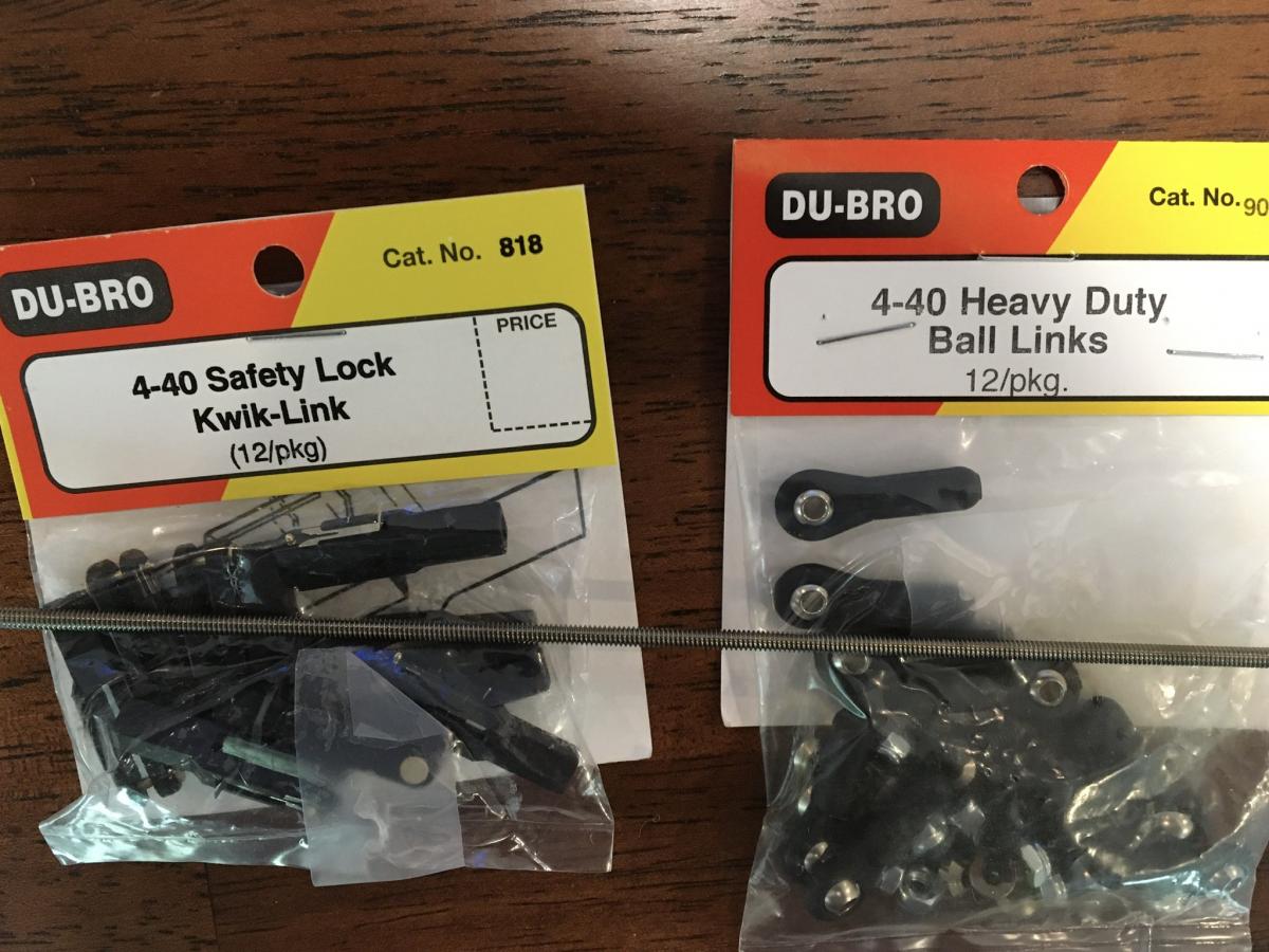

  • Originally posted by john2kx View Post

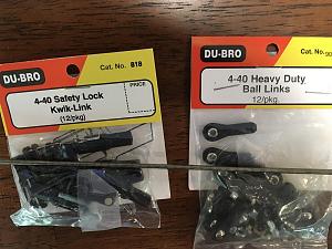

    Replaced mine with DuBro links, 4-40 all thread and smaller carbon rod than factory piece. Stabs had about 3/16” play originally. Upgrade reduced play by 75%.
    did you have to drill out the horn for the 4-40 bolt?
    • Originally posted by Reaper911 View Post
      Yes....a very small amount of elevator horn drilling is required to accommodate the Du-Bro ball link bolt. The 4-40 all thread rod is stiff. If folks use carbon or other tubing to cover it, it would mainly be for looks. This short piece of 4-40 all thread rod has almost zero flex. The Du-Bro safety lock quick link prevents the servo arm from flexing/bending.
      You end up with a push rod that provides confidence! Click image for larger version
      -GG

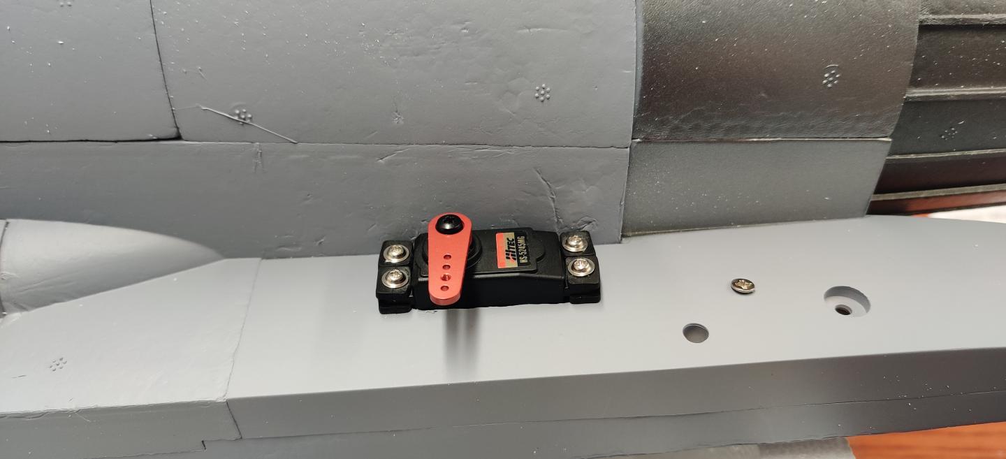

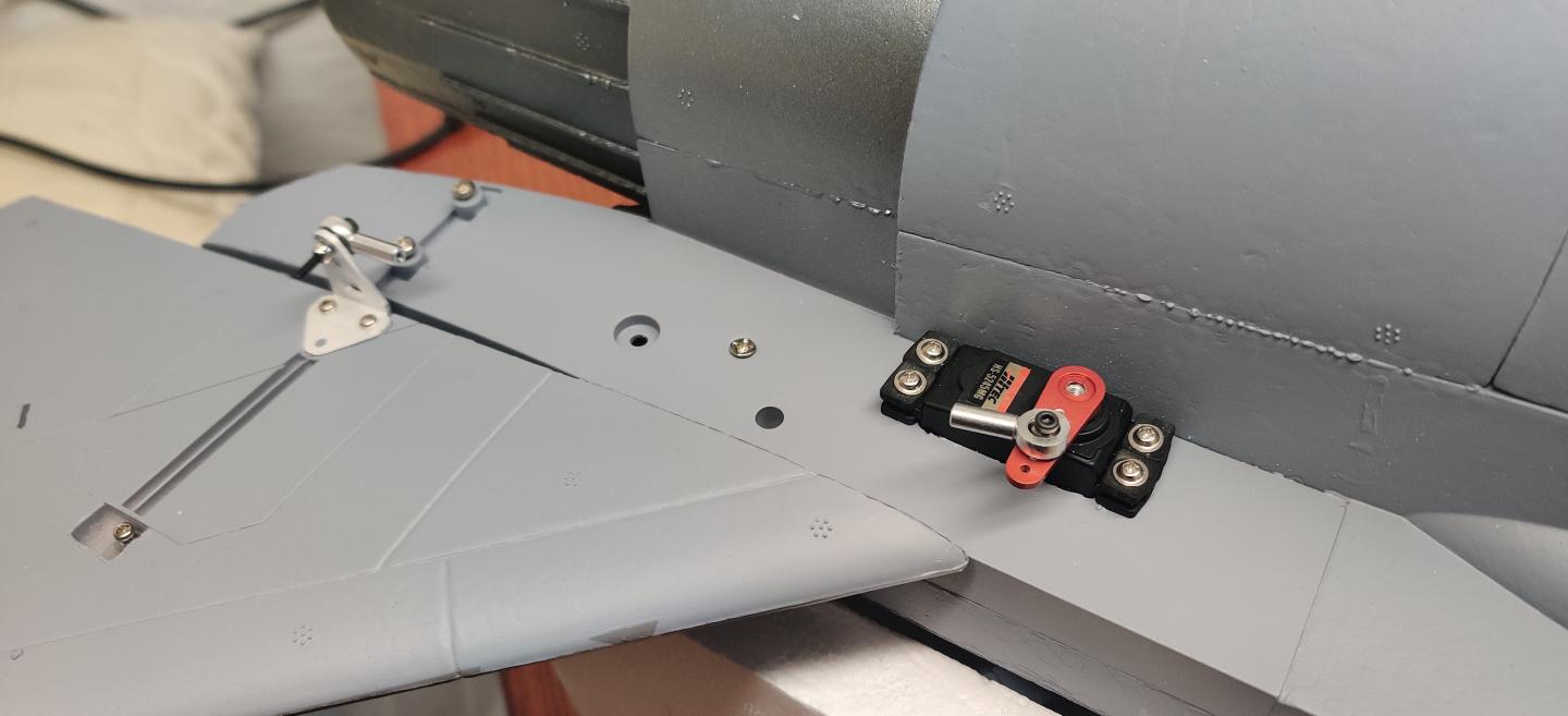

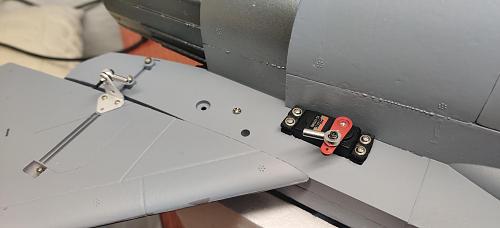

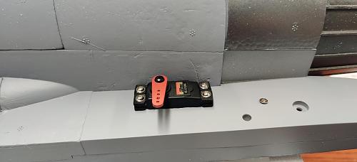

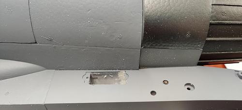

            • The stock elevator push rods are indeed way too thin and soft for a model this size, with huge taileron surfaces. As others have demonstrated, the flex a lot under pressure, and imo, the fibreglass tube is just for show - it does nothing to prevent the thin rod from bending.
              For my part, upgrading to mini servos, metal horns, metal ball links and fatter push rod. Not done yet, but should be tight as it gets Click image for larger version

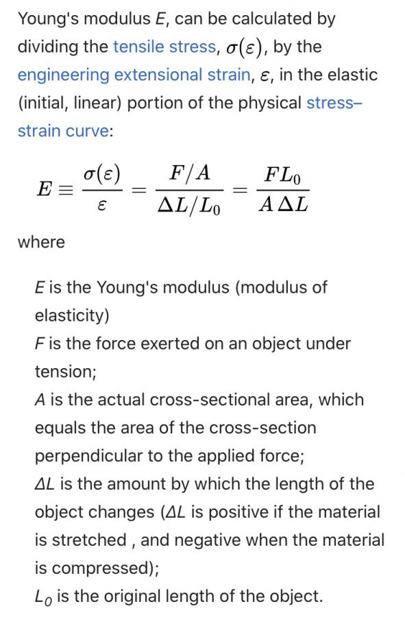

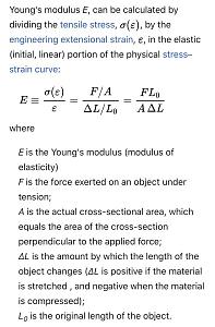

              • My statement was “mainly”. That isn’t an absolute. Mainly and “nothing” are different. Referencing the formula below or other similar formulas which might apply, of course I agree that decreasing the length or increasing the stiffness and/or increasing the cross sectional area will have an impact on linear elastic deformation or the amount of deformation resulting from a load applied to a rod supported at either end.
                Short fat rods ain’t gonna bend much. Short fat rods made outa stiff materials ain’t gonna bend much. Short skinny rods made outa stiffer material ain’t gonna bend much.
                My opinion...beefing up the elevator push rods for large/fast birds with large-area surfaces is a cheap/easy way to be confident in your flights.
                -GG

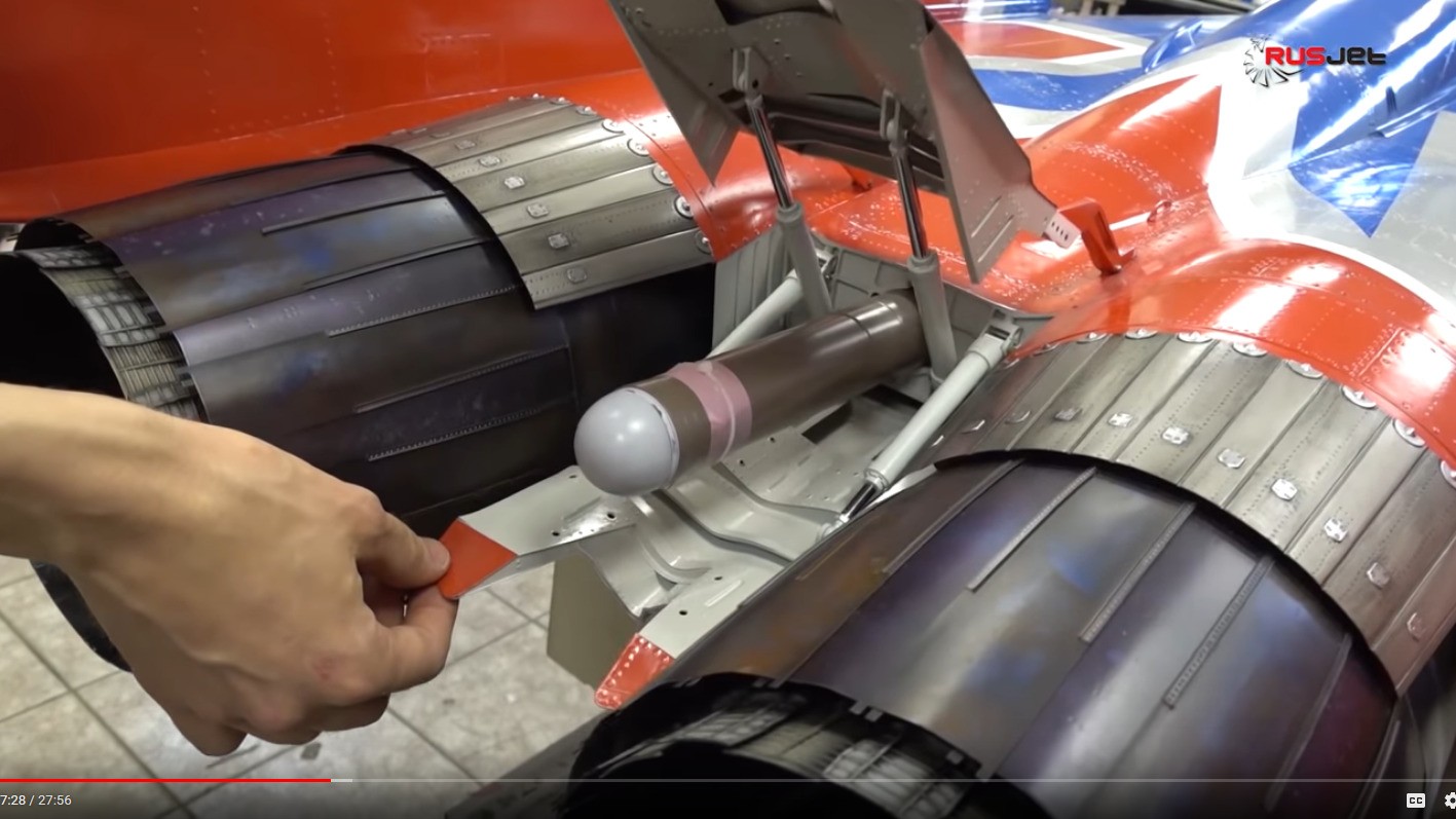

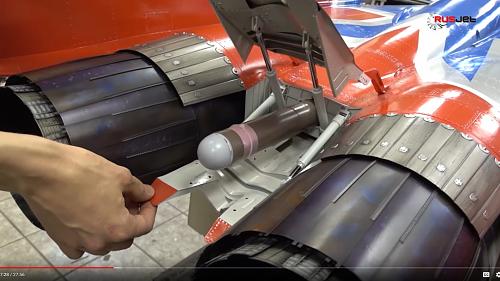

                          • Click image for larger version  Name:	Screenshot_2020-09-02 MiG-29 WalkAround.jpg Views:	0 Size:	188.5 KB ID:	279911
                            Hi Alpha,
                            Are there anymore upgrades coming , AKA "Speed Brakes"?

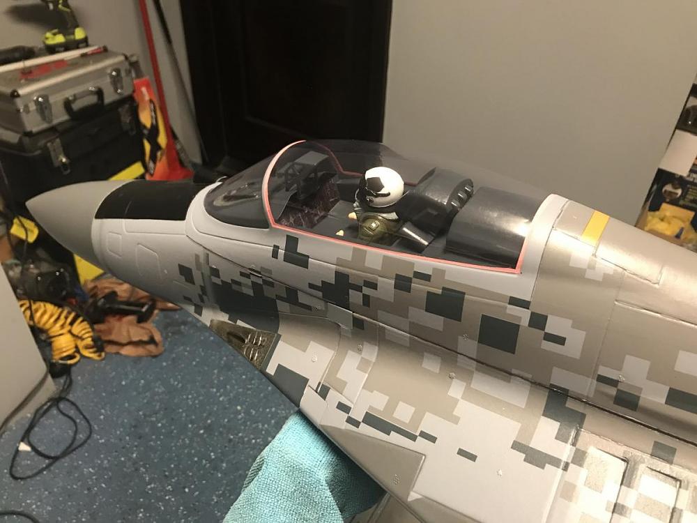

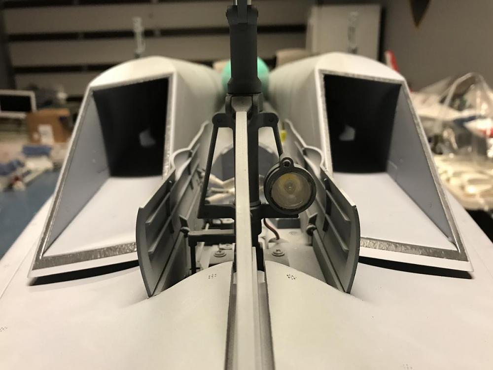

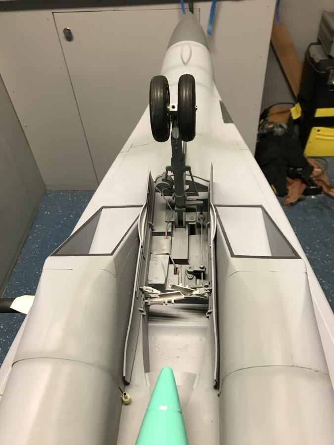

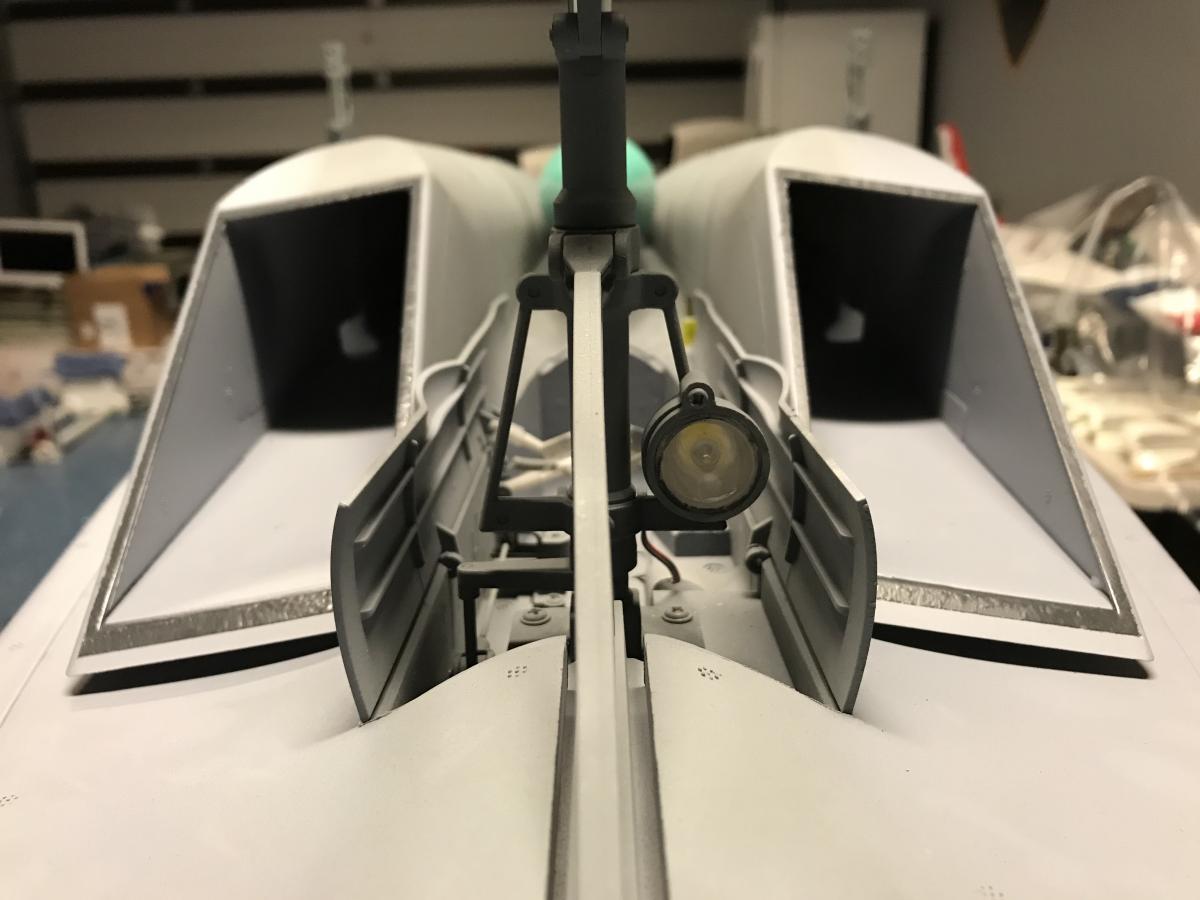

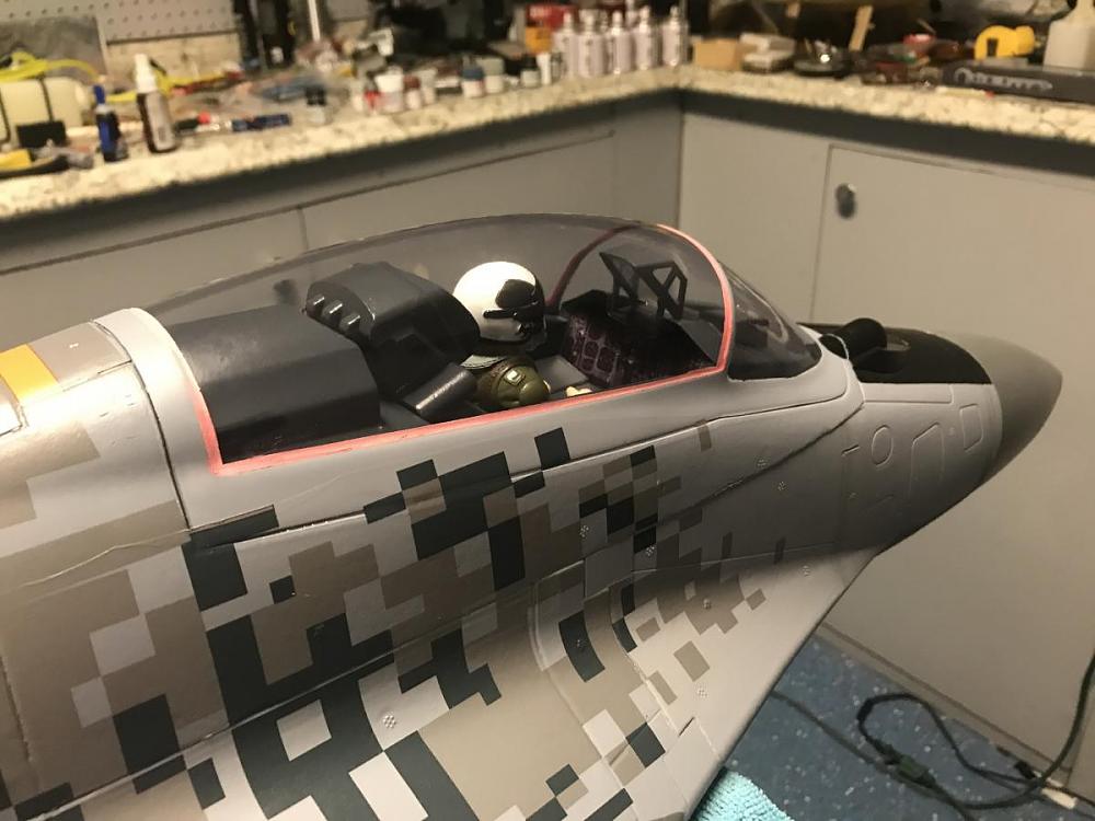

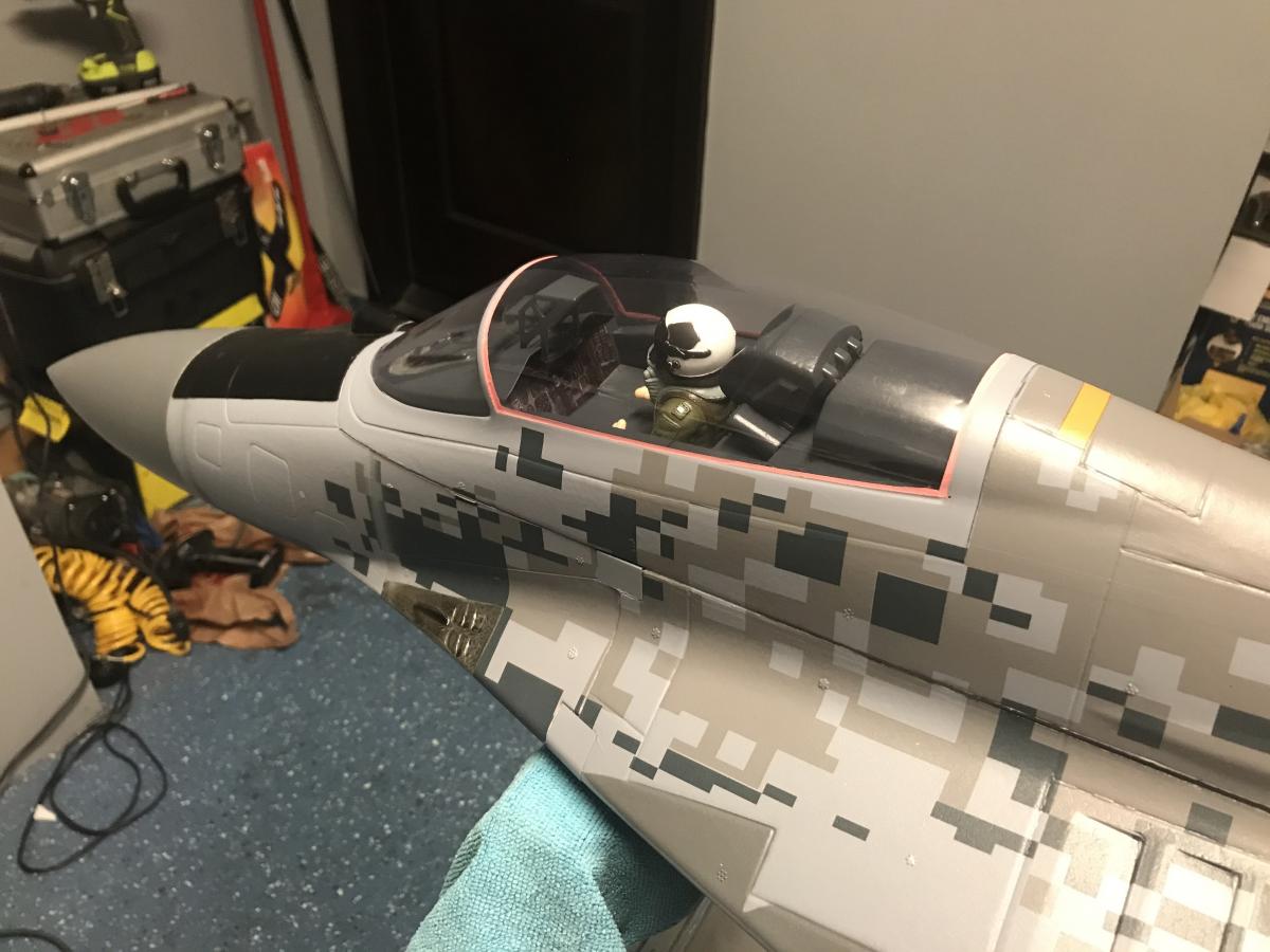

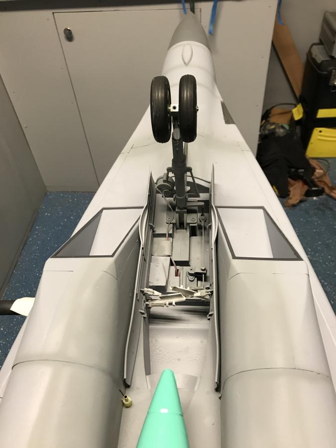

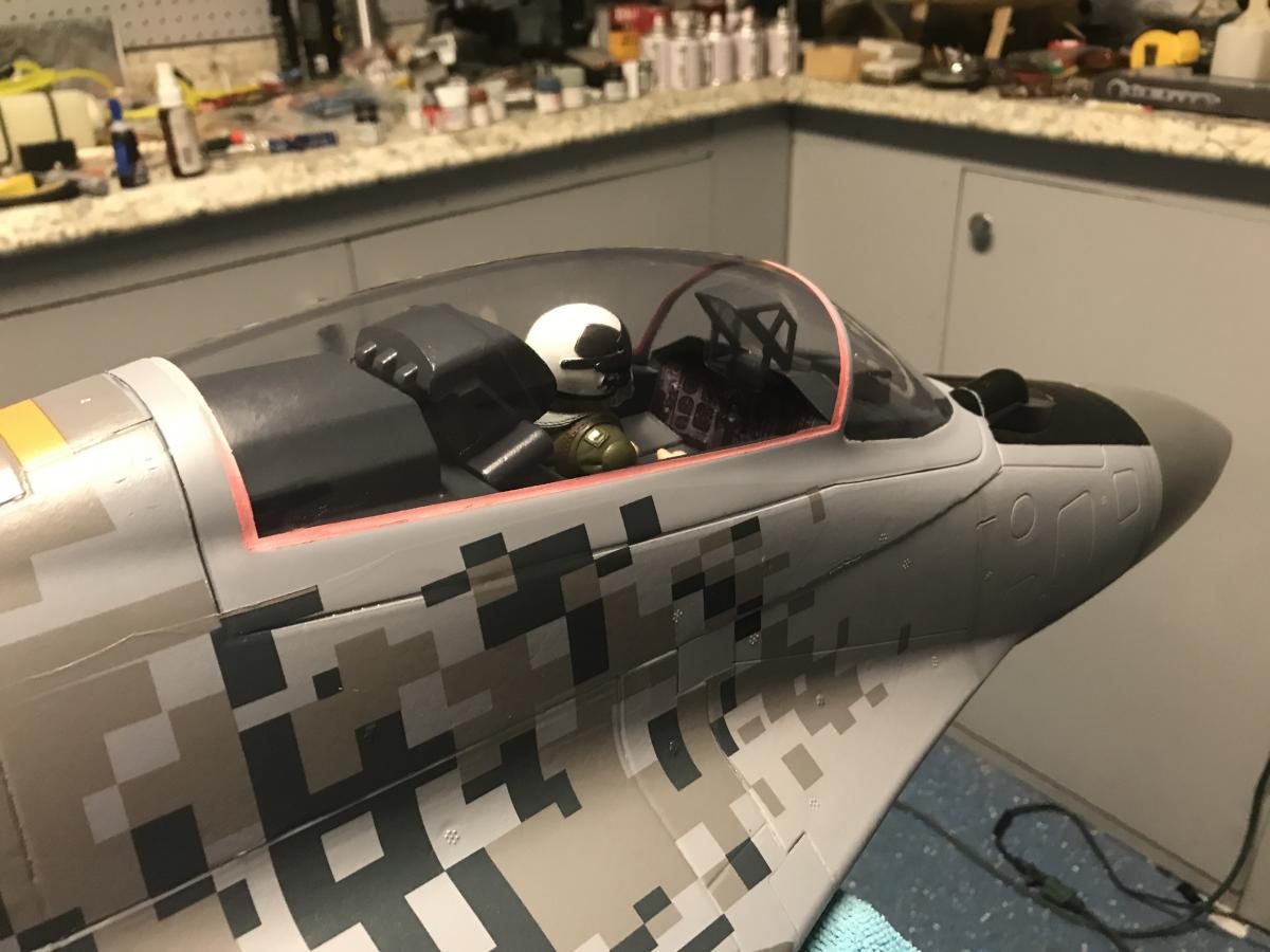

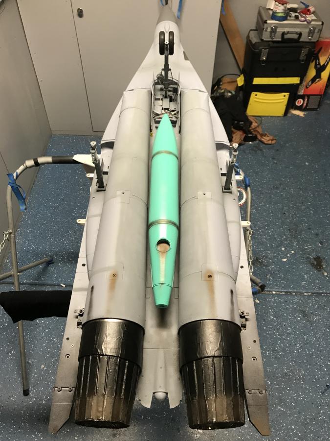

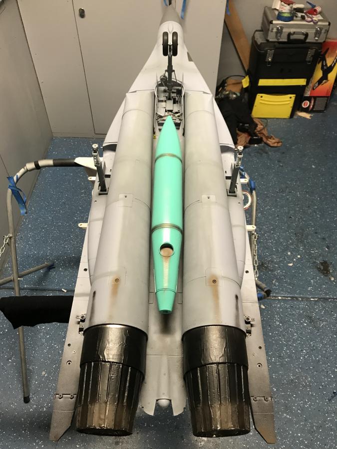

                                • More scale touches on my Mig turbine conversion
                                  Cheater holes gone
                                  intake colored
                                  canon panel area installed
                                  both fuel tanks installed
                                  centerline tank and external hard point installed
                                  Landing gear painted correctly
                                  Cockpit window liner complete
                                  Completely weathered
                                  ....more to come
                                  Click image for larger version  Name:	IMG_9015.jpg Views:	0 Size:	96.5 KB ID:	279918Click image for larger version  Name:	IMG_9017.jpg Views:	0 Size:	104.1 KB ID:	279919Click image for larger version  Name:	IMG_9395.jpg Views:	0 Size:	79.6 KB ID:	279920Click image for larger version  Name:	IMG_9396.jpg Views:	0 Size:	54.9 KB ID:	279921Click image for larger version  Name:	IMG_9397.jpg Views:	0 Size:	93.3 KB ID:	279922Click image for larger version  Name:	IMG_8978.jpg Views:	0 Size:	124.3 KB ID:	279923
