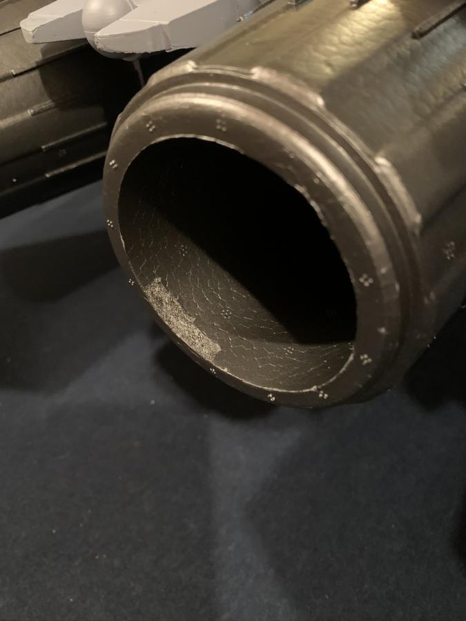

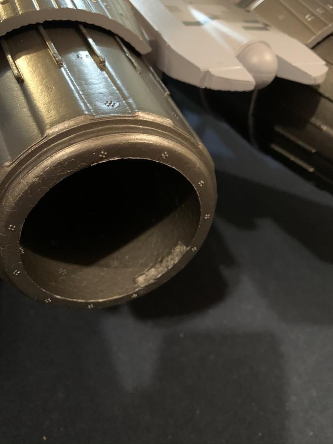

                      Just wondering if anyone else had the same issues. You can see from one of the photos the alignment issue and the other 2 photos the finish is goofed up in almost the same spot like it is from the mold or process being used to make the part or something. I know it is cosmetic but when you pay $600+ for this you'd hope things like this wouldn't exist.

                          This is how they do it on all their planes, both FreeWing and FlightLine. It's okay to leave it as is....
                          The exhausts are mold marks. If you get picky you can sand them down along with the injection dots all over the surface and repaint the plane. I have a feeling you won't...
                            I see some new people on here, welcome!
                            Evan,
                            Thanks for verifying that. I figured it was probably from the mold process but I wanted to be sure. The injection dots all over, yes I am aware of and I do not bother with any of this. I may or may not cover the exhaust marks I am not sure.

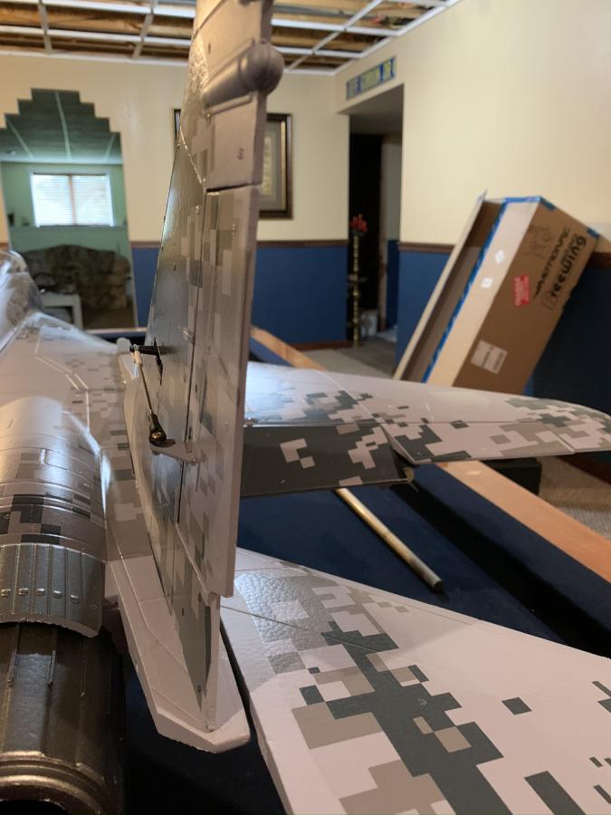

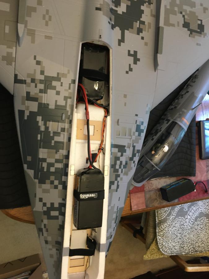

ID:	274064Click image for larger version
ID:	274063Click image for larger version
ID:	274062Click image for larger version

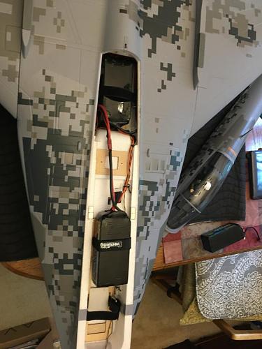

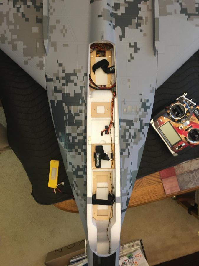

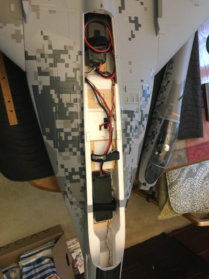

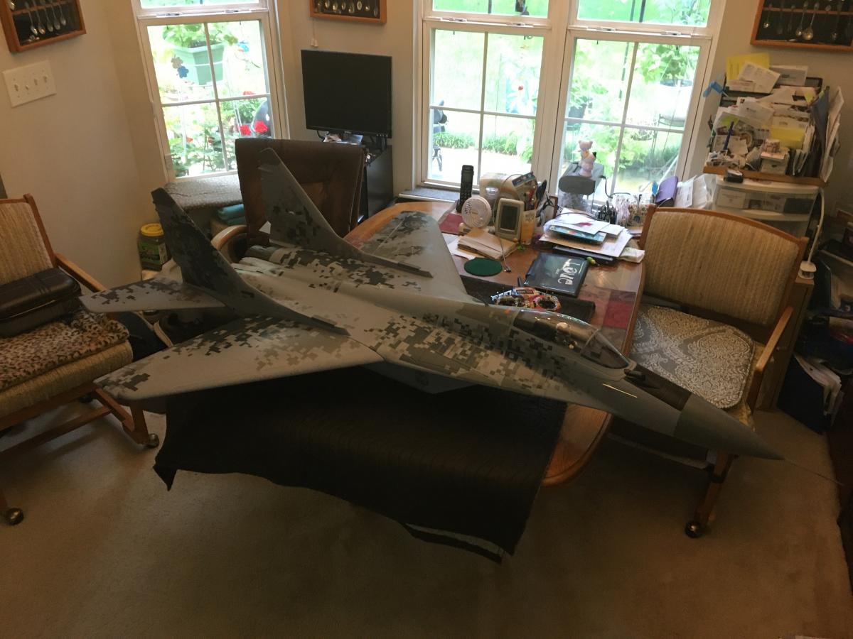

ID:	274061 Here is where my batteries go to balance on the molded marks with gear down. Smaller batteries are 620-640g 5200. Larger are 760g 58-6200. Also a pic without the batteries and just sitting on the table.
                                    I just watch Ryans maiden. If you watched it he has 5500 RT's. By the RT site there are two versions, a 70C the weighs 825g and a 45C that weighs 800g. He said his was balanced nose heavy on the marks and it had to be very nose heavy even with the light 800g packs where he has them. Look at my first picture. They are in the same spot as his and mine, in the picture are 630 and 640g, 330g lighter! The rear battery really isn't a big effect on balance but that front one is very critical so at least 150g or so off. He had to be quite nose heavy. I am surprised he only needed 8 clicks on up trim.
                                    He also had his high rates lower than the book rates, he said that he used the book 80% low as his highs.
                                    Good info.

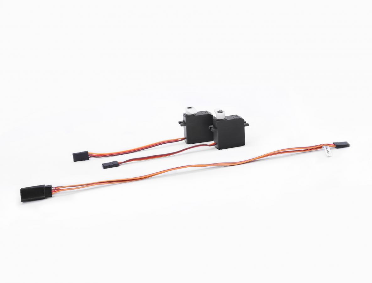

                                      2) Here is a photo of the Upgrade Set the MiG will be receiving. Notice that the servo wires are short, exactly like the MiG-29's stock servo, because the wire extension is in the fuselage. This makes it even easier for you to install the servo because you're not having to fish out the wire from inside the fuselage... I can swap a servo in less than 30 seconds that boosts the torque by 30% to give plenty of additional headroom.
                                      Piece of cake for peace of mind.

                                          If you’re going to slow flight the jet, your probably better off with the CG a bit further forward until you’re comfortable with how the jet enters and recovers from it.
                                          I too noticed as you, and primarily fly 5500mah RT 70Cs
