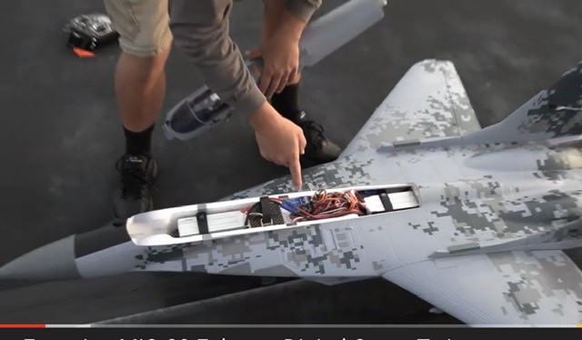

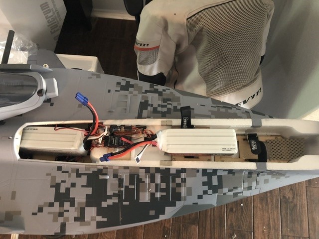

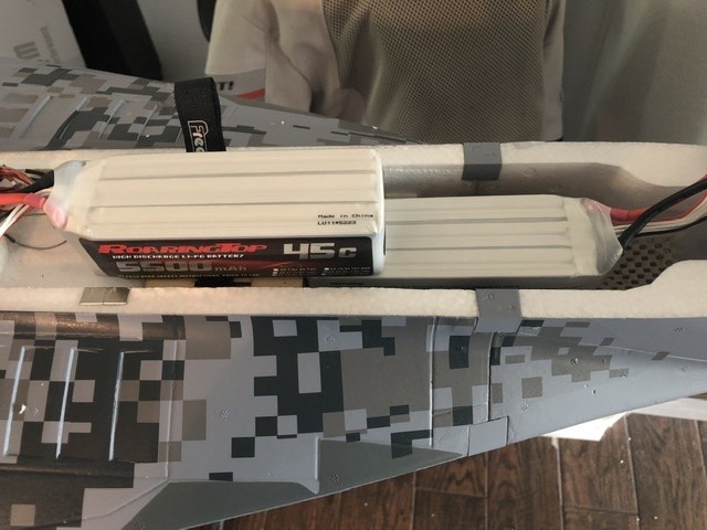

      Today I tried to balance the MiG, I remember seeing Pilot Ryan’s flight so I decided to install the RT 5500 at the same spot as his, he did mentioned that it was a bit nose heavy.
      Nose heavy was an understatement.
      Took a screen shoot of his battery placement and a picture of where mine ended up at. Mine does have the missiles and a bit of extra weight in the tail due to balancing the stabs.
      The last picture shows just how much of a difference in battery placement of the forward battery. Still waiting for the new servos before maiden.

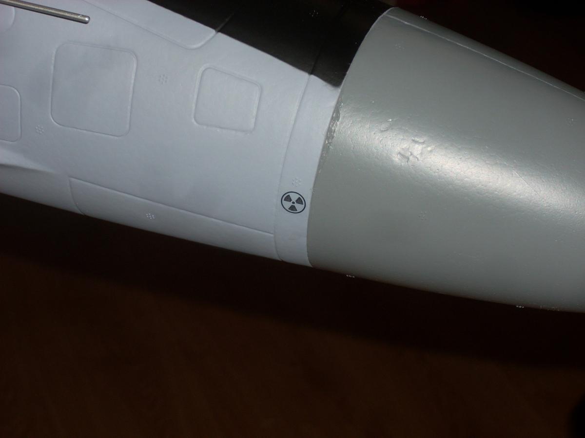

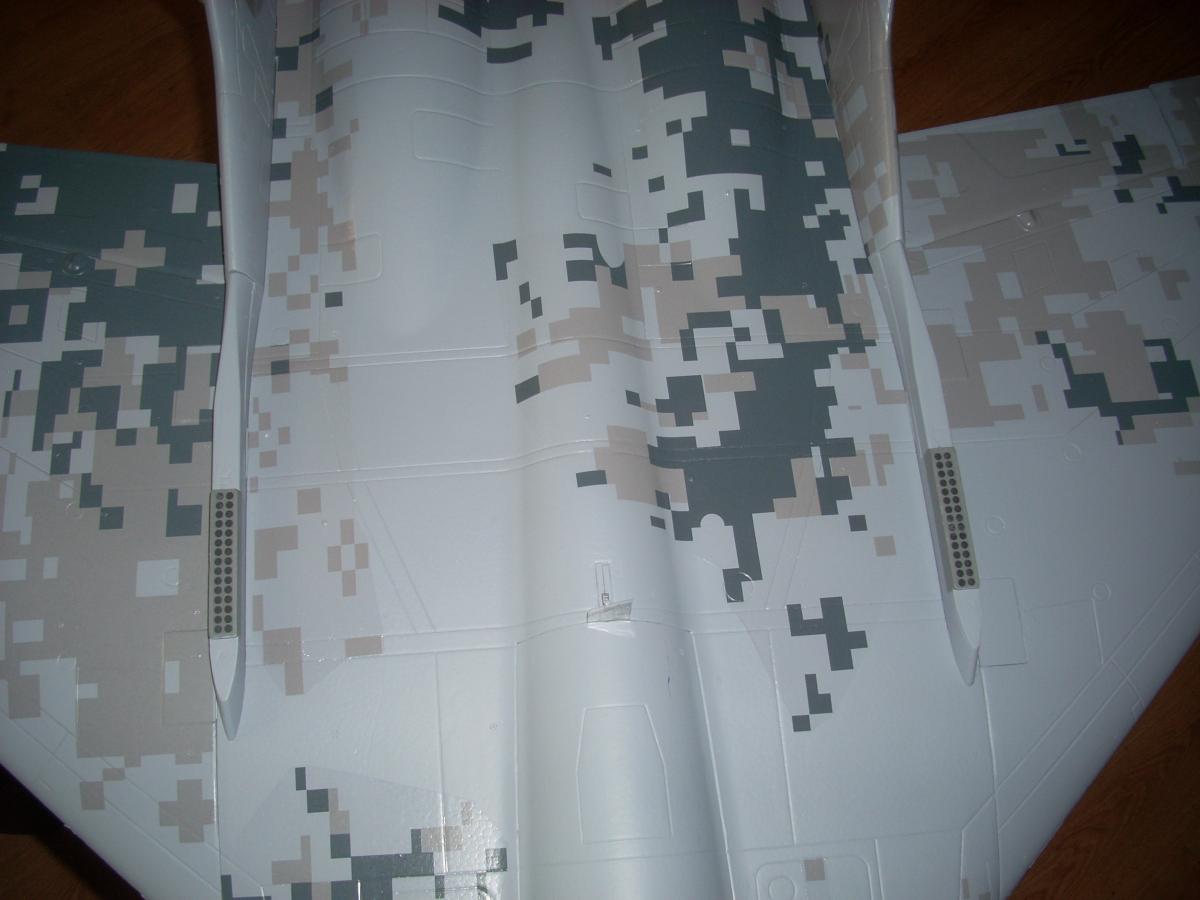

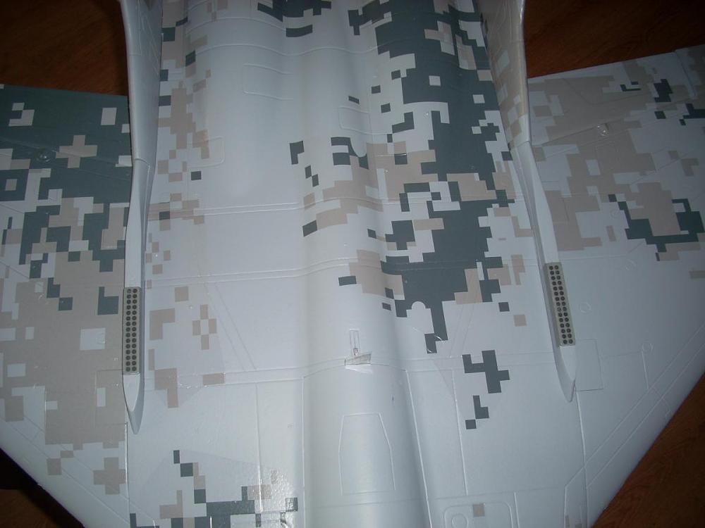

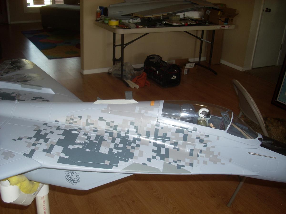

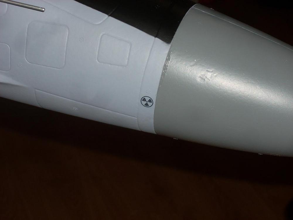

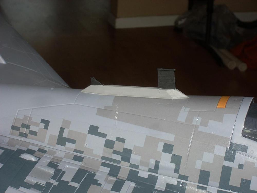

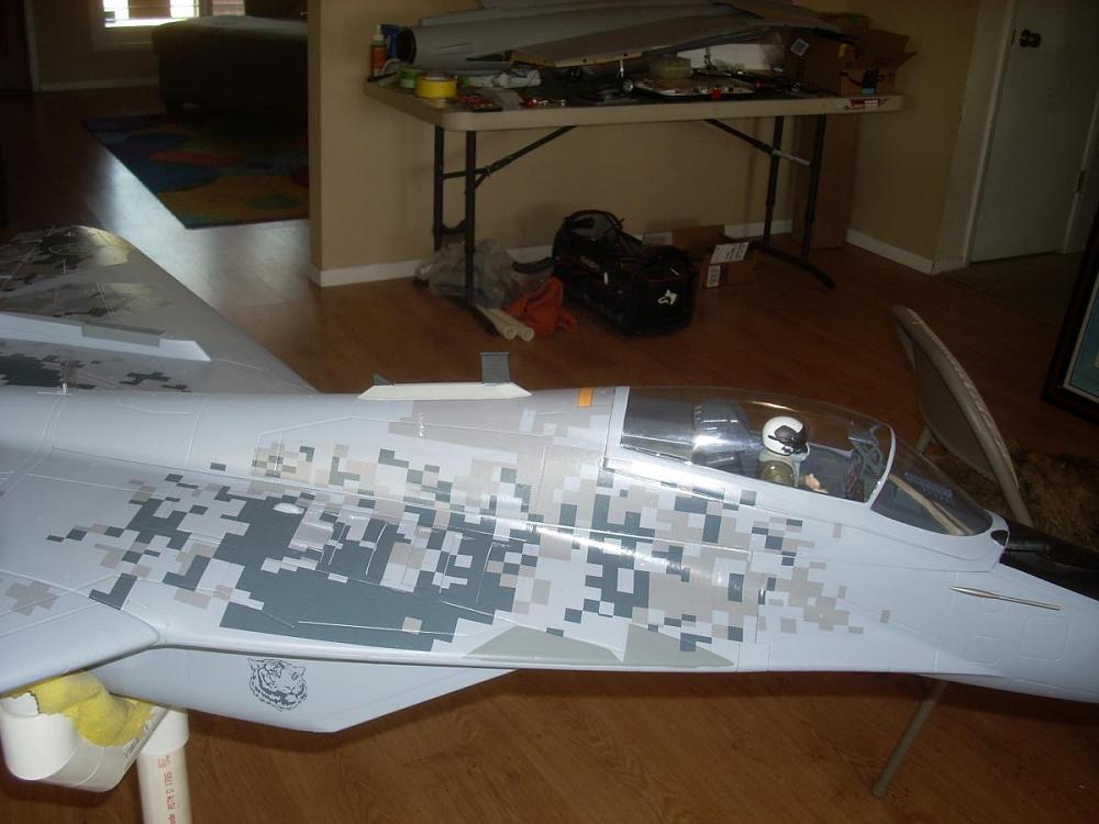

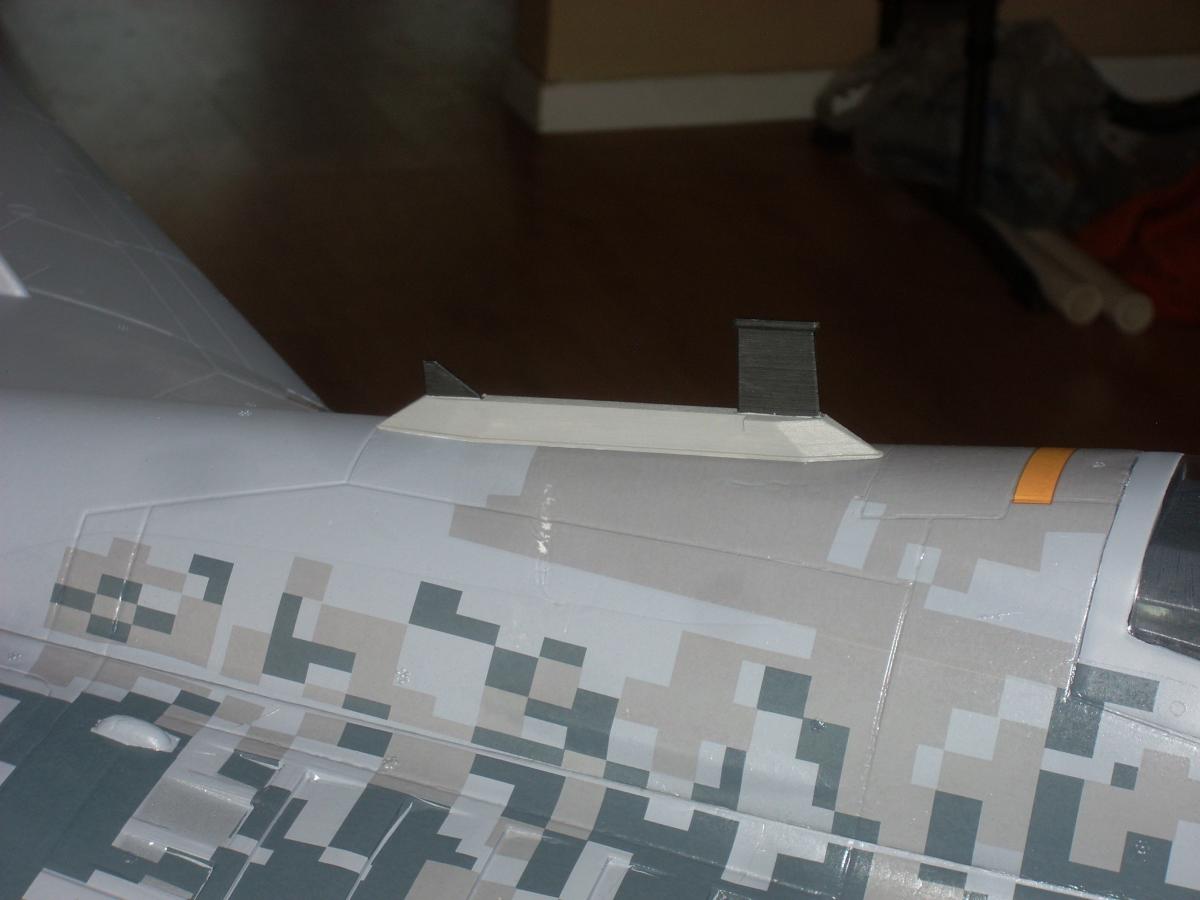

            A few scale details I've added so far. The antenna array looks good. I just need to repaint the gray as what I used was too light. Added radiation symbols behind the nose cone, and flare canister openings on the top of the dispensers. I will include both of these in my decal sets for the missiles.

              crxmanpat, Great work, Sir. Don't ya just love it?! Best, LB

                Put me down for a full decal set please! I love the radiation symbol and flare dispenser decals, those are nice touches! When you're ready just send me the order details.
                Next step... I need to get down to Home Depot and get color-matched paint! My local store has been sold out of many of those little Behr paint jars, I think I am at least partially responsible...

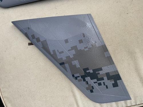

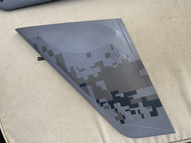

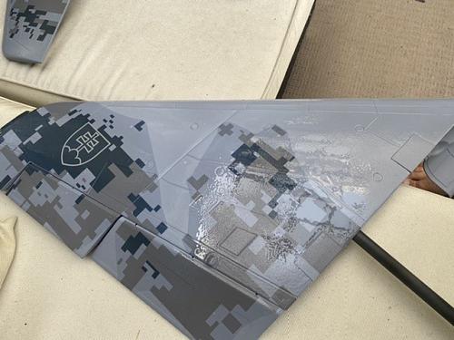

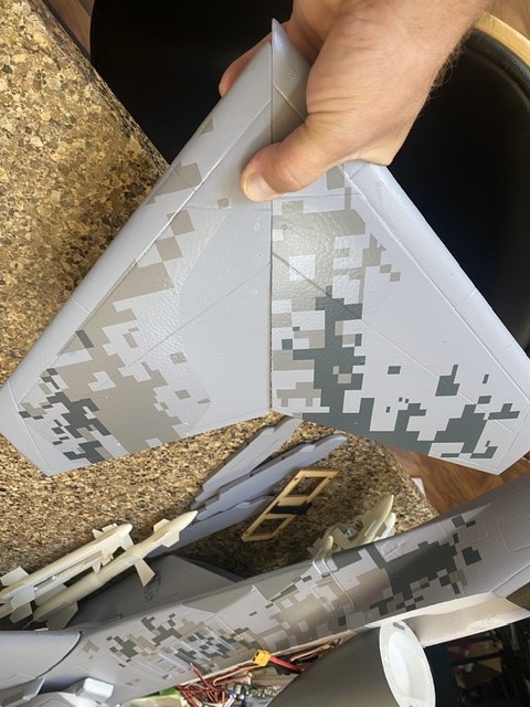

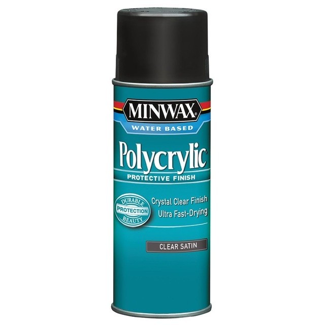

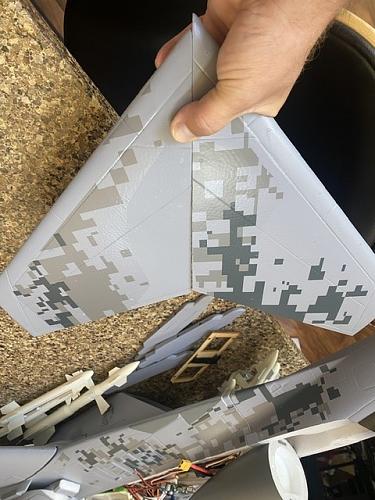

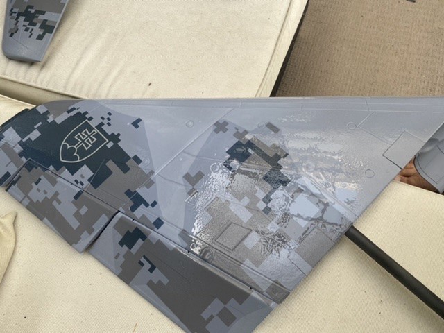

                            So i decided to try clear coating with satin polycrylic.
                            At first the polycrylic made the clear digital decal line edge look even worse while it was wet. But as it dried it blended the paint and shiney edge really nicely.
                            One wing and one stab with wet clear coat.
                            THEN the left stabilator NOT clear coated, and the right stabilator clear coated. For those who want to blend out the clear glare.

                                    I used the same product on my HSD F-16 to blend the decals.......it works great.

                                      I did the same thing but to protect the decals...especially the tail art.
                                      I used water based Varathane ultimate SPAR URETHANE crystal clear satin as was suggested by Hobby Squawk members. Brushed it on in about 30 min, and it looks great. Painted the whole top of the plane.
