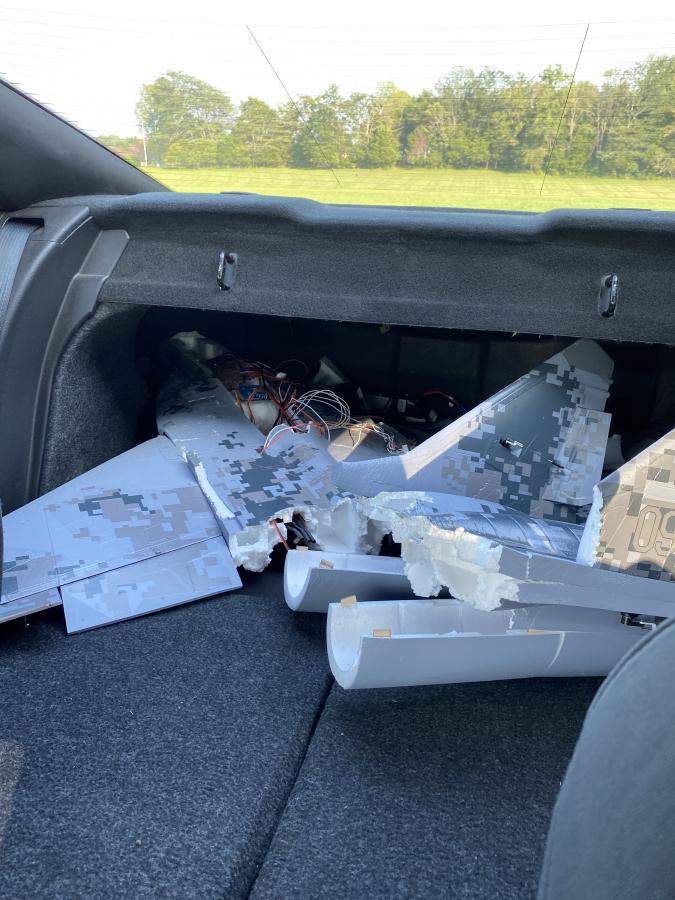

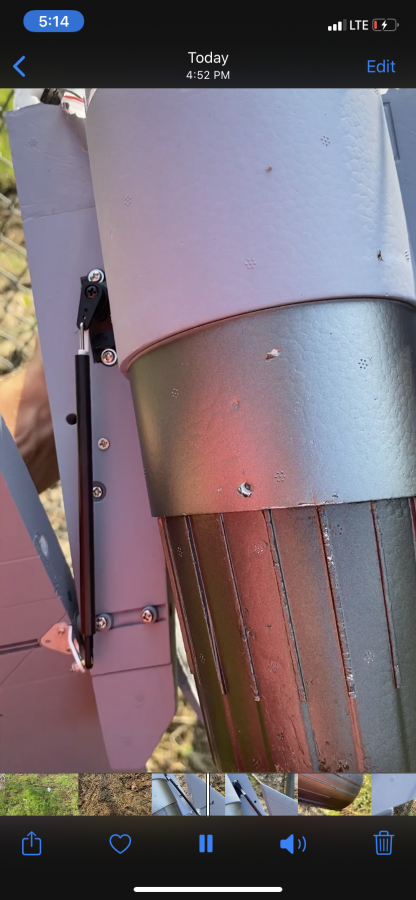

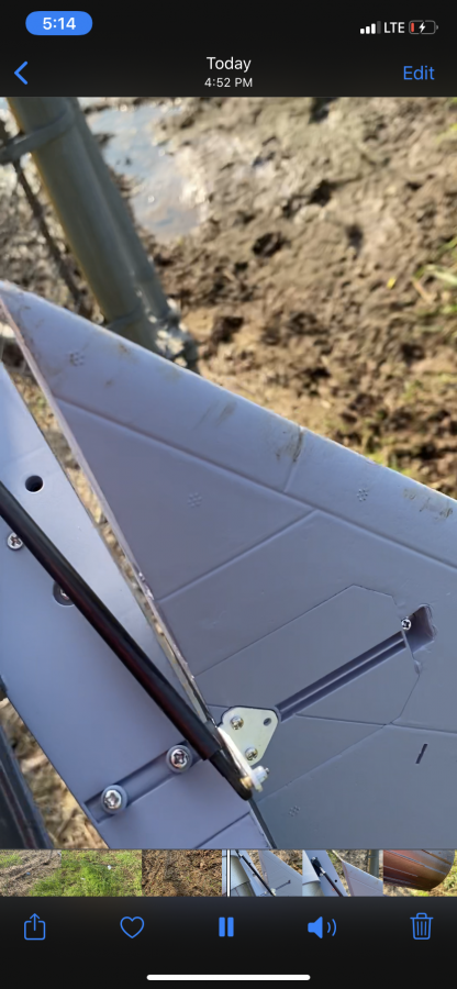

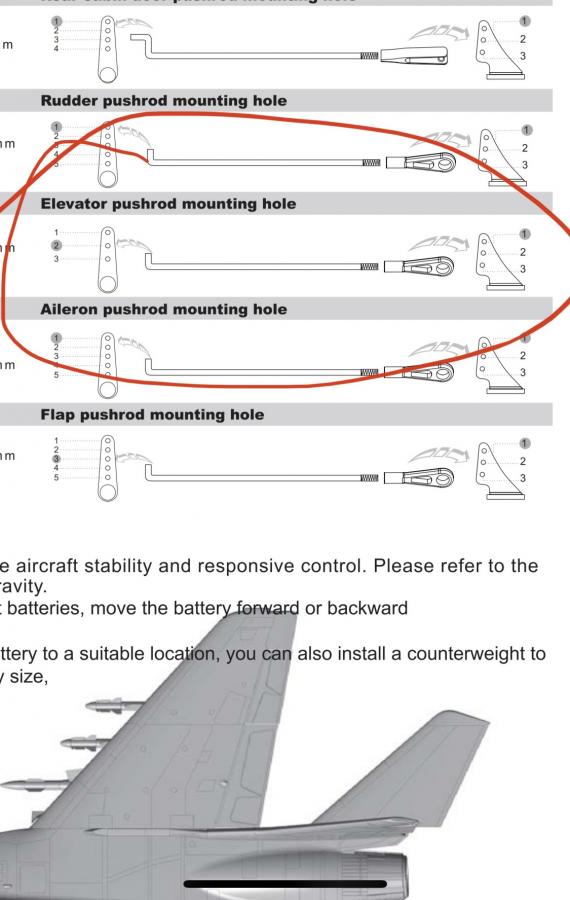

I'm sorry to see this, Tyler. I do remember reading that the recommended servo hole for the control is the middle hole. In the picture you show, I notice the servo hole used was the outermost hole. This may play a factor in what occurred.Comment
That was quick.....looking at the elevator linkage it was installed wrong. Should have been in the second hole. Good luck opening a trouble ticket!!!
Mine is scheduled to be delivered tomorrow.Comment
- Also to note the elevators locked/ froze on in the neutral position not at full up elevator also to mention I was flying on low rates. I posted the original post minutes after the crash and didn’t review everything leading up to the crash
It’s called out in the manual too. You should have seen this during your build process.
