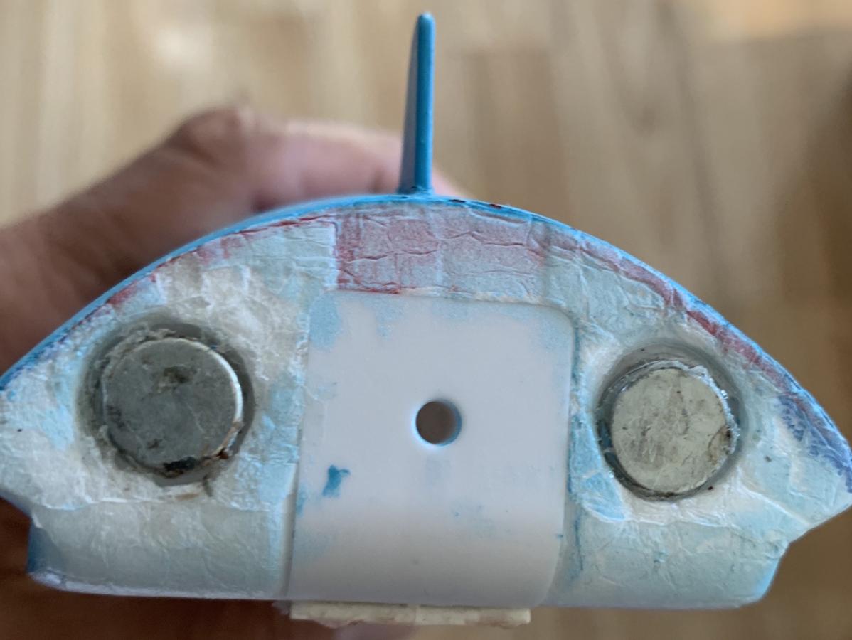

    Here's a closeup picture of mine. (the "L10" was apparently marked by the QC/QA people at Freewing)
    There is a short metal pin that goes into the foam, and you can see the hole and there is a hard plastic "strike plate" piece right below the hole so the pin can't rip through the foam. This plastic piece is not beveled. Also, there is plastic strip (not in the picture) that is used as a "pull strap" (you can fold it under if you don't want to use it, that is where it was in this photo) and if the strap is up, that provides something additional for the pin to latch onto.
    There are some magnets on the midway-part of the hatch to help hold it closed. I think I may add a few extra ones.

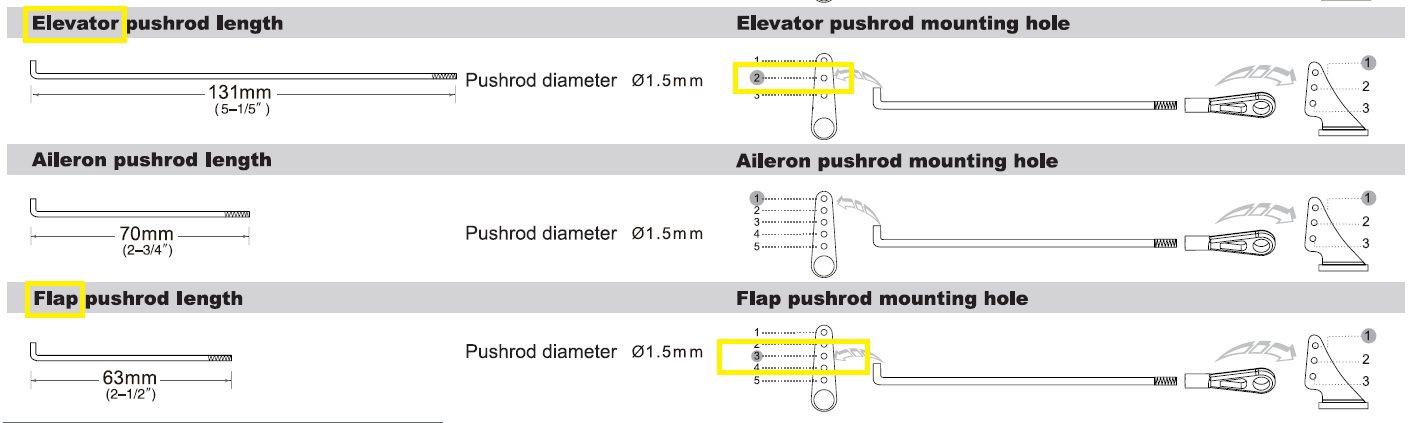

        • Another thing in the manual but not mentioned here yet. Flaps go in the 3rd hole of the servo arm.

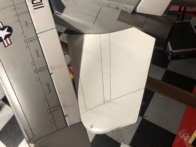

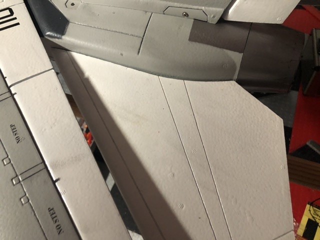

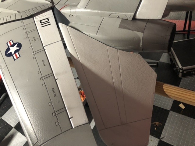

            I did it to my F-14, Simply add weight to the front of the elevator as to when not connected to the servo it won’t drop, it’s balanced at its pivot point.

                  • How are you attaching the weight? I don't see anything on the elevator.
                    • Originally posted by leithalweapon View Post
                      Typically you cut a slit in the foam of the inside edge of the elevator, then slide weight into the slit. I've been known to use coins for weights as they are thin. My F-14 took 80 cents.
                          In the first picture you can see the weights, I carved some foam from the inboard of the elevator and used some wheel balance weights.

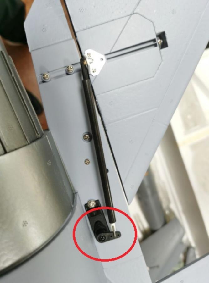

                              One thing i noticed is the Elevator Servo arms as delivered are static centered with the arm arc slightly aft. If someone sets their end point over 100% to gain elevator throw, or at 100%, the arm will almost be or be pointing straight aft. Which may lead to inability to gain leverage and servo freeze.
                              Not saying people do it, but you never know. Might want to reposition the Arm a tooth or two forward arc, then reset throw and end points.

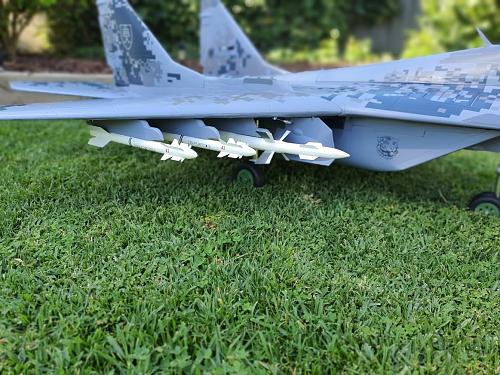

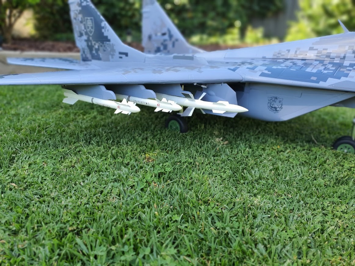

                                  • Just asking for it from the scale police lol, but added a few little details to the ordinance. Be mindful if you're going to mask it up to paint anything, the foam parts are painted so use low-tack masking protocols.
