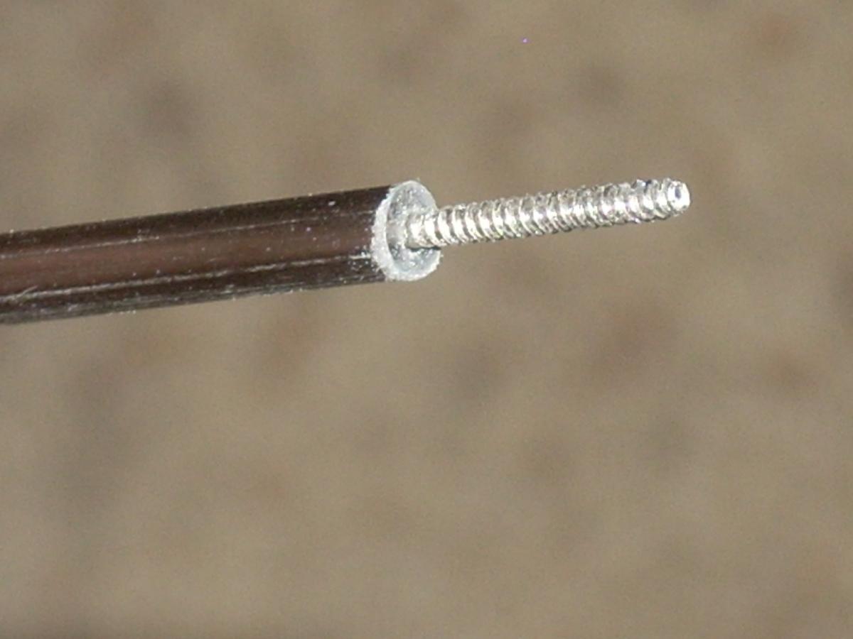

                                Bears repeating I think based on my observations and experience flying this Mig.
                                And I'll add one other thing to this. I think the carbon tube over the pushrod is a great idea, but I think the inner diameter of the tube may be a little too big. It seems they wanted it big enough so that it also covers the control rod keeper, but it may still allow some flex in the control rod. I'm going to put some smaller diameter tube on mine to eliminate any flex, and put some shrink wrap over the keeper.
                                That carbon tube on the elevator control rod looks like an after thought. Like an attempt to correct an undersized control rod. A weak attempt at that. They used what they had on hand at the time.

                                  #1936
                                  I don't think it was an "after thought". The very same design was used on all SebArt MiG29's and who made those? Freewing. The SebArt MiG first came out 5 to 6 years ago. I have two of them. They are much smaller models and had much narrower tubes but they worked very well. They merely upsized the tubes for the bigger MiG. It's not a weak attempt. The concept works. Sure, there may be still a tiny bit of flex on the rod when there is a pushing force but that flex is limited to a very small amount. You see this method used on planes that have extremely long rod lengths. Take for example, the Parkzone/Eflite Radian. Those have rods that run from the battery compartment all the way back to the tail surfaces. They run those rods inside long tubes (sheaths), exposing only about a centimeter or so at each end. Horizon Hobby actually sell long rods and sheaths as spare parts and parts for homebuilt model planes. Rods inside sheaths are not uncommon and have proven themselves to be a viable solution to a situation where a longer than desired rod is used.
                                    #1937
                                    Much better! This rod has an ID of 1.5mm, which fits the stock metal control rod perfectly. And this is a true carbon fiber tube, not fiberglass. Rock solid now.
