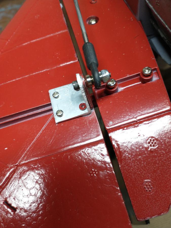

ID:	298700 For those who don't follow RCG, there was a crash report today. The aluminum elevator horns failed in flight due to bending loads. I just cut some doublers from aluminum angle stock and added to mine.

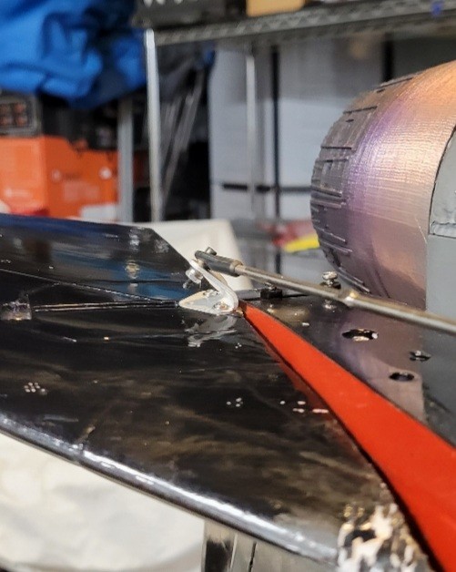

                  Here is the bent ones.

                    Are we sure that happened in flight and not from the crash? I know those aluminum horns are small but I wouldn't have thought they could bend like that with out ripping out of the plastic mount.

                      Without having seen any footage or otherwise know the story, I would by default bet quite a bit on this being impact damage and not root cause.

                        The amount of force to bend the tab like that seems outside of anything aerodynamically generated. While not knowing the full story, I agree with Janmb. My bet is on crash impact forces causing the bending. I inspect my MiG frequently. Not seeing even a hint of anything failing in the area or with the horns themselves.
                        If more info is available, would be nice to see it re-posted here. Definitely need to avoid a case of “Chicken Little” sky is falling.

                          Ya think? "I crashed my car head on into a fire hydrant. It bent the frame. The car was poorly designed. It got scared seeing the hydrant coming and bent itself. They need to build beefier frames."

                            LOL...It does appear that the aluminum horn DID see the beefy <appears to be titanium> push rod coming. Score: Push rod 1, Horn 0

                              It's always difficult to distinguish between damage that caused a crash and damage caused by a crash. But yeah I think it's a little early to ring the alarm bells on the alum horn. Especially when people are kinda sensitive about this model!
                              Or. Maybe it's the fault we've been chasing all along

                                It is not. Plenty of crashed jets had the horns straight and well after the crash.
                                It's certainly another piece to revise and upgrade though, no horn should twist so easily.
                                I kinda agree with the sentiment that the bend on those seems crashed induced, not crash-inducing.
