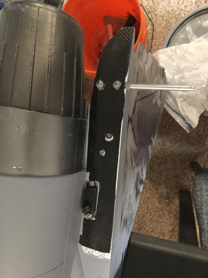

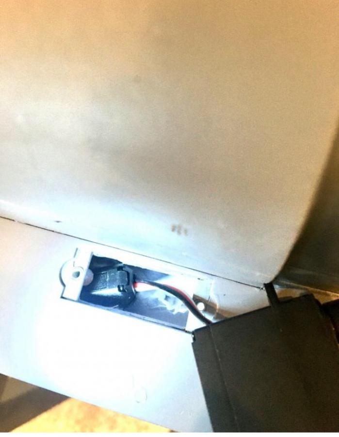

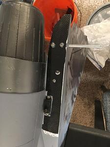

                I know it's really tight getting those servos in and can easily pinch the wires which could possibly cause an issue. Just a guess. I was really careful putting the new servos in feeding the wires in as much as possible then putting the servo in the space. Thoughts?
                I also elected to go with a drop-in servo that has higher torque and lower operating voltage functionality to add margin against potential failure. I agree....getting these "drop in" servos to go into the hole w/o modifying the hole was a trick. It was possible, but tricky not to pinch the servo wire. I almost broke out the Dremel grinder.
                My modifications in the rear end also included the following:
                - Larger diameter (0.5 mm or 22 AWG wire from the short FW-supplied "Y" to the tail servos) to lessen the IR drop, since the upgrade / higher torque servos draw more current
                - There was room for a small RF choke ahead (to the front) of each tail servo. What the heck...it couldn't hurt, so each servo driving the FFSs has an RF choke on it to block any electrical noise that might be heading to the rear servos (see photo below)
                - 0.5 mm carbon sheeting added to the bottom of the fuselage by the FFSs. Not so much to stiffen the area, but to prevent the plastic rectangular box from separating from the foam. Someone mentioned this glue joint potential for fatigue, so I made sure the plastic box holding the FFSs will stay put (see photo below).
                Other modifications were done up front and detailed in prior posts.
                -GG
                P.S. Still having good luck with the Futaba SR-10 servo reverser. I reckon it'll work until it doesn't. Very stable position wise with temperature changes.

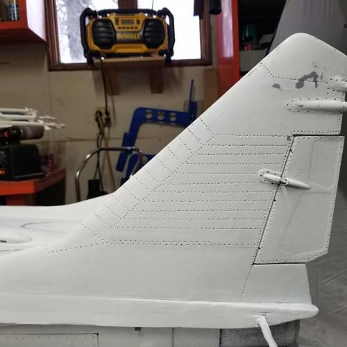

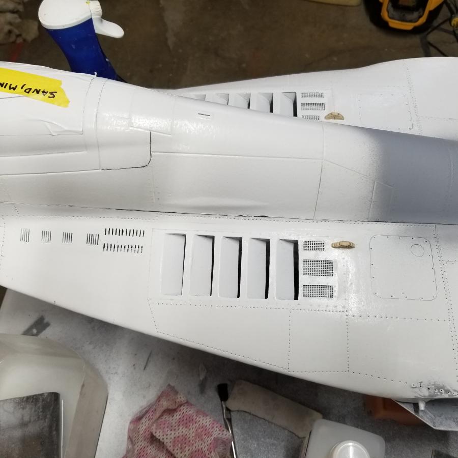

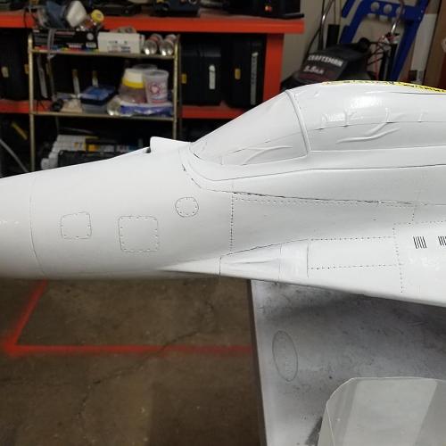

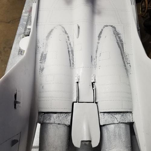

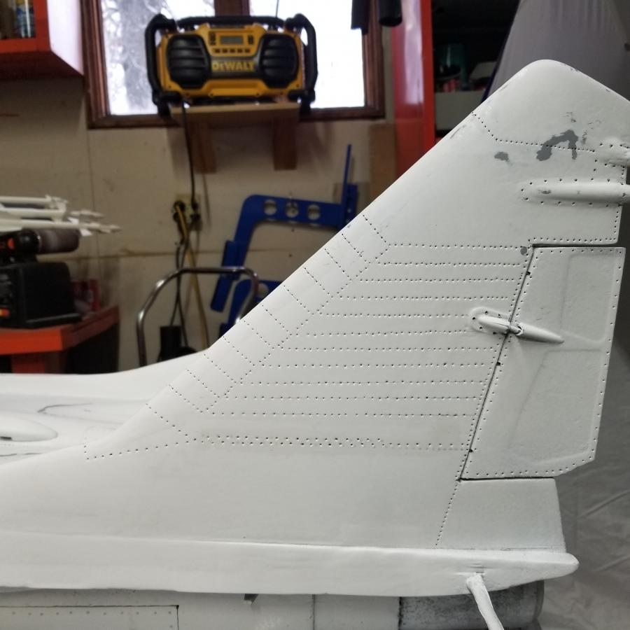

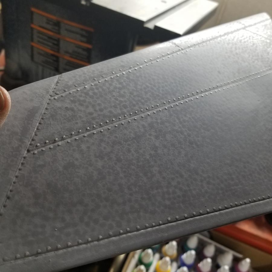

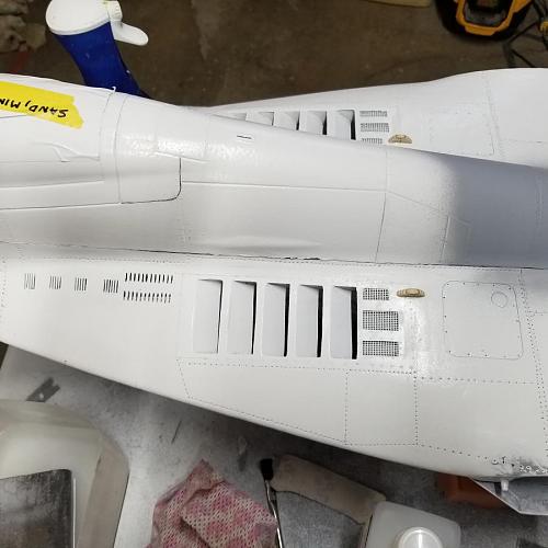

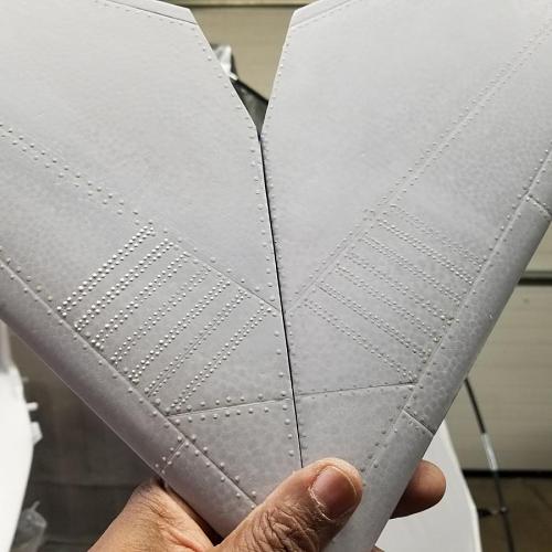

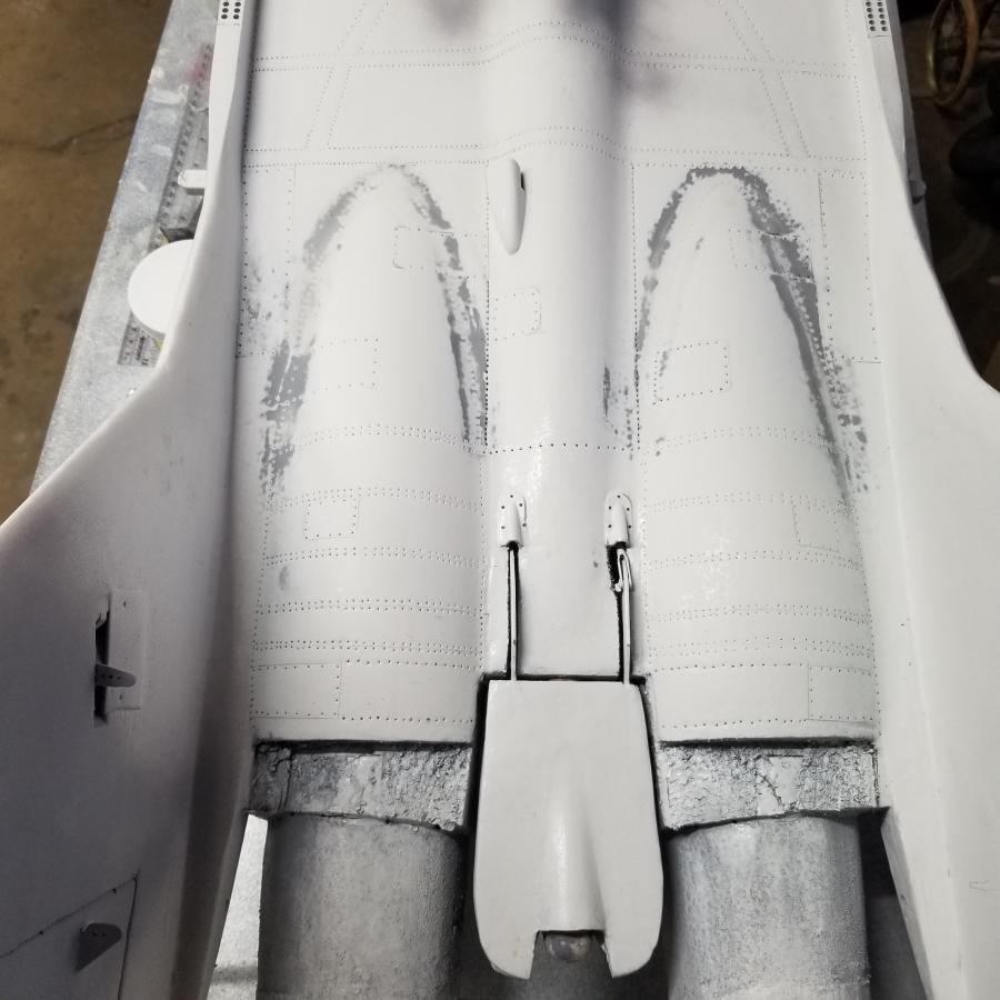

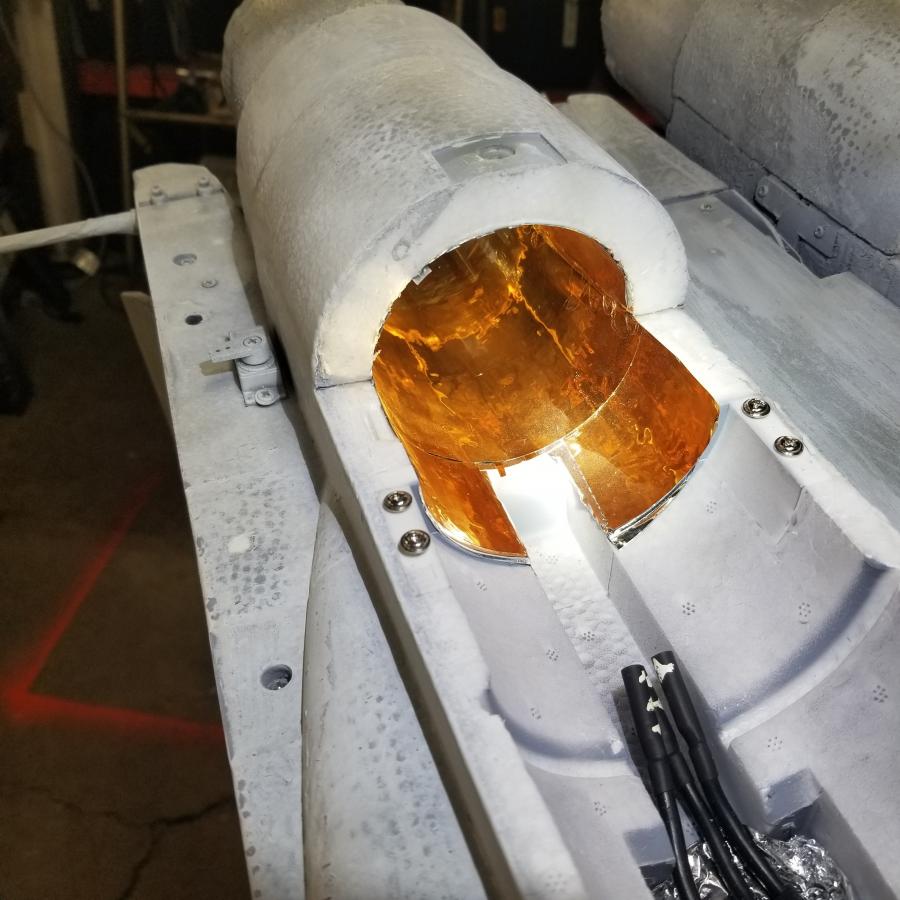

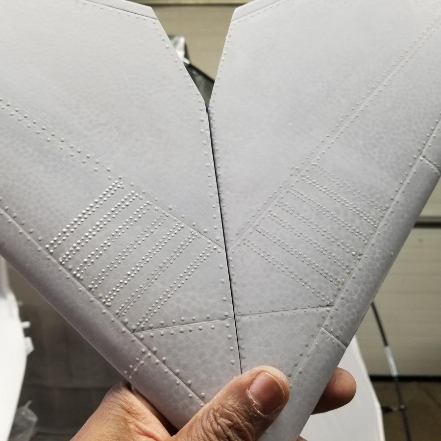

                    About twenty thousand more revits to go , so crank up the music.

                      That's badass.

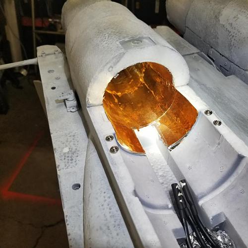

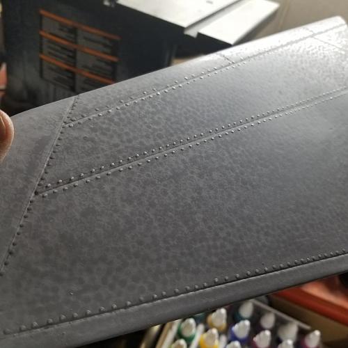

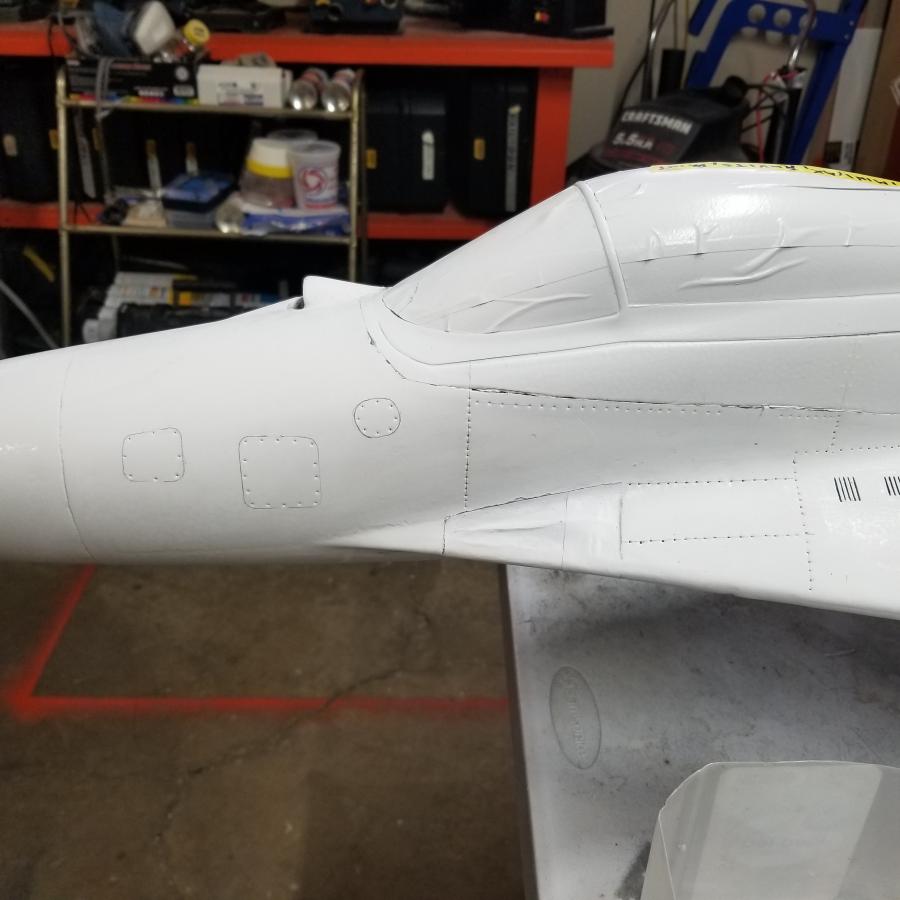

ID:	294980Click image for larger version
ID:	294981 kip Click image for larger version

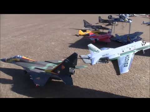

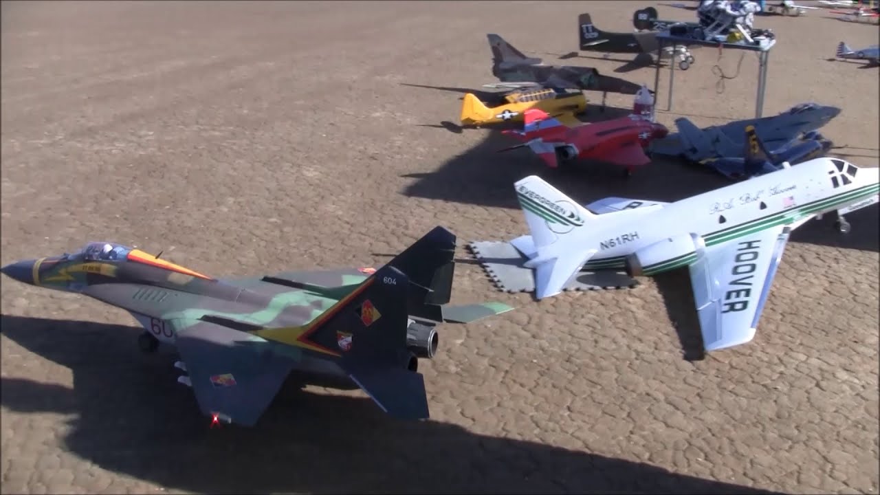

                              Justin Link's superb looking repaint of the MiG-29 Fulcrum in East German livery...😎
                              The level of detail Justin did to this is simply outstanding! I hung out with him in his shop and watched as he put in several of the HUNDREDS of sunk rivets that are in the model, all of them in factory locations using close-up photos. It's painstaking work for sure, but man does it really look the part 😁!

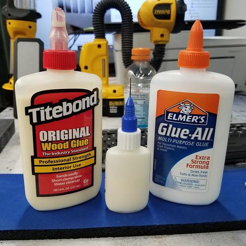

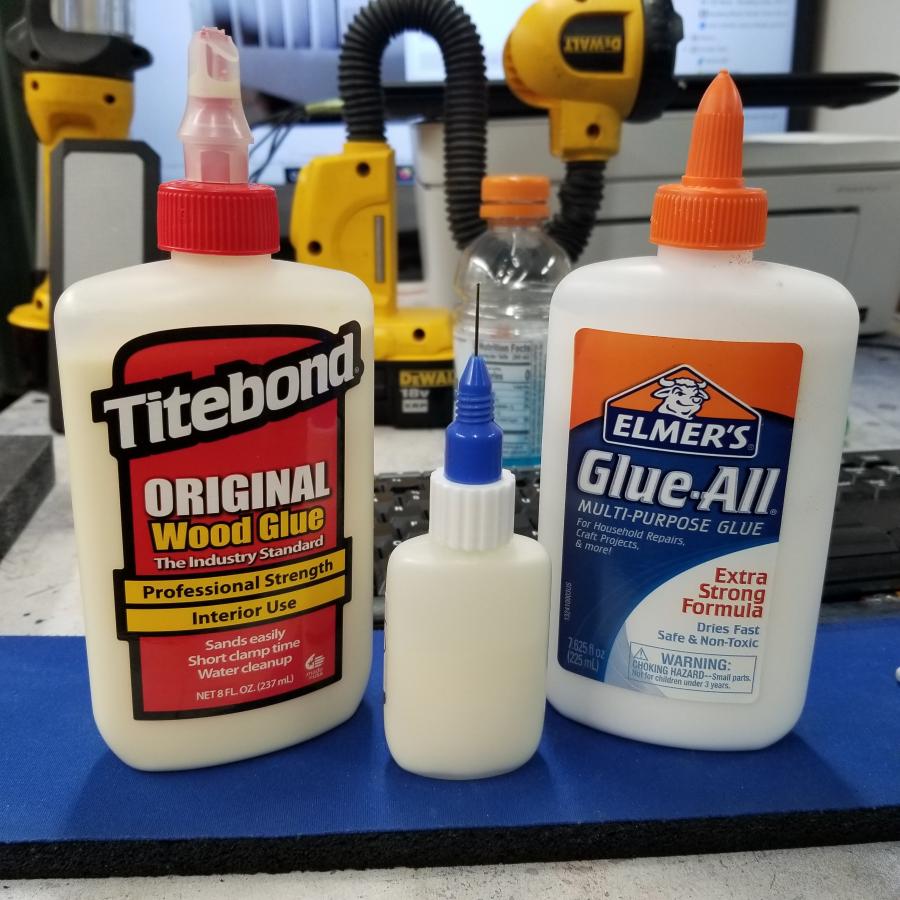

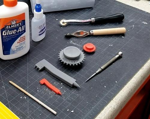

                                    Hello t33 Jetman, what tool did you use the do the raised rivets, great job
                                    • t33jetman
                                      • 515
                                      #3798
                                      I use a these two glues mixed together and a bottle with a fine metal tip from Hobby Lobby. Click image for larger version

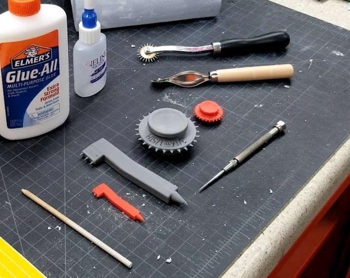

                                        I also have a host of other revit making tools used from time to time.

                                          How do you find those rivet wheels Jetman? I'm about to tackle the freewing A10 and was going to try that technique to dress it up some. I dont think I have the craftsmanship yet to tackle the glue technique, you've been at this a lot longer :)
