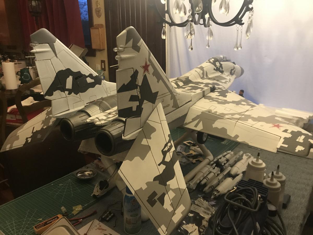

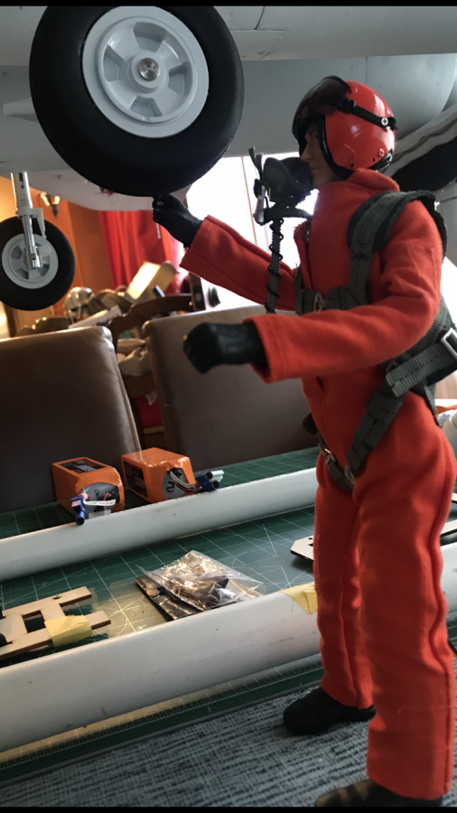

              Tires look good, the pilot said... just waiting for Callie’s .
              i need to switch the stock linkages of the elevator and she’s ready to go up .
              no the best not the wroste, once in the air should look good .

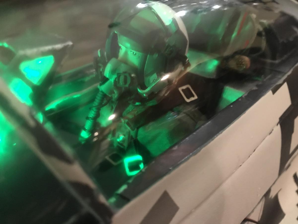

                Beautiful job, your pilot and lit HUD are outstanding, not to mention the fractured camo. What pilot is that and how did you do the painting, with masking tape of some sort? I'd love to see a video of your technique. Didn't know Moscow installed chandeliers for lighting in their hangars, but a nice "sophisticated" touch.

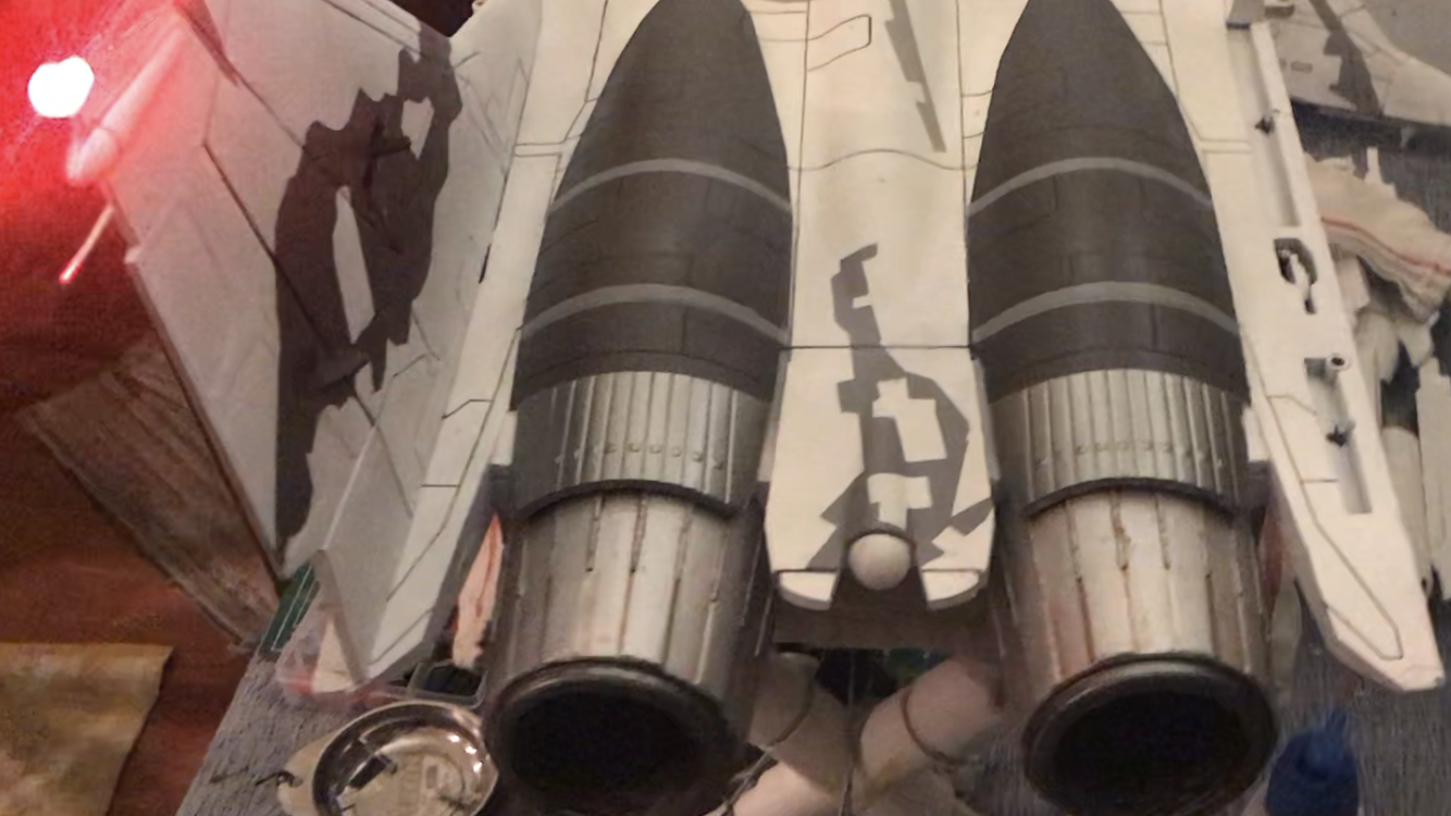

                  Thank you Hugh, nothing crazy at all, just yellow frog, main mistakes come from the poor availability of color bases at the store, so i had to use the eggshells instad of matte. Tape had serious hard time to stick on it, few lines are not that good, i’m honest .

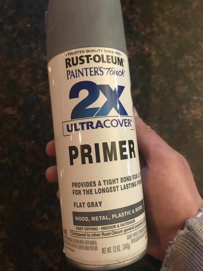

                  little note if i may on the PRIMER . Please oh please try to use the rustoleum 2x FLAT GRAY .
                  For any good reason , once you paint does never peel off. I did only 2 jets using specific this gray and i had zero problems.
                  Painting with a tiny airbrush took forever, especially the white base and especially if you are not good ( I’m learning, not shame on that ) .
                  this was paint number 7...
                  i will definitely do the video of the maiden to share.
                  thank to everyone to like the post, THANK YOU.

                    This primer Works for me and i’m super happy

                      Beautiful job, your pilot is that ...
                      the pilot was a full body from Mr Adam of Warbirdpilots.com . I have to cut it , no thrill on that specially for the price, but does look good.

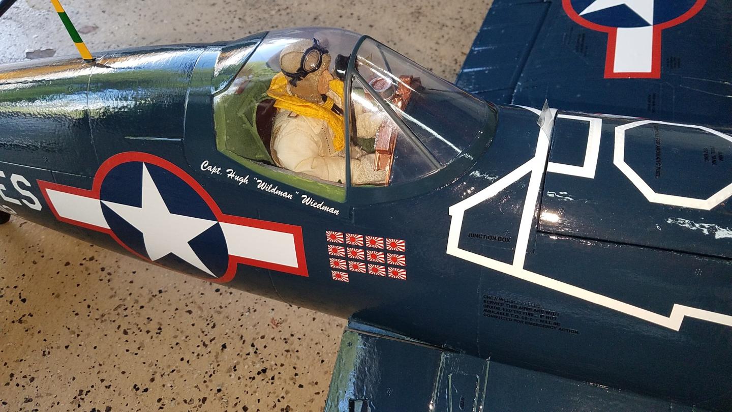

                        No, it doesn't look good, it looks great! I put one of their pilots with the moving head in my Corsair and it looks IMO awesome, if not a little big, but I always say go big or go home! I've been trying to come up with a nice pilot for when I do my Mig, but didn't even think about the warbirds pilots, so thanks for the idea, hope you don't mind if I steal it since he looks so good. I didn't have to cut mine down in the Corsair, only had to remove his boots so his bare feet could direct the elevator and rudder servos. BTW, I actually always use the Rustoleum flat white primer on my aircraft, so far only about 5 of them that have been a total repaint. I also put a couple coats of Varathane Spar Urethane on after the primer and it seems to help hold the base for masking. Then 3-4 final coats of the Urethane after all paint and graphics are done. I use the white so the final paint coat gives true colors but with your repaint, I see the grey is the perfect base for that. Anyway, can't wait to see the maiden.
