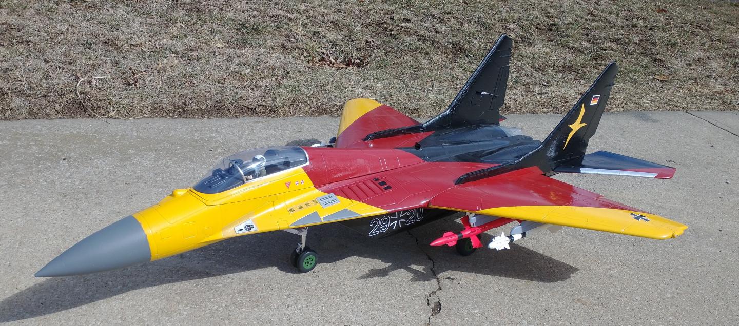

          Yes, repaired.
          Click image for larger version  Name:	Mig 20 Mar Mad 2.jpg Views:	0 Size:	233.9 KB ID:	301088 In retrospect I've considered whether keeping full power would have made the outcome better. My thoughts were that the plane would eventually stall and pitch down and power dive into the ground and that climbing higher would only make it worse;but on this one maybe not. I didn't have a lot of time to consider options.

                Yes, repaired.
                That repair looks great, like nothing happened. As far as the plane veering while on the ground run, consider an Assan steering gyro. They're quite cheap and will keep the plane straight as an arrow on the ground. I believe VT nozzles would have helped level the plane and get it going well enough to get airspeed up.
                      Actually, mostly replaced rather than repaired. The reason for the plane veering left is that I forgot to lower flaps before starting the takeoff. It was dead calm and I quickly thought that flaps would be needed. I looked down at the Tx to flip the flap switch and that's when the plane yawed. I will look into a nosewheel gyro.
