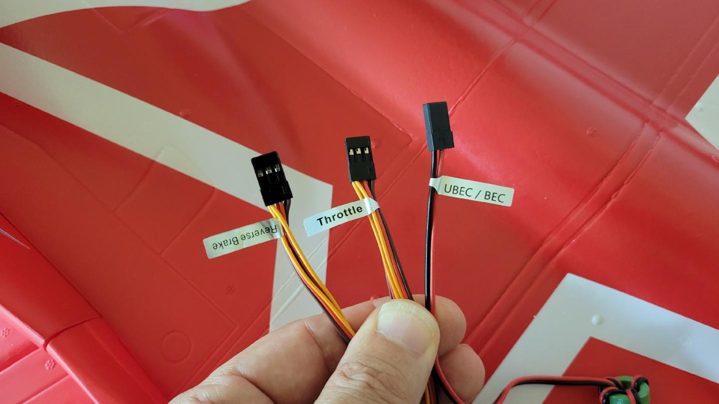

        I just assembled my red star mig-29. The right fan/motor was not running. I swapped the motor and right side still not running. I then disconnected the left side and the right fan runs. It seems that both fans and ESCs are good but if both fans are connected, only the left runs.
        I had a Mig-29 when they just came out and I don't remember having to do anything special to get them running. I did calibrated the ESCs initially but that didn't help.
        Any thoughts?

          Bad y connector?

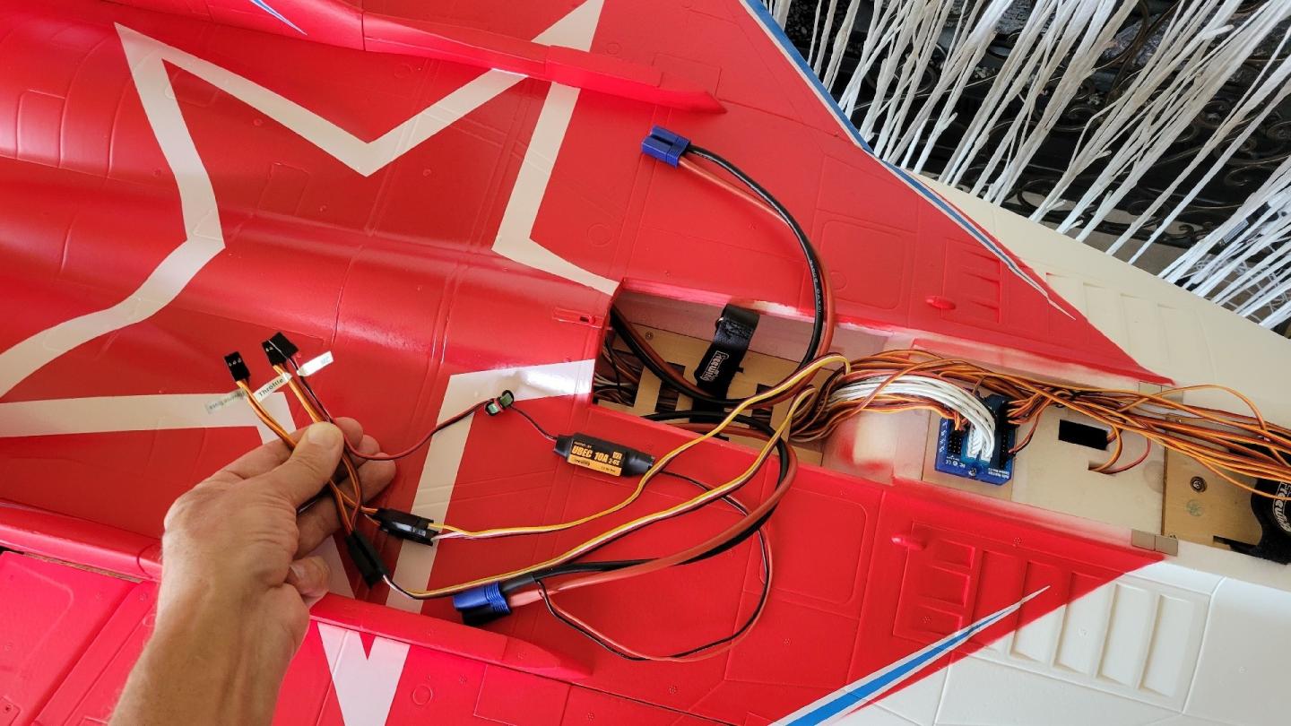

            Thanks Evan! Please excuse my ignorance, but where would this Y connector be? Is it in the open around the battery compartments or inside behind the aft battery?
            I attached couple of images. The Reverse/Brake feature is cool.

              I hate to say but I don't remember. Sorry.

                I call Motion RC and talked with Tim. He asked me to disconnect the throttle from the Y-split on the side that was running and go through ESC calibration with the throttle trim all the way down. The right side started to work but now the left was not running. We tried this couple of more times and got both side running.
                  You are holding it in your hand on the pic!
                  Glad to see you sorted it out already, Godspeed!
