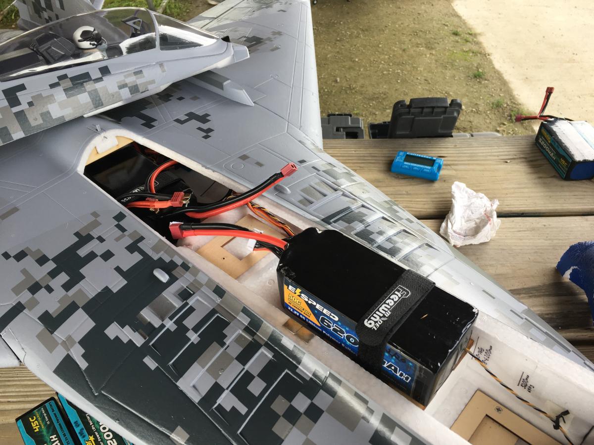

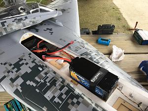

    Can you help me out please? I can not find a good placement for the batteries Admiral 6000 50c) to balance this plane. Is it possible to ask if you could upload a pic of your battery placement in the plane? I really appreciate it my man!!! Merry Christmas!!
    1st question do you have the red star mig or the camo version? The thrust vectoring nozzles will make a difference on where the batteries will need to be placed in the plane.
    I'm running the SMC High Voltage batteries (5300mah 75C 6S) which weigh in at 731 gr.
    I'm using the rear and front battery compartments. Rear is sorta irrelevant. But the front is what counts. With my setup. I'm positioning the battery on the very front edge of the wood tray. She CG's neutral (sits completely flat and level)
    I have tried some spektrum 5000mah 50C 6S batteries (760 gr), but had a hard time getting the CG neutral with those batteries. Still working on it. So I don't really have and answer for you on those batteries.
    The Admiral 6000mah 50C 6S batteries weigh in at 910 gr. which in my opinion are probably a bit too heavy for this plane?'
    I would suggest trying a smaller battery and just keep playing with it. You'll find the sweet spot.
    I would send you a picture. But I won't be able to do it until Sunday.
    Also as already suggested, you may need to carve out some of the foam on the canopy to fit the bigger batteries and get it to CG
      Those are 910g ea? Here is a pic of where I place my heavier batteries but they are much lighter 760g. I have flown with 830g ones but they where causing it to be a bit nose heavy for my flying. You would need yours further back, not sure they would fit with the canopy closed. I normally fly with two 645g 5200's.

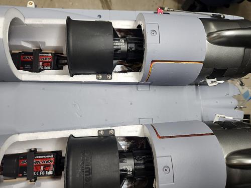

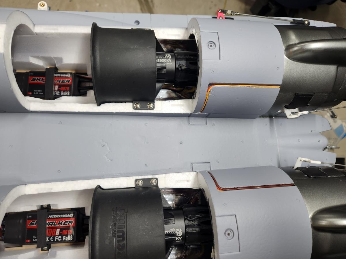

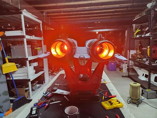

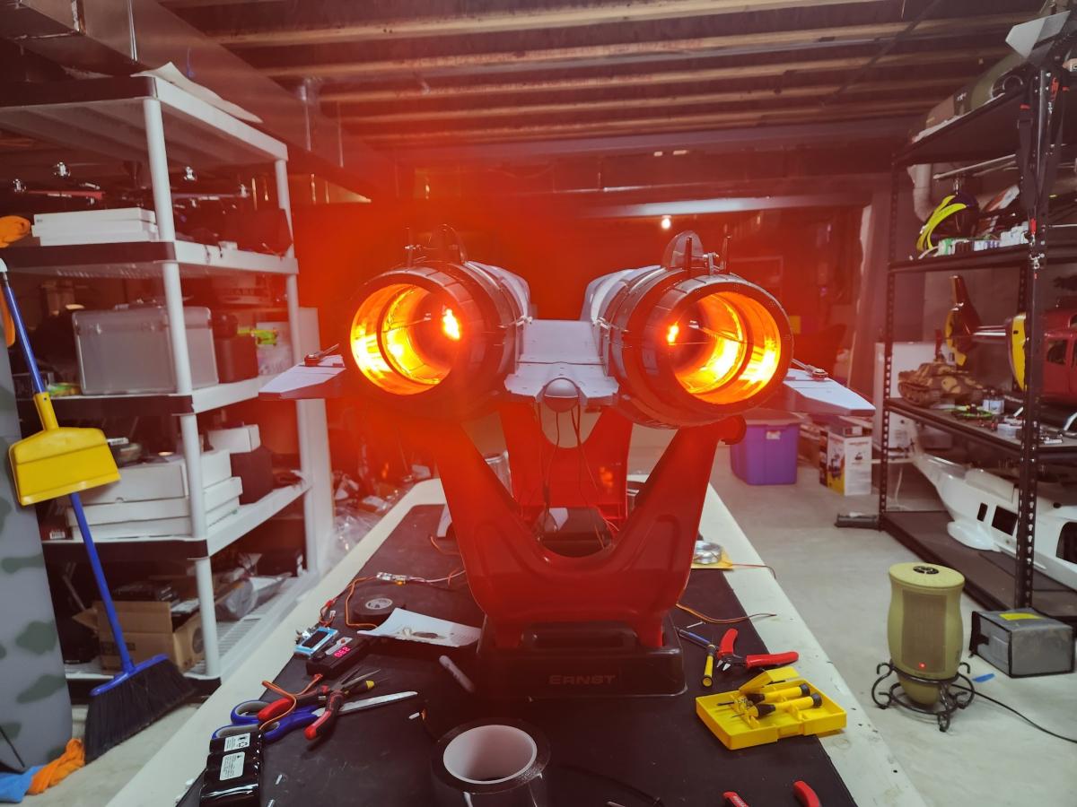

                            Well Santa dropped a nice new Mig under the tree last night, so I spent most of the evening and today getting it sorted. I have all the wires plumbed and now the hard part.
                            Looking to start getting my receiver etc. wired in but wanted to ask about battery position re CG with both VT and AB installed. Anyone have a recommendation they can share?
                            Also, I did the AB with no exposed wires and lined both thrust tubes with 1.5mil mylar tape to make them smooth and retina burning reflective.
