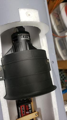

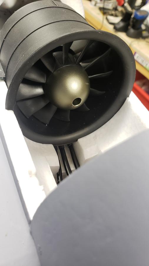

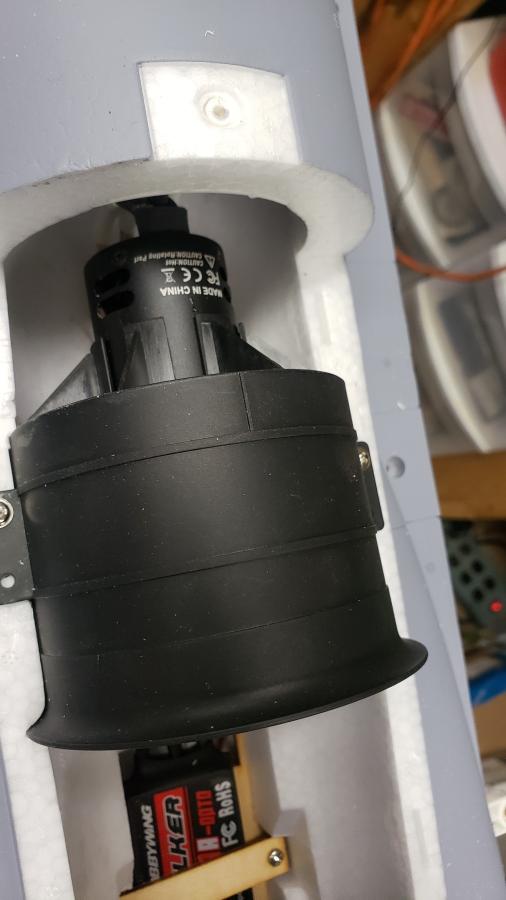

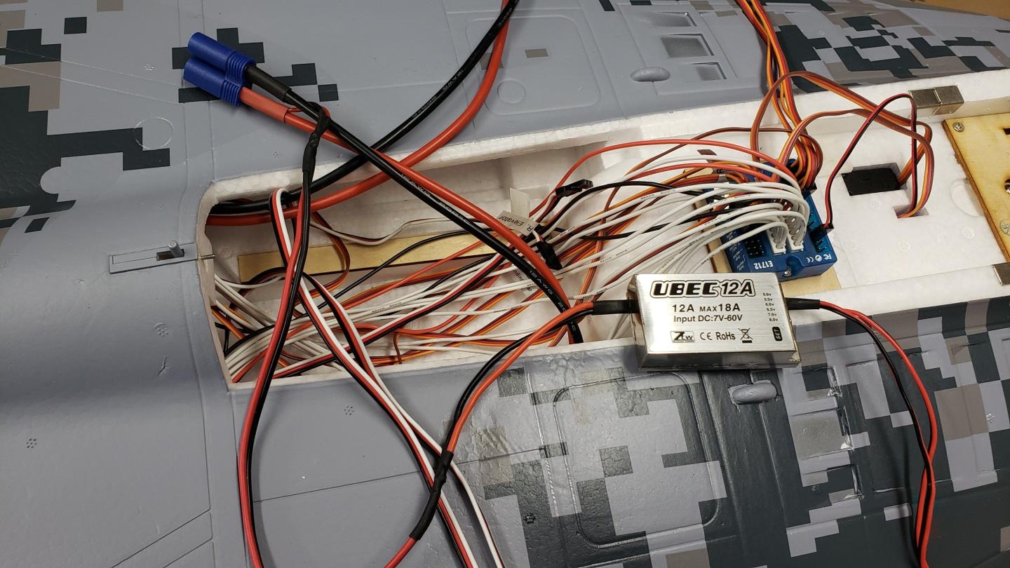

                      Getting closer ...
                      wired in the replacement UBEC, installed the FMS 3665 2000KV fan units, and 3D printed the intake louvers. Fun fact, the EDF mounting tabs are off center, maybe by about 2mm. So it was easier it mount, meaning carve out less foam, with the wires coming out the back of the motor at 12:00 vs 6:00.
                      TV unit, gyro (didn't have the one I thought), titanium rods, heavy duty ends should be here tomorrow. If all goes well, I should be done by Monday, but current schedule of other stuff may prevent that.
                      In the mean time, I need to work on my crashed F-22. Transfer equipment to new airframe. Click image for larger version  Name:	image_82885.jpg Views:	7 Size:	40.0 KB ID:	356000

                        The fan tabs when mounted right have the surface on the center line of the unit. If you flip it upside down then the whole unit is offset the thickness of the tab. It sounds like doing so you didn't have to carve under the fan but you may have to carve doubly into the cover.
                        Wow, what a rats nest. When I built mine I didn't use the interconnection cables and stuffed the MCBe in the rear. I forgot how many wires there were out of the box, stock.

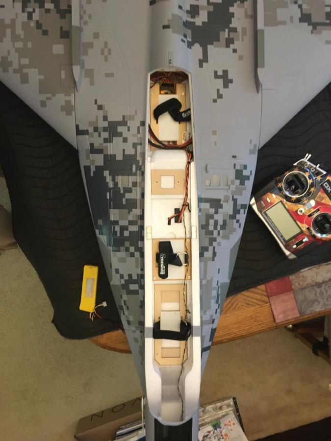

                          Yes!!! I saw the neat installation of moving the blue box to the rear battery bay. I am planning on doing that too.

                            If you use that middle battery location you'll need to do something.

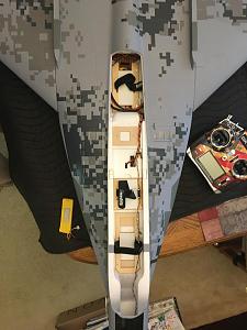

                              OK team, here's an overview. Everywhere I look it seems like everyone is using the back and the middle battery trays. My MIG has the TV installed, RC Geek afterburner lights added and that's it. Just using Spektrum 5000's as test bricks (690g each) they are in the middle and front forward trays just to get in the CG ballpark. Anyone on here using the same placement or did someone put a lead weight in the tail end of my plane embedded in the foam somewhere?

                                I have TVs and no ABs. When I use my 5000's which I normally do I have them in the aft and fore. They are 645g each. When I use my 830g 6000's they are the aft and mid. I have my CG slightly, 10mm aft of the marks.

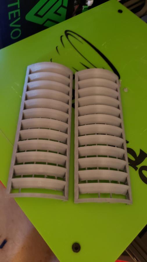

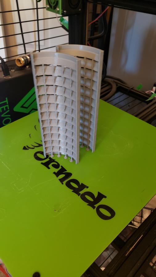

                                          My Do-it-Yourself afterburners are not only inexpensive but also less obstructive of the airflow an run directly from the LiPo.
