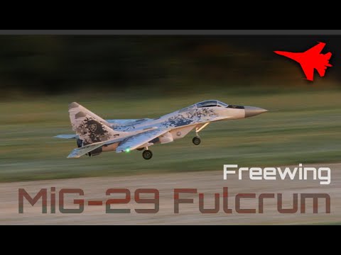

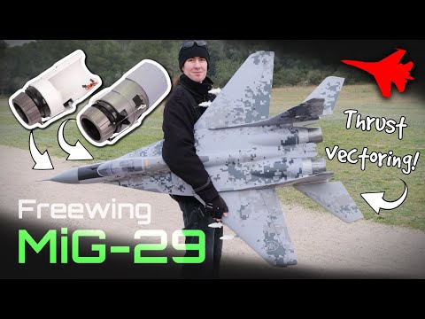

        Well... finally!
        There go my first flights with the VT nozzles. Again, the plane was out of (stab) trim and a bit too nose heavy so you can attribute bad flying behaviors (if you can notice any) to those factors ;)
        There are 2 very clear demonstrations of high alpha lock no longer being an issue at minutes 0:55 and 5:00.

          Thanks for posting.
          Oh my gosh! IF ONLY….IF ONLY!!!!
          The alpha lock at 0:55 recovery says it all. You have this bird, you need the thrust vector kit.
          Wish I had installed it on mine….RIP little MiG that is no more.

            I posted over on the other thread. The TVS are great to help you get out of "alpha lock" but they don't prevent it.
            I've probably 50 TV'ed flights and it still doesn't feel right.

              Well, I wouldn't quite describe it as an alpha locked if you are not locked into it...
              Most of these fighter-jet airframes will have a tendency to pitch up as they get into high or extreme AoAs depending on CG setting.
              The MiG just made it worse with a bad thrustline. A better thrustline and the capability to vector makes away with that. One shouldn't be afraid to enter that condition, one should just practice to learn how to get out safely ;)
              With TV, it is easy. Without TV, it's almost mission impossible on this one.
              And I agree with GG, TV is the way to go on this one IMO. (Or at least install nozzles with better thrustline after kallend sorts them out).

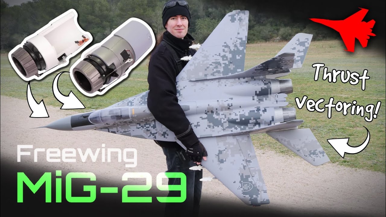

                                      Second flight session with the VT MiG. Better this time with more aft CG again and a couple of rails added back in but still have to set it up better and I'm feeling like the jet could really do with a gyro... :p

                                          Impressive multiple alpha lock recoveries starting at 2:30 and beyond. Now that’s COOL!
