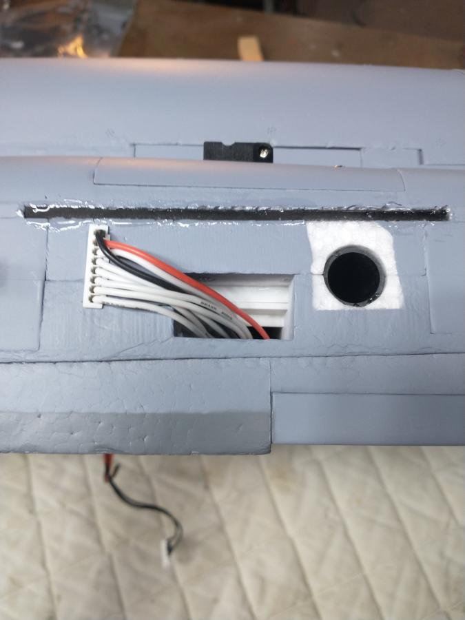

                Are there pictures of what you did to reinforce the gear mounts? I'm starting putting a Mig together. Better to do the fix now than after the gear are loose.
                • Originally posted by radfordc View Post

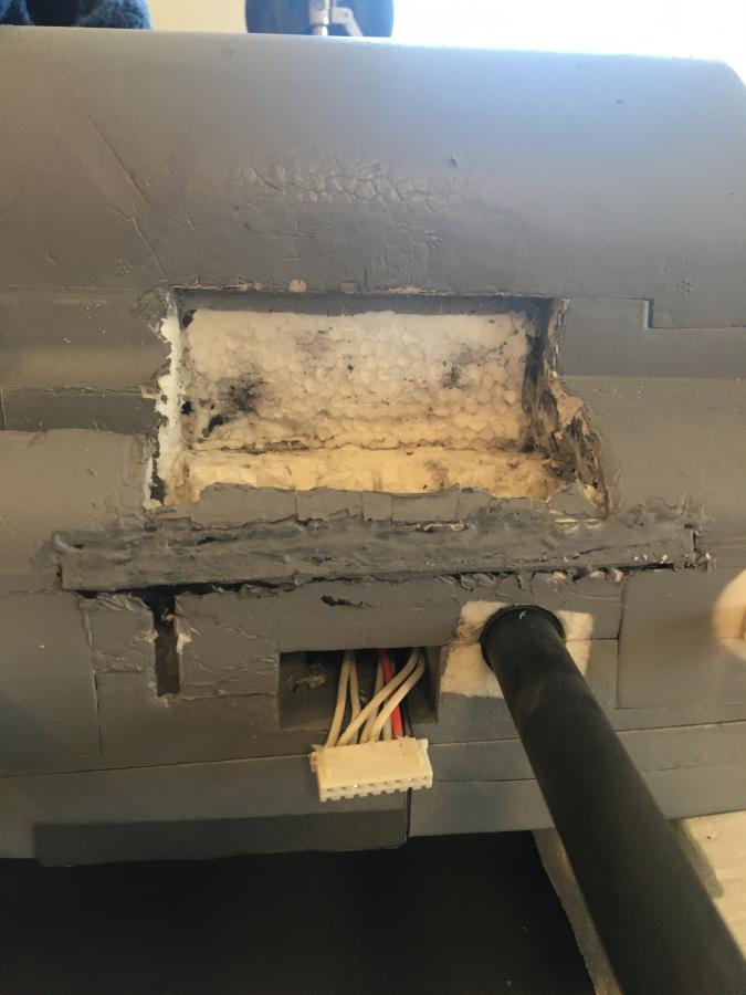

                  For starters....here's the start of the posts about the plastic gear mount replacement process for your files and future reference. What a pain! The photo shows the mount area after you get the plastic mount out. WHAT A PAIN THAT WAS! it doesn't leave the area looking very pretty, either. But, this can be filled/repainted after the grunt work is finished and the new plastic mount installed. MRC support said, "The plastic mounts were not meant to be replaced."
                  https://www.hobbysquawk.com/forum/rc...385#post332385
                  PLEASE NOTE: YOU DO NOT NEED TO REMOVE THE PLASTIC MOUNT TO REINFORCE THE AREA!
                  I just happened to take the photo when I was doing the plastic mount replacement.
                  Now to answer your question: Primarily, the thin foam shelf on the outside (the side towards the wing tip) of the hole that the plastic gear mount sets in gets soft and mushy after a time.
                  Note: For the rest of my post, consider the MiG is upside down as in the photo. I wasn't concerned about how "pretty' this all looked because it is covered by the wing, once you put the wing on.
                  With the wing off, you will note on the fuselage there is an area of foam below (towards the floor) the thin outside edge of the plastic gear mount. If you carefully cut (watch for wires, spars, etc.) a notch into this foam and insert some carbon "under" the area of the outside thin shelf, it will strengthen this area significantly. It holds up REALLY well.
                  Glue in the carbon with your adhesive of choice, Foam Tac, epoxy, hot glue, etc. Whatever you think is best. I used JB Kwik Weld epoxy which has a 3000 psi strength. Slow cure epoxy will be even stronger.
                  -GG
                  Aside: Since one must cut the mount's 3 screws off with a Dremel tool to get the plastic mount out piecemeal (you gotta cut it out in small pieces), when I reset the new mount in the hole, I used epoxy to secure the plastic box and basically replace the function of the screws. Hundreds of landings later....the mount remains solidly attached.
                  PS: The reason the vertical wall is white is I glued some carbon sheet to this wall and then made an angle brace from the carbon sheet to the plastic mount. It turns out that this vertical wall is VERY thin and will tear easily when the carbon sheet is removed or the carbon sheet shears from a hard landing. In hind site, I don't think I would try attaching anything to this thin wall of foam that might put stress on the thin wall. It is not made to withstand any stress. It's only purpose is to form the wall of the air duct to the EDF fan. Lesson learned.....
                  Click image for larger version  Name:	MiG_Reinforcement.jpg Views:	0 Size:	50.4 KB ID:	341268
                  • Like so.
                      Like so.
                      perfect!
                      • I can see how it helps tie the gear into the two plastic wing retainer mounts. Good idea.
