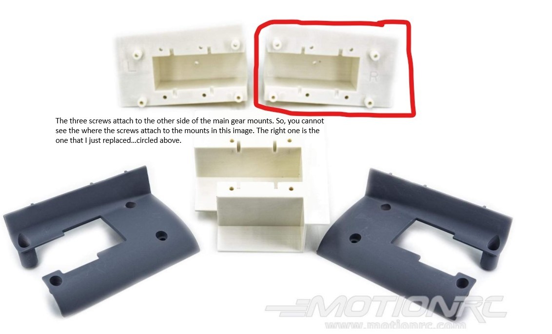

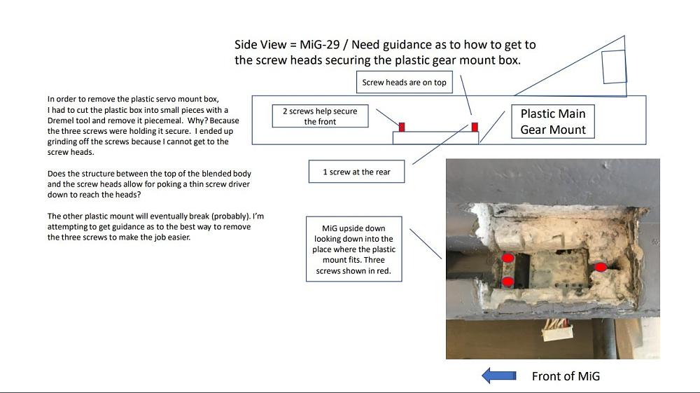

              I noticed a main not fully retracting, Saturday. I could get it to go up, but only by flying at slow speeds. I've seen this before and know it is an indicator for needing a new retract servo. Started work on it Sunday morning and while inspecting things...found a crack in the other side's main gear plastic mounting box. I had spare mounting boxes, and I knew this type of crack (running front to back right by the servo motor's screw mount holes) wasn't going to be permanently fixable. Not at the weight of this bird.
              BE CAREFUL...wires and spars abound on top of this area <toward the top of the wing that is>. Don't Dremel blindly. You may want to remove the wing to better see where things are.
              So, 7 hours later I'm finally buttoning her back up. OMG....That main gear mount box is not a piece of plastic that is meant to be easily replaced!!!! I'm not gonna bore you with the details, but there are things going on in there that will offer up some surprises. Have your Dremel tool handy. I could only get the cracked mount out by Dremeling into small areas to pull out piecemeal. SURPRISE...there was a reason I couldn't pull it out. Read on....
              What I found was...there are 3 screws (two at the front and one a the back) screwed in from the topside holding the box in. AND...there's no access to the screw heads. The heads are toward the top of the plane!!!! Maybe you could get lucky and punch a screw driver down from the top of the blended body area and get to the screw heads, but I just cut off what I could see with a Dremel tool...banking that my "build back" re-enforcement decisions would negate the need for the 3 screws. Time will tell. I sure as heck didn't want to punch 3 holes in the top of the blended body/wing area and go blindly fishing around for 3 screw heads way down in the bird. But, maybe that's the only way to get to the screw heads?
              Again...after 7 hours of Dremel action, head scratching, carbon re-enforcing and epoxy mixing I AM FINALY DONE!. The box is as solid as a rock. But, will it hold up? I've been proven wrong before by repetitive applications of stress on a structure that I thought I had "fixed".
              If you've got ideas how to get to the 3 screw heads without punching holes through the top of the blended body area, please speak up. I do not look forward to having to replace the other box when it cracks, if the only way to do it is the way I did it this time.
              Anybody got a crashed MiG you could cut apart and shoot some pictures of what structure is above the main gear. I just tapped on the top of the blended body in this area of mine, and there wasn't a hollow sound. Is it even possible to push a screw driver down through what is above the main gear's mounting box?
              Thanks.
              -GG
              • GliderGuy
                • 1408
                #5187
                ***Update to the below and above posts***
                MRC Support was kind enough to send me some CAD drawings which (of course) agree with what I found when I attempted to remove the main gear plastic mount. Then, MRC stated the following (I paraphrase):
                *****(1) Not designed to be replaceable
                *****(2) Suggest you buy a new fuselage
                OK...Which is what I sorta figured, but was hoping otherwise. AND...I appreciate MRC's help + CAD drawings. If you wish to see the CAD drawings, I have attached them as a PDF to which I added rectangles representing the 3 screws. Again, these CAD drawings were modified by me to show the 3 screws.
                So..... (1) I may yet decide to poke a thin wire down through the foam and see if any structure would prevent getting a long thin screwdriver down to the screw heads from the topside. (2) If not, I will use the method I used for the first plastic mount when another one cracks.

                  Well GG, it looks like you are going to have to go down through the top come what may so I would suggest drilling a tiny vertical hole up the way between these screws. Take exact distances and angles from the wee hole to the ground down screws you can see and use these as reference points to locate the screws from above. When you have these points marked, fish down with a needle on the points till you hit a screw head. Just my tuppence worth !!

                        The main take-away from all this is, "YOU CANNOT GRAB HOLD OF THE PLASTIC MAIN GEAR MOUNT AND PULL IT OUT OF THE FOAM!" Now we know.
                        Given the time it would take to "outfit" a new/virgin fuselage with all the stuff required (and the cost), the time invested grinding the cracked plastic mount out and cutting the 3 screws is a lot less effort and cost. AND...I don't see a set of digital camo decals for sale, either. So, you'd have to paint on the digital camo pattern. Hmmm.....
                        My grind-and-cut piecemeal removal method is beginning to look more "sane' all the time. It really wasn't difficult. It just took a lot of time. And, the amount of epoxy I applied to the replacement mount should ensure the 3 screws won't be missed.
                        I also took some time reinforcing, with carbon, the outside (the side toward the tip) thin foam shelf in the fuselage that the plastic mount's lip rests on. That shelf gets mushy from all the repetitive stress landings place on it.
                        Even though the two plastic main gear mounts were not designed to be replaceable...it can be done.
