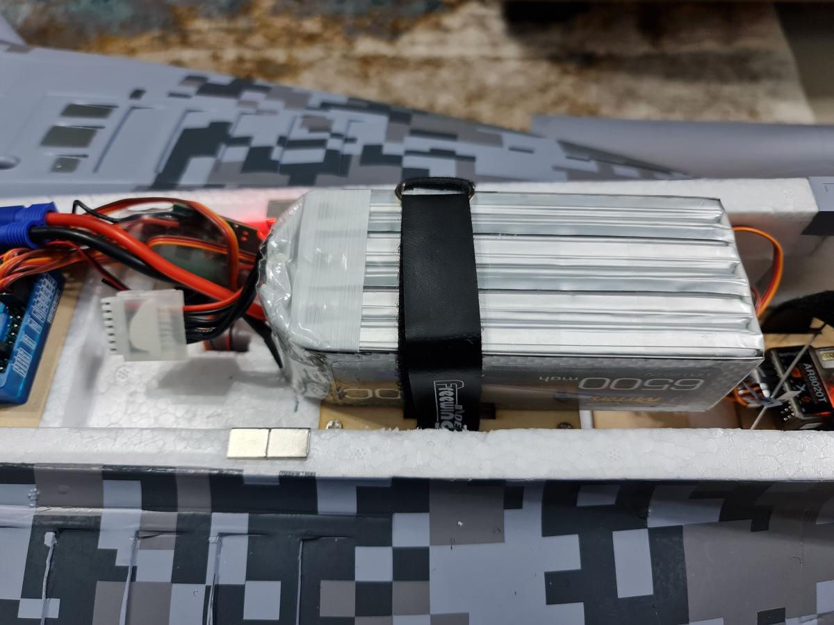

    How are you measuring the CG?
    Sounds to me like you are doing something wrong.

      Just brought the Mig 29 with the new set up for the elevator .It has metal servos and a metal push rod .I am having trouble getting the COG right .It is fine with 2 4000 lipos but if I put one 5000 lipo has far forward has I can at the rear and has far forward on the top battery tray but the COG is to far back and if I get the COG correct the top 5000 is to far forward I can not close the canopy .Same with the 6000 lipos .To get the COG correct with 2 5000 or 2 6000 I will have to add 6oz of lead in the nose .Has anyone else come across this or am I the only one that can not get the COG right with out adding lead in the nose on the 5000 or 6000 batteries .I am a bit confused I thought the COG would be OK by just moving the lipos around with out adding lead
      as everyone said , something is not right . i fly this bird with genis 6500mah and the HRB 4000mah and i can get the CG 10mm AFT
      the 4000 will fit far back in the front bay and far forward at the back bay. each battery weight 600G althought the HRB that i use went once to 3.71V and when i charge it , it took 5300mah to reach 4.2V so i assume the HRB 4000 is actually 5500mah minimum
      with the 6500 will fit as much forword as u can in the middle bay while u can close the canopy ( u might need to cut a little foam from the canopy to fit perfectly ) and the second one will fit exactly where the 4000 fits at the back bay. each battery weight 705G attached an image for the middle bay battery location

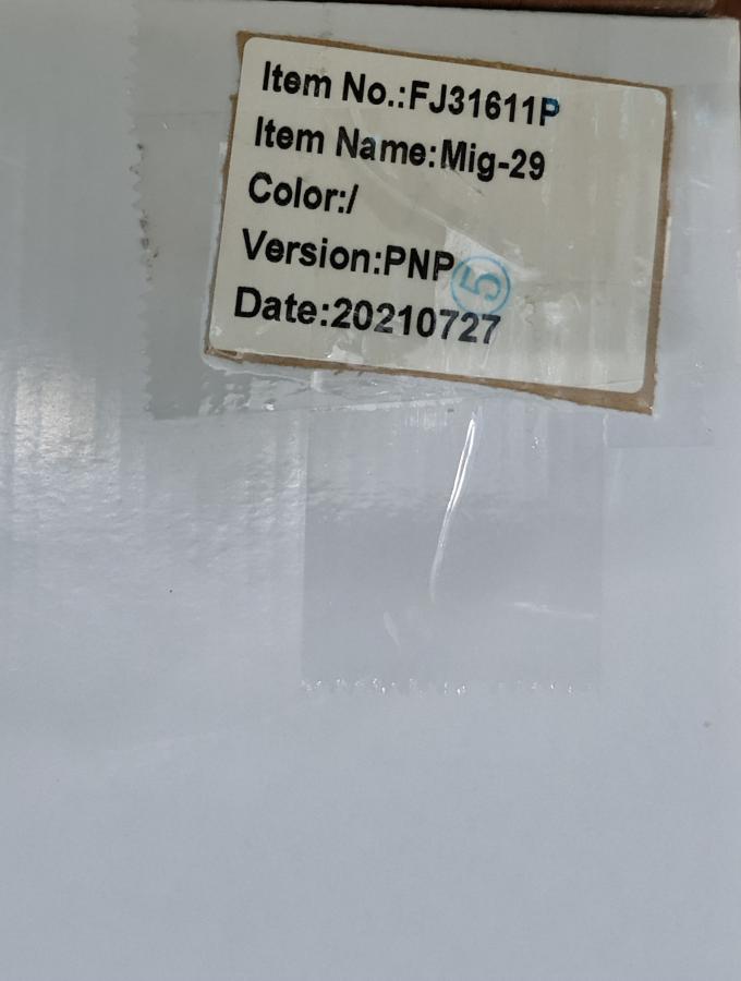

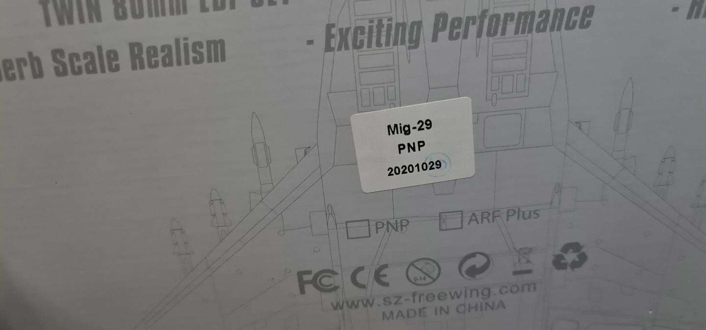

          #5124
          Where are you finding a production date?
          • masterssls1
            • Aug 2021
            • 41
            #5125
            on the box it states the date of production . if u want , when i reach home i can take a picture of it and share it with u

                    • masterssls1
                      • Aug 2021
                      • 41
                      #5130
                      Please, I don't save boxes though I do have a few NIB kits stashed in the attic.
                      here is both of them

                              • 5387
                              #5134
                              Thanks! I remember seeing the dates but I never thought about them…

                                • Tigerman
                                  • 62
                                  #5136
                                  Need to maiden my new Mig 29 but the weather here in the UK is awful at the moment. Is the factory C of G OK and should I maiden it at the mark under the wings or do has a lot of people are telling me to have Cof C about 10mm to the rear of the factory Cof G???

                                        #5139
                                        Originally posted by Tigerman
                                        Need to maiden my new Mig 29 but the weather here in the UK is awful at the moment. Is the factory C of G OK and should I maiden it at the mark under the wings or do has a lot of people are telling me to have Cof C about 10mm to the rear of the factory Cof G???​​
                                        Set it up 15mm behind the wing molded marks and add 3-5mm reflex to the trailing edge of the wing (ailerons/flaps TE UP). I usually do 3mm for flaps and 5 for ailerons.
                                        I do not recommend to venture further aft with CG unless you also install the VT nozzles because recovering from high alpha lock becomes increasingly more difficult and problematic.
