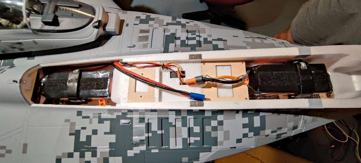

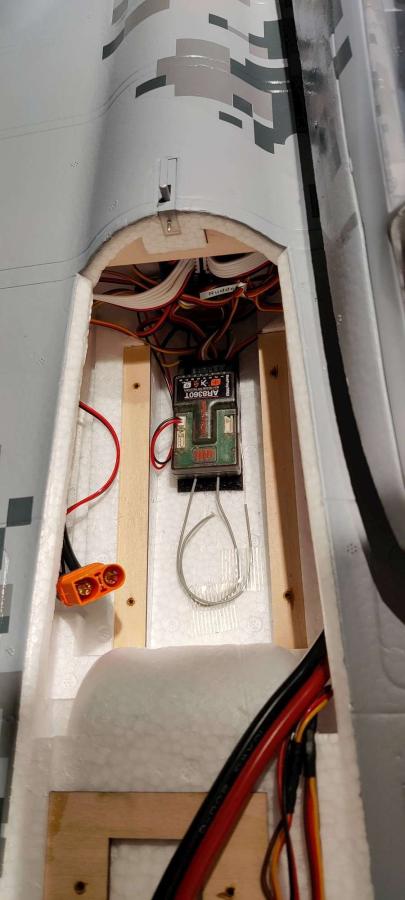

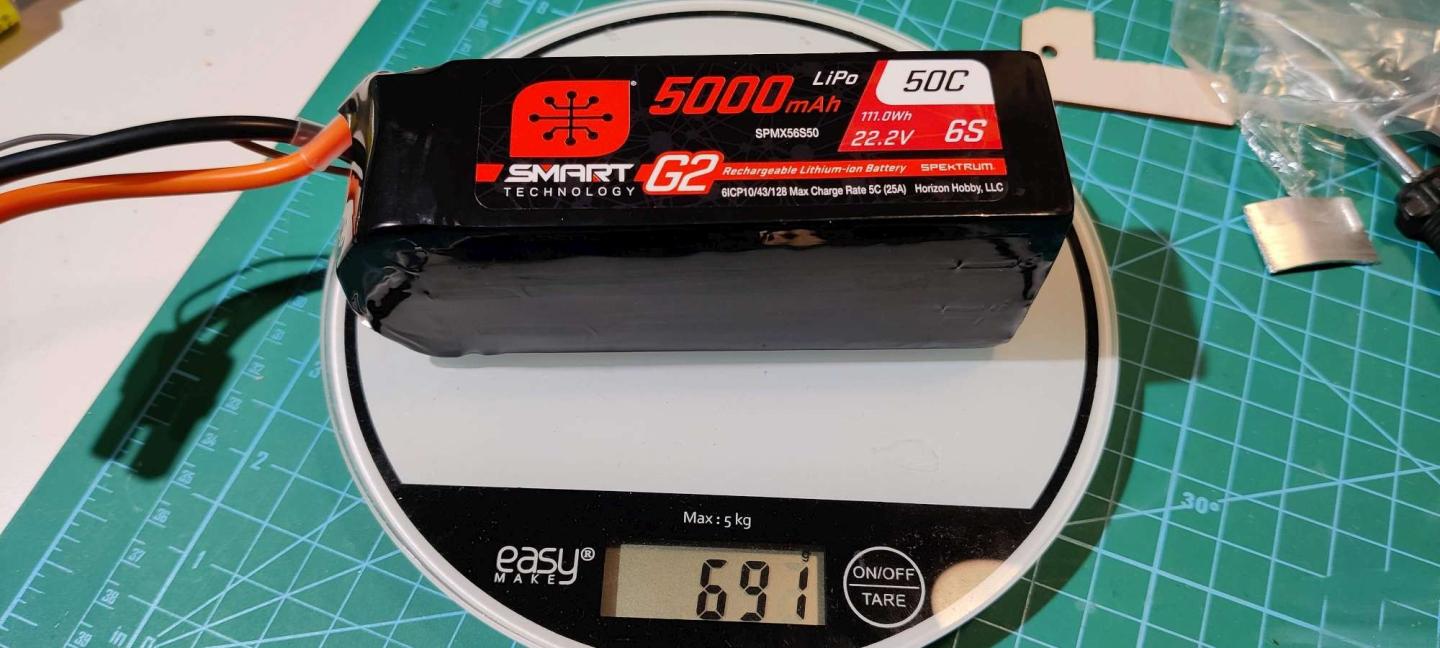

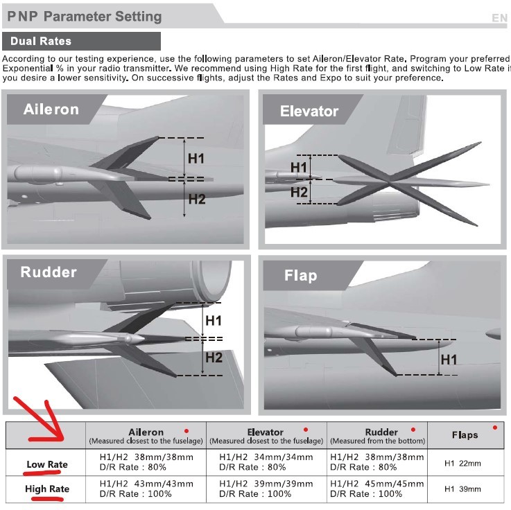

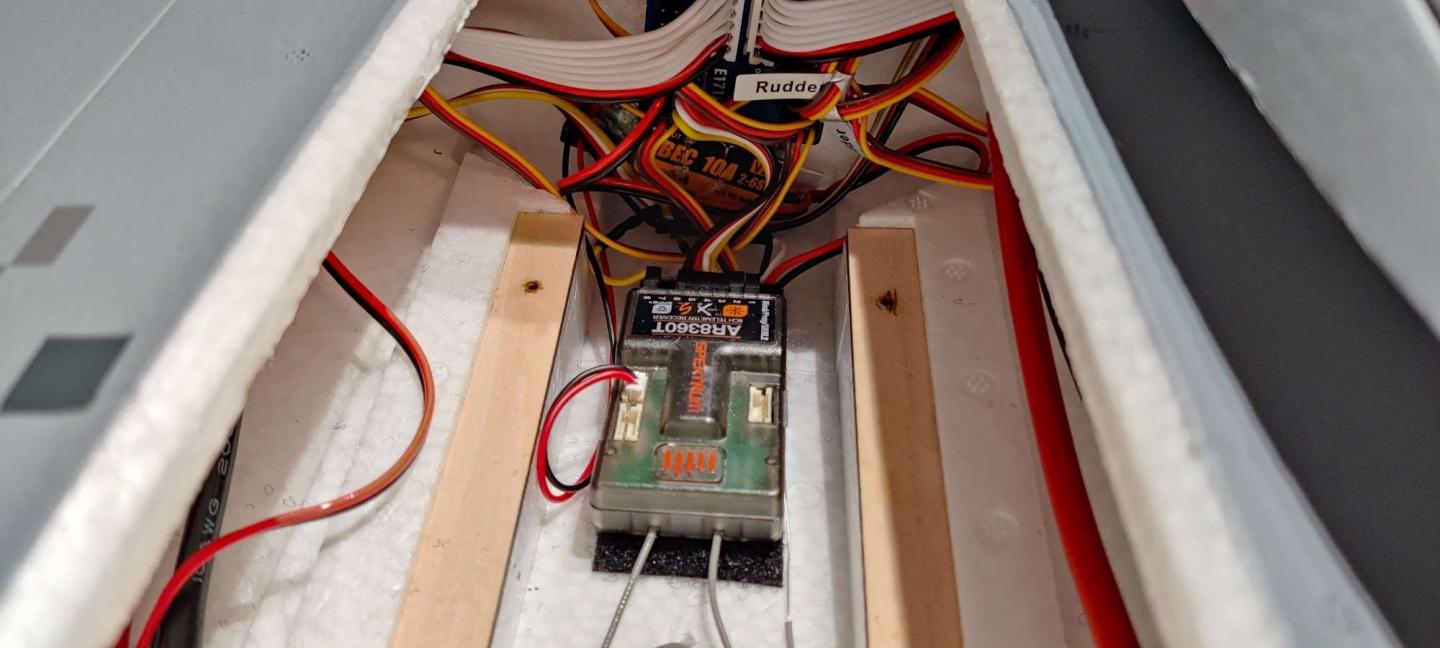

          Hello dear airplane pilots !
          I would like to have your opinions (also look at the pictures), because I am preparing my MIG for its first flight in a few days !
          • To have my MIG balanced on the manufacturer's CG, I must use the second compartment at the very front of the plane. The one in the middle gives me a rear CG. For information I use spektrum 6S - 5000mah - 50C - 690g. I installed the blue box and the receiver under the rear battery plate. What do you think ?
          • Also what do you think of the rates proposed in the manual ?
          waiting your answers,
          Thanks 😁

            #6125
            Definately use forward bay for battery! Learned the hard way, test flight day before yesterday! It did not turn out well! Replacement parts on the way!

                  #6128
                  Yes I used middle compartment on the vt version. test flew other day battery up front, balanced 10mm behind wing cg marks. Nose heavy! nose retract servo took a crap so waiting on new one to come in! will give more updates!

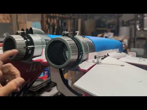

                                          #6140
