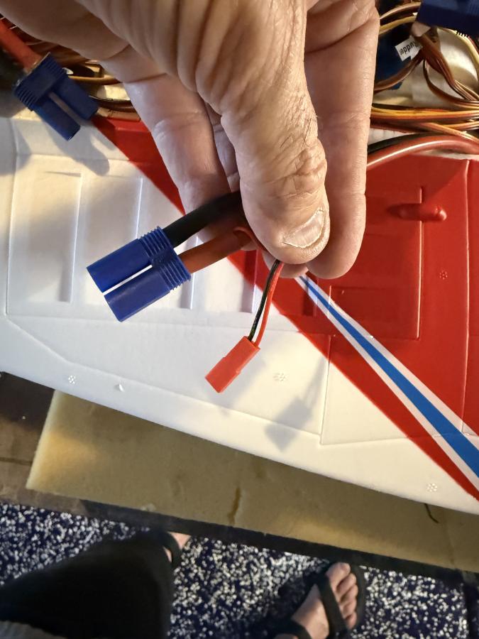

            • Just getting the MiG set up with a10 ch spectrum receiver. Only getting power out of the right side EDF. I have the UBEC plugged into the receiver but the other power lead has the 2 wire, red lead (pic attached)and I’m wondering IFB that needs to be plugged in somewhere. Sorry if this is a noob question but it’s my first twin jet

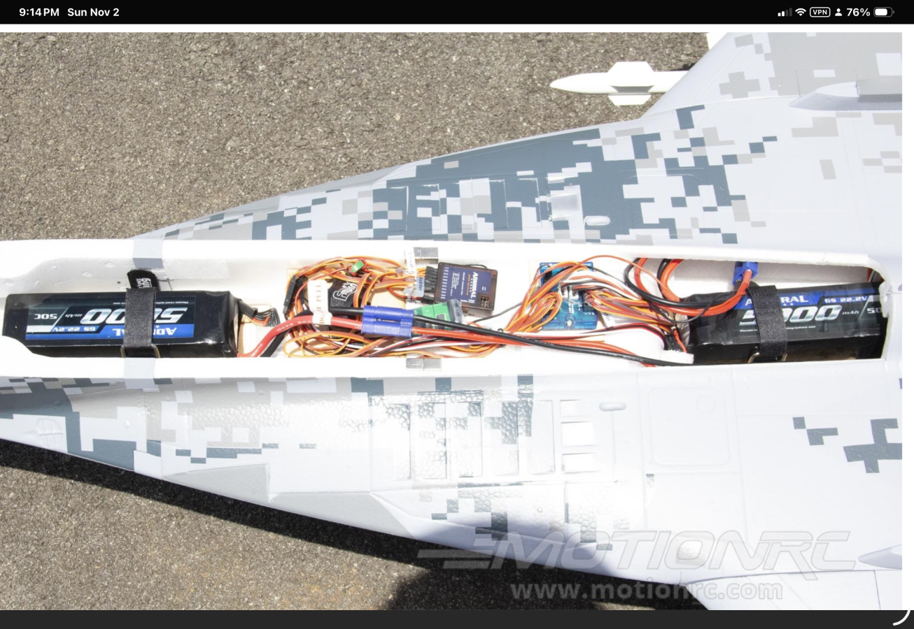

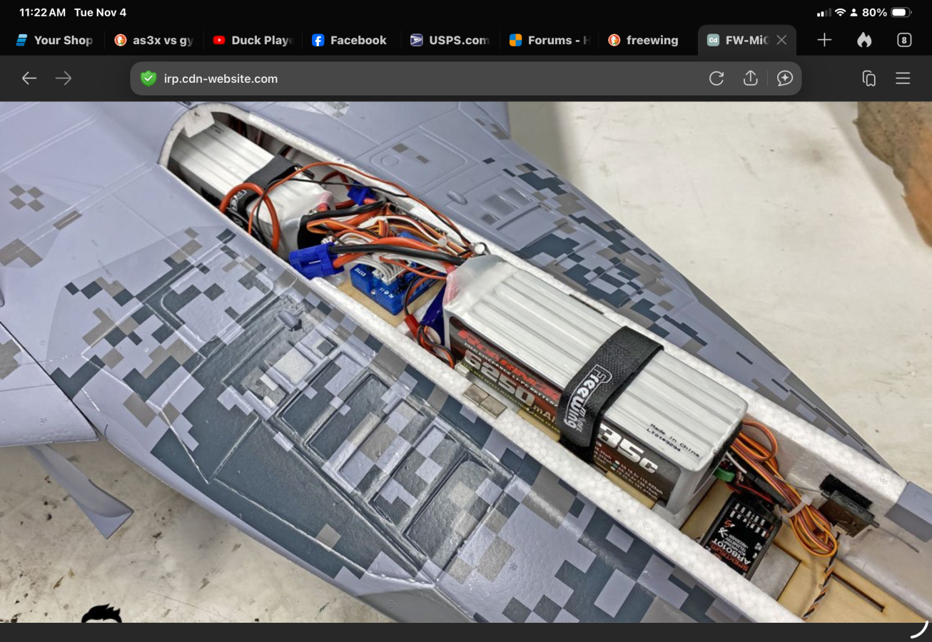

                          Hello. I was just wondering what the preferred battery layout is. i’ve seen these two posted obviously keeping CG in mind is there a preferred positions for the batteries. ill be using 6s 6000 packs. The forward and rear would work best for me just wondering what people are doing with there’s with best results for scale and high speed pass flying.
                          Thank you
                          • For the weight of your batteries mid and rear.
                            • Thanks for the reply. So if i understand you if i use 6000 mid rear. if i went to 5000ish i could use the front and rear? i’m relatively new to edf and electrics coming from large scale gassers. Does the weight of the extra mAh basically zero out extra flight time of the smaller packs. Thanks
                              • If you have light 5000’s yes. And prefer a more tail heavy plane…

                                    I have the vectored thrust and my 5900mah packs weigh 750g. I have to use front and rear trays to be 25mm aft of the CG marks.
                                    in answer to the second question, the plane can handle a wide range of lipo sizes and the extra mah will give longer flights. If you went large enough to dramatically notice the weight increase, the packs would not fit in the model. The reason for this is heavy packs would mean having to use the mid lipo tray and then they become difficult to actually mount without removing lots of canopy foam.
