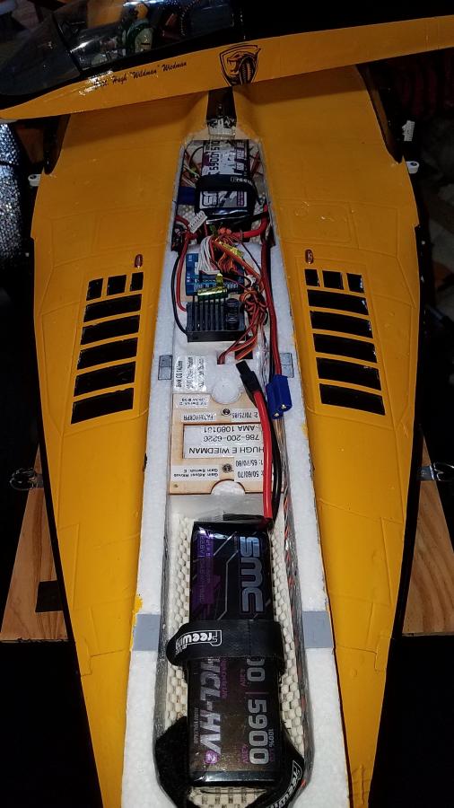

        Yes, two of these.

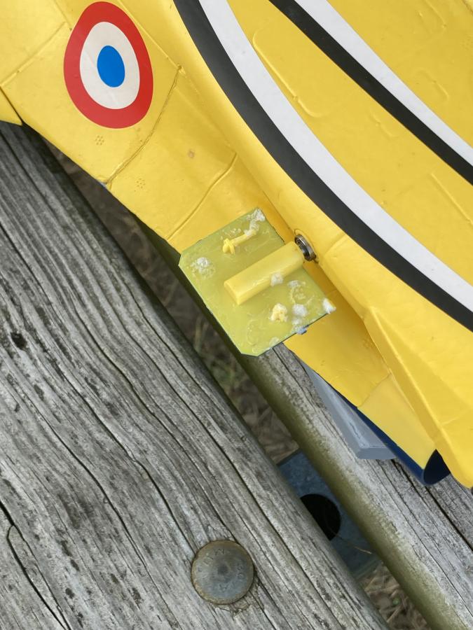

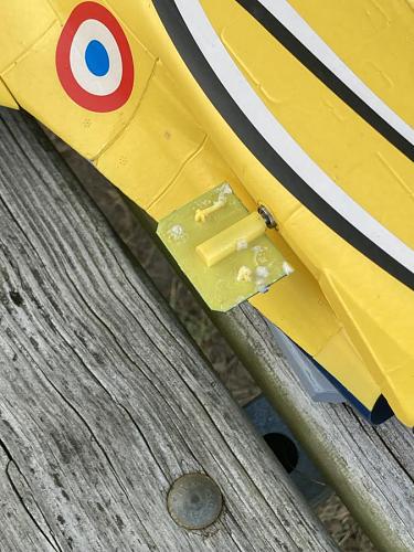

            Glue is expensive, apparently. Canard detached from my Rafale yesterday. Fortunately no crash ensued.

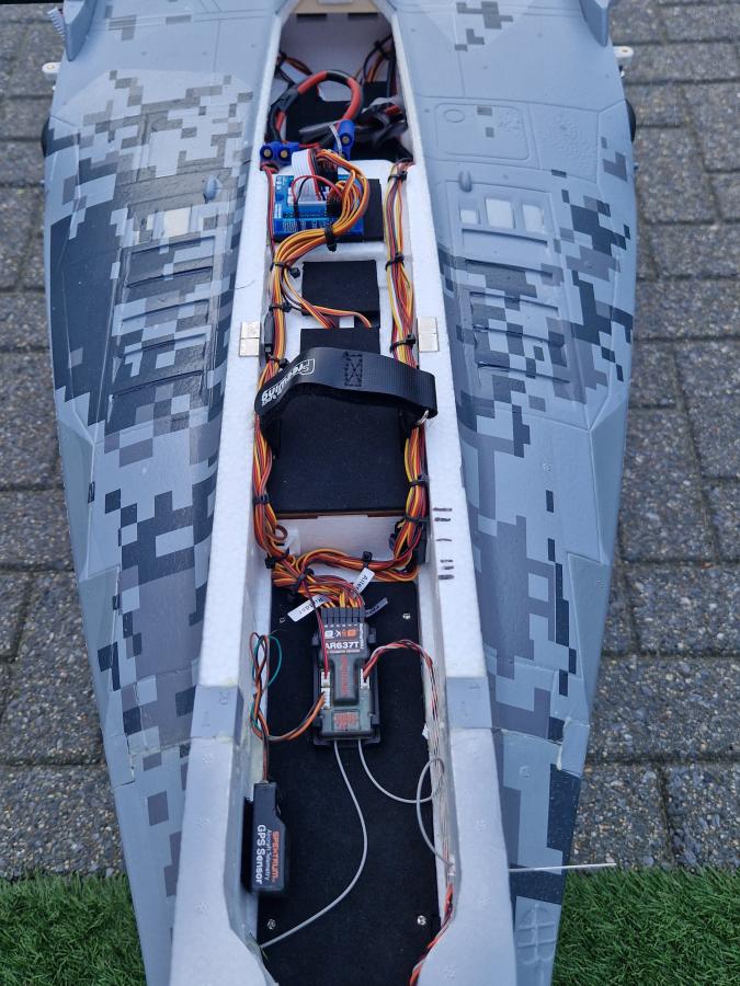

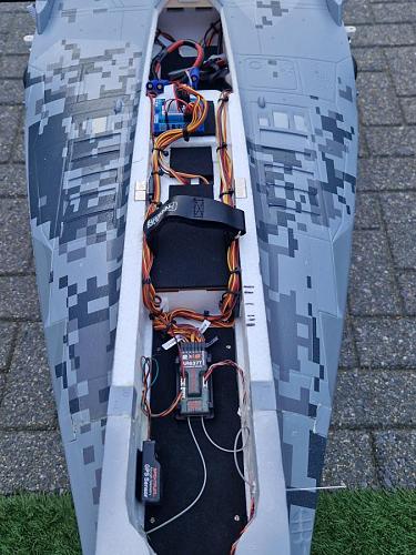

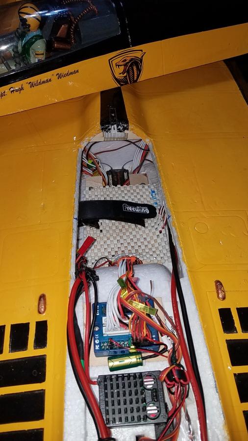

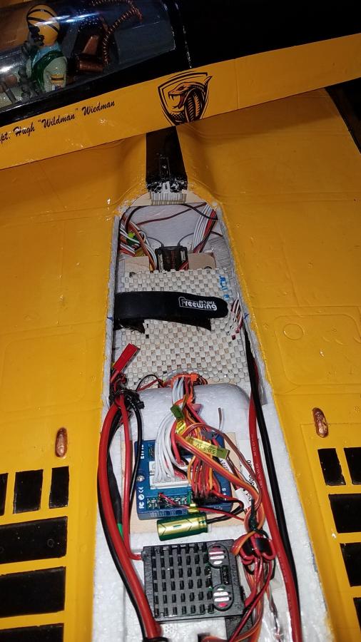

                            Spaghetti is gone 😁🍜

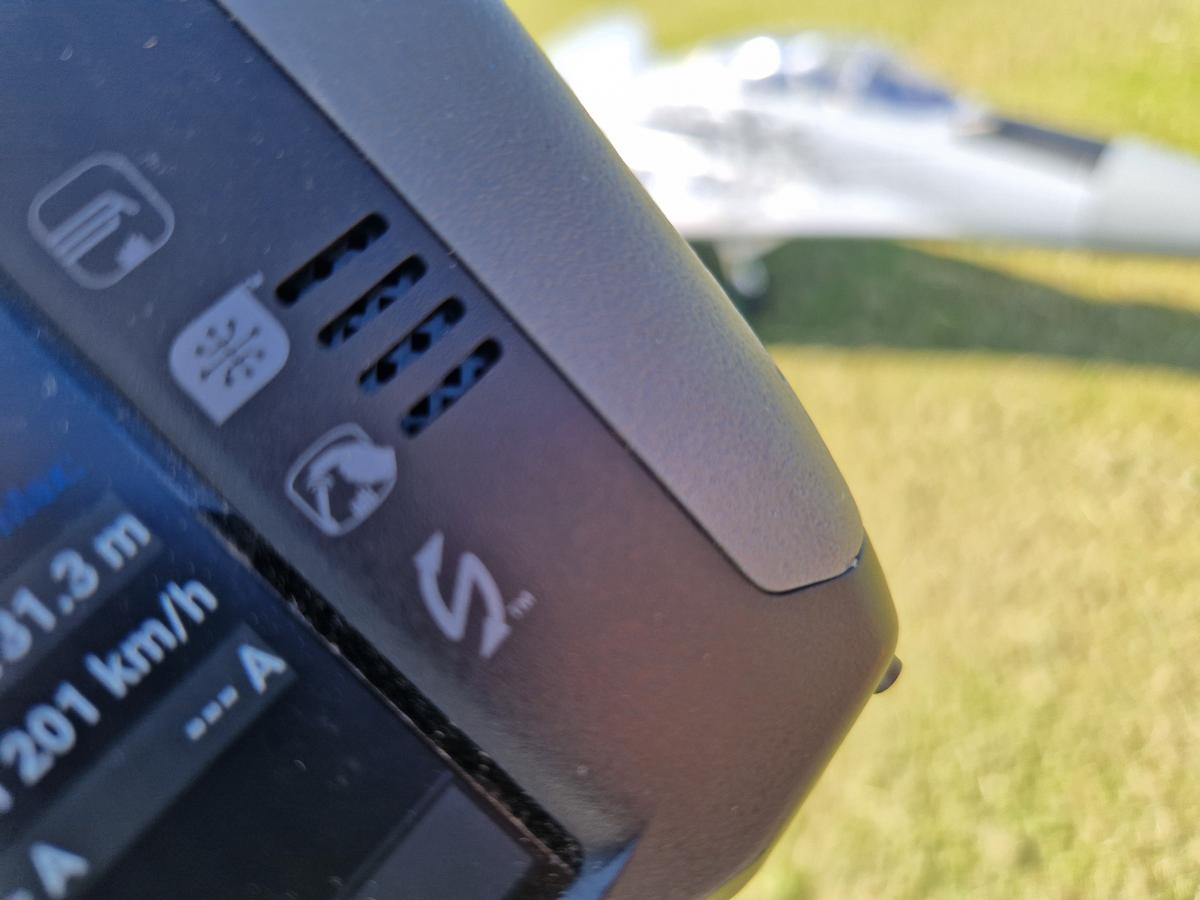

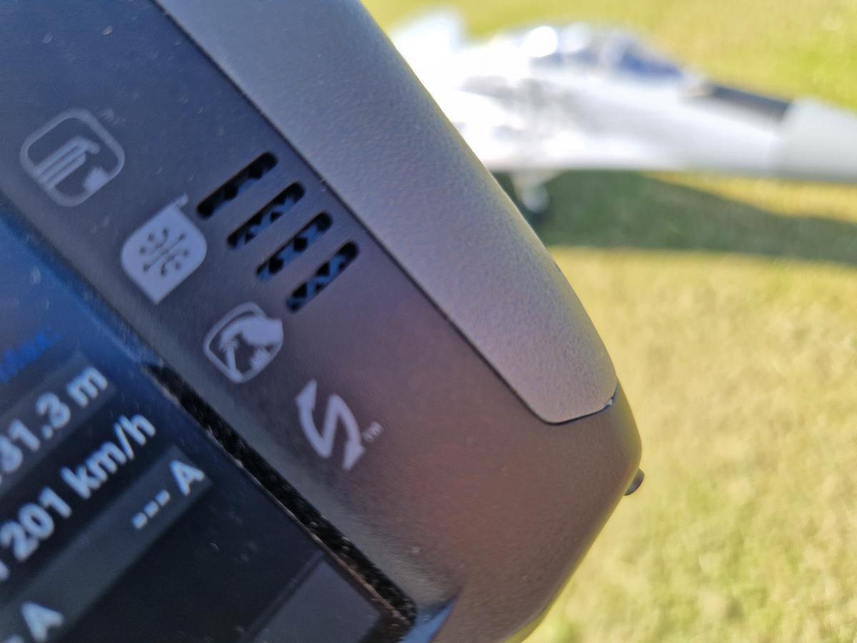

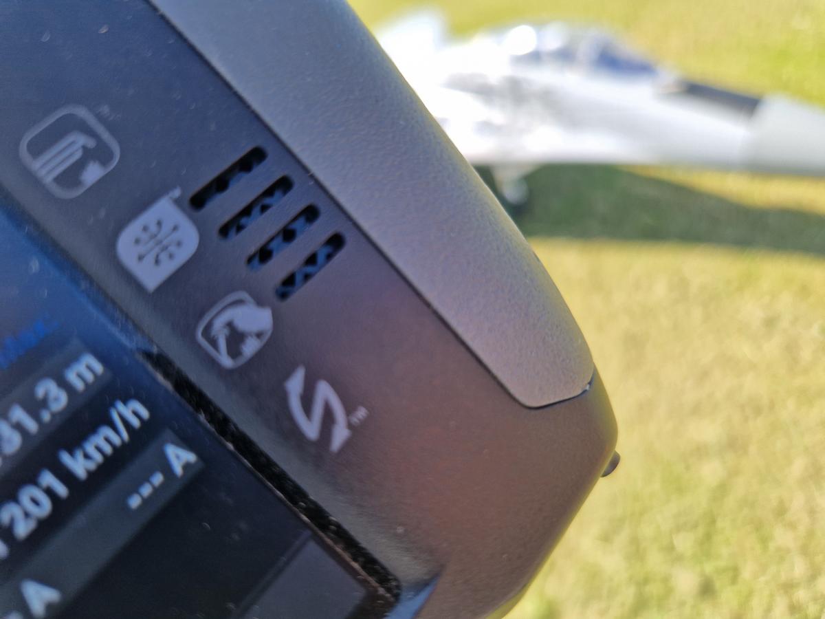

                            200kmh in Level Flight
                            Measure with spektrum GPS Sensor
                            don't now how accurate it is

                              MetallDanny, Very Nicely Done, Sir. :punch: Best, LB

                                MetallDanny,​ nice job on the wiring.

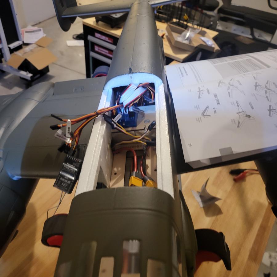

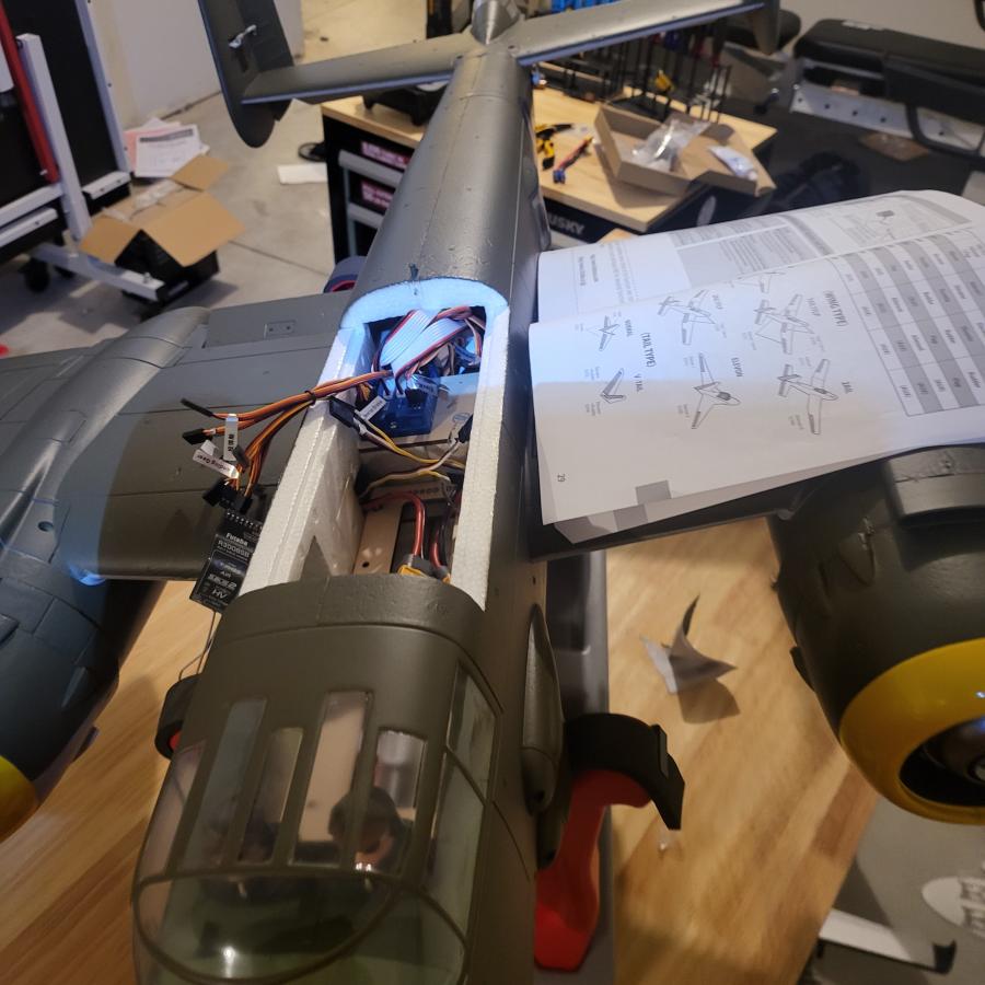

                                  Hello, of course im new. I have a mitchell b25 bomber from flightline. Im trying to put the reciever in but i cant fivure it out. I have a futaba r3008sb reciever but my manuel for my radio doesnt give where to plug everything. Can you help please?
                                  • Mouken
                                    • Jul 2024
                                    • 5
                                    #6117
                                    This is what im working with

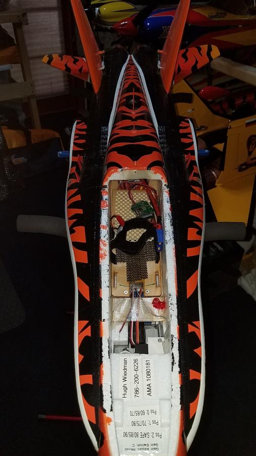

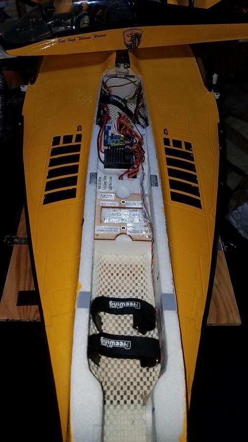

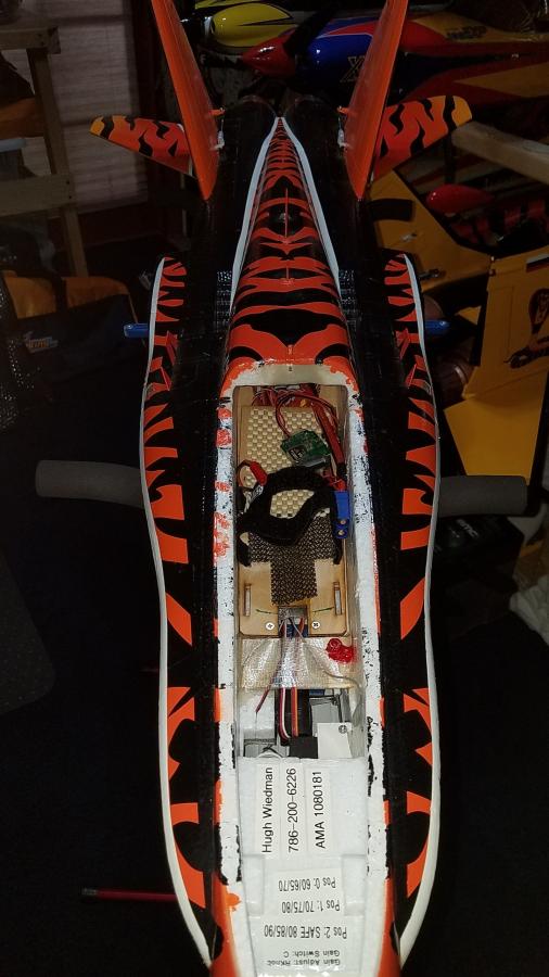

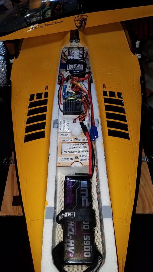

                                          Nice wiring, until they come up with wireless servos and on board Wi-Fi, the "spaghetti" wiring demon will continue to plague us all. :face_with_symbols_o Some time ago, Jandro ( Airguardian ) had suggested in this forum to locate the RX under the "floor boards" to help alleviate some of the mess in wiring. Obviously I follow all of his suggestions faithfully and did just that on my Mig and F18. The only negative is the reduction in cargo space for my hidden on board illicit contraband. The AR 10360T is under the back battery tray and I also installed a Hobby Eagle gyro for the TV nozzles back there and off to the side. A remote satellite is located up in the nose as well. I was able to place the 2 SMC HiV 5900 batteries with one all the way back and the other in the front bay, with the Castle 20amp BEC in the middle, and still get it to balance at least 25mm behind recommended CG. Maybe the extra weight in paint , TV nozzles, afterburners, 3D printed nozzles and relatively light weight of those packs allowed me to use the front and back bays and still get the CG I wanted without adding any tail weight.

                                          One of my F18's with the RX under the tray, satellite way in the back.
