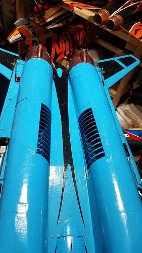

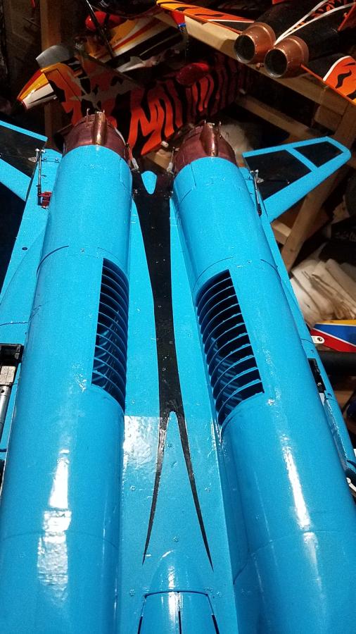

            added about 400grams static thrust

              looks like a lot of material to remove.did you add anything to strengthen the front of the plane?

                by the feel of the plane i don't really think that you would need to do so but i reinforced the louvres with a 1mm carbon frame

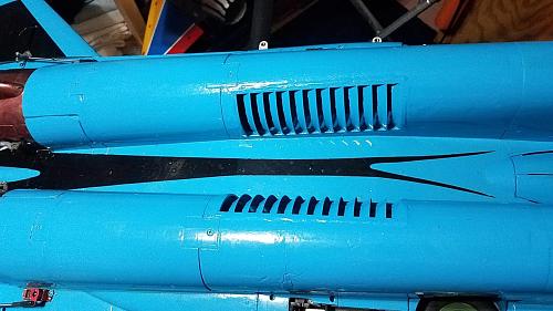

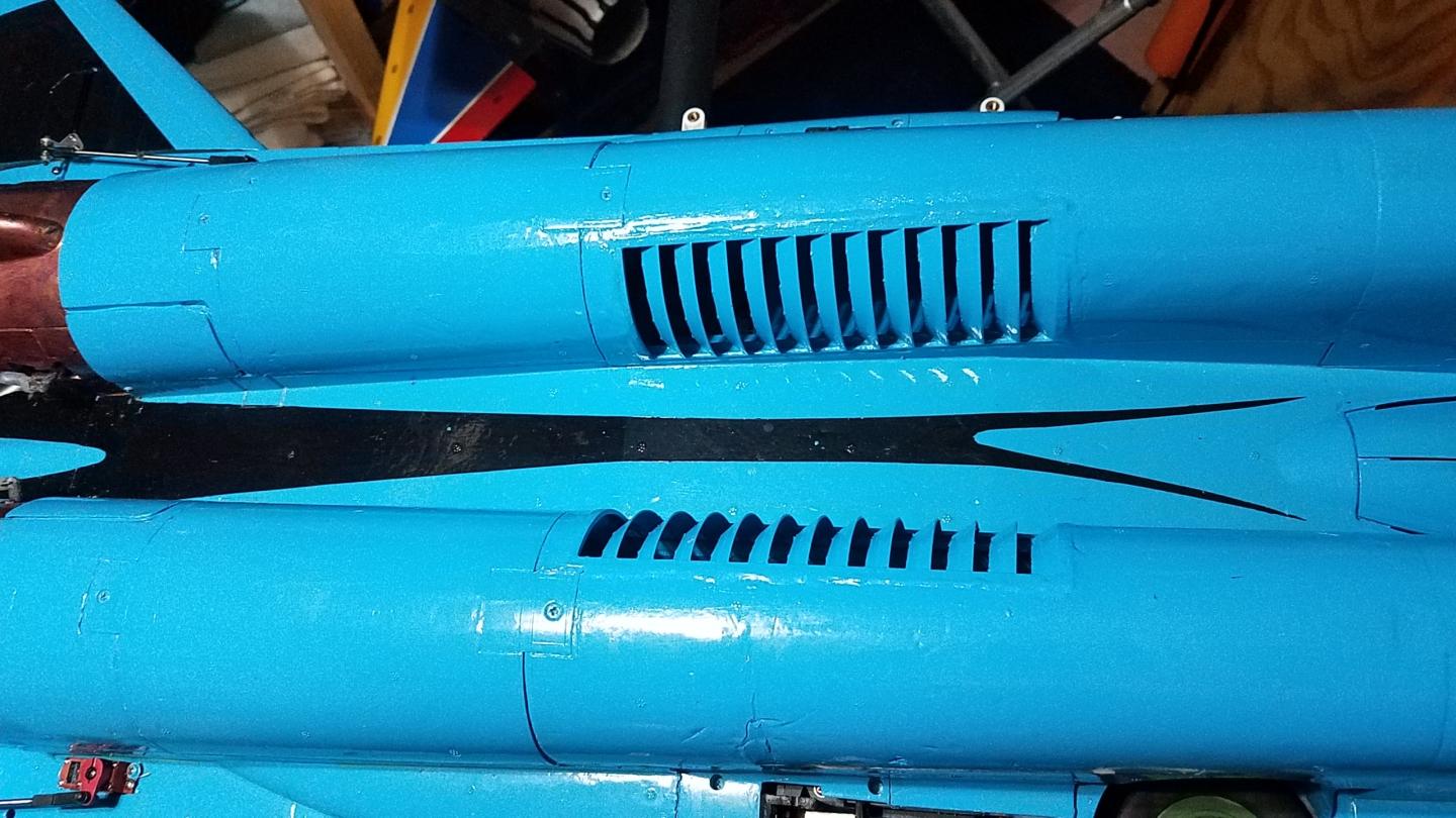

                  I got similar results with the louvers designed by one of the posters here earlier, forgot who already. :rolling_eyes: I'm also using the FMS 12 blade 3280-2100Kv inrunners.
ID:	393028 Click image for larger version
