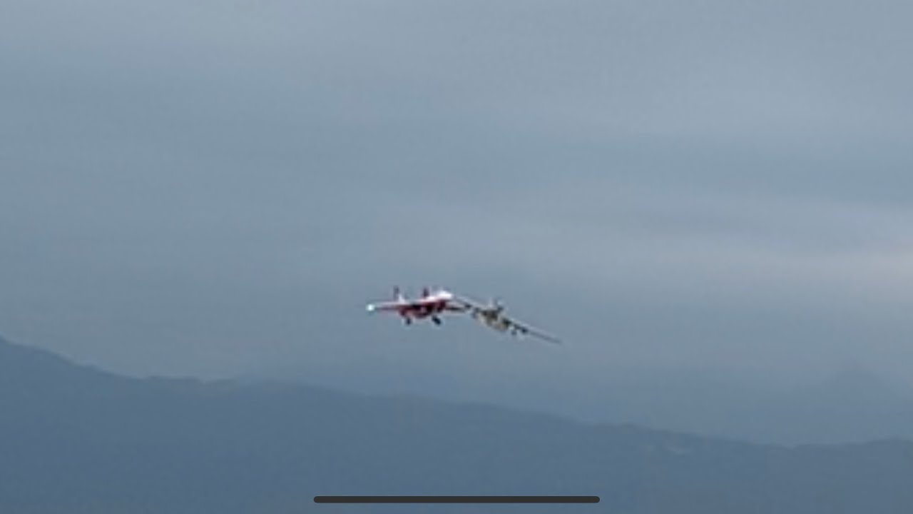

    Another MiG29 goes down. This time one of the new "Red Stars". What's with these guys? Even before the mid-air touch, it was a flying roller coaster. (I don't think the mid-air did any damage.) They don't seem to know how to set these things up or know how to balance them or they just don't know how to fly them. The MiG wasn't the only "roller coaster" out there. Many of them were going up and down like a yoyo.

      A lot of interesting things happening. First they post a lot of videos and there is typically a high percentage of flying "issues" at that site. Many of the planes dis not look set up well, too much pitch or other axis authority. Then flying large and small EDFs and a bush plane together. At the end it looks like the person was in semi alpha lock.
      If you remember, when the MiG first came out they lost a few. I said then it looked like they didn't know there were three places for batteries and used the forward and aft ones making their planes very nose heavy causing issues. This looks surprisingly similar to that but with TV to further mess with controlability.

                      Hard to say but it looked like alpha lock followed by a helmet fire.
