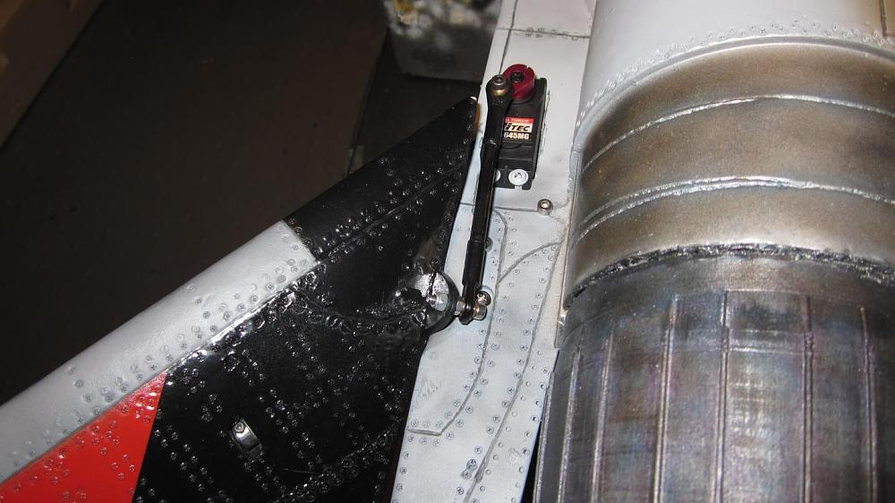

        Your airbrake set up is very intricate. I don't have the talent to do it. I was hoping that Motion was going to bring out the airbrake kit when they brought out the vector thrust nozzles.
        Do you know if the airbrakes actually help reduce the ground roll after landing? Being such a heavy plane, my MiG rolls "forever". Airbrakes or reverse would really be of help.
        Hi I don't really know yet if they do slow down the plane, but I would think down to a certain speed they would. She hasn't flown yet, that day was for pics and runway tests. My intensions are more for inflight use of the brakes (we'll see). It has nothing to do with talent it is just about patients making mods like that (about two weeks from the idea to finish, same with the cockpit ore the elevators)

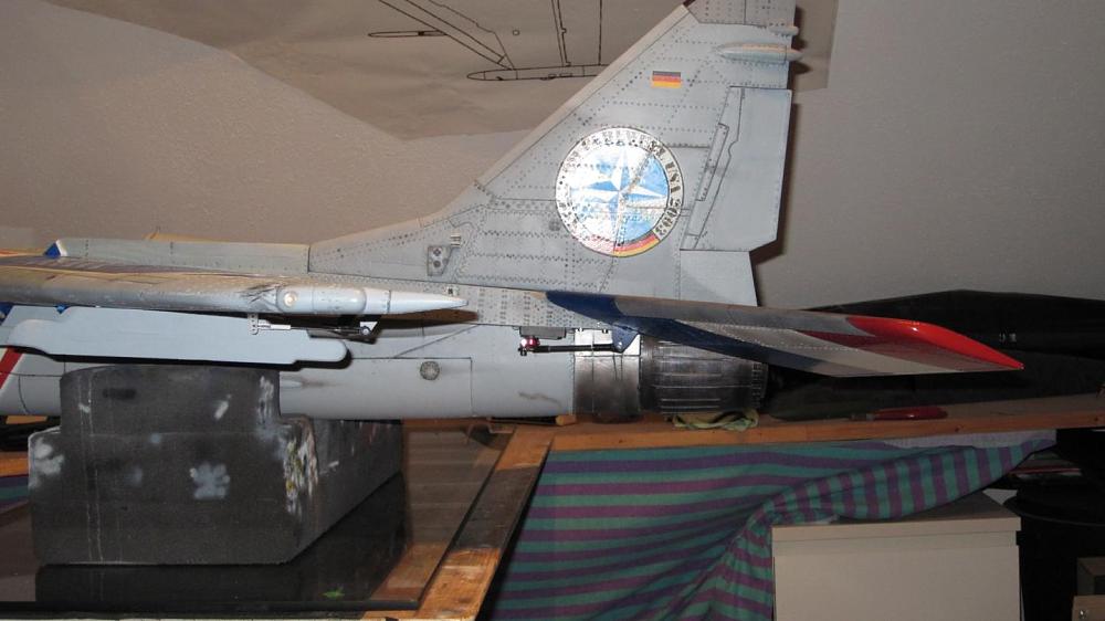

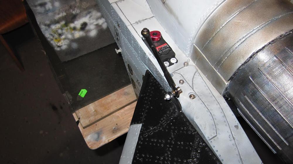

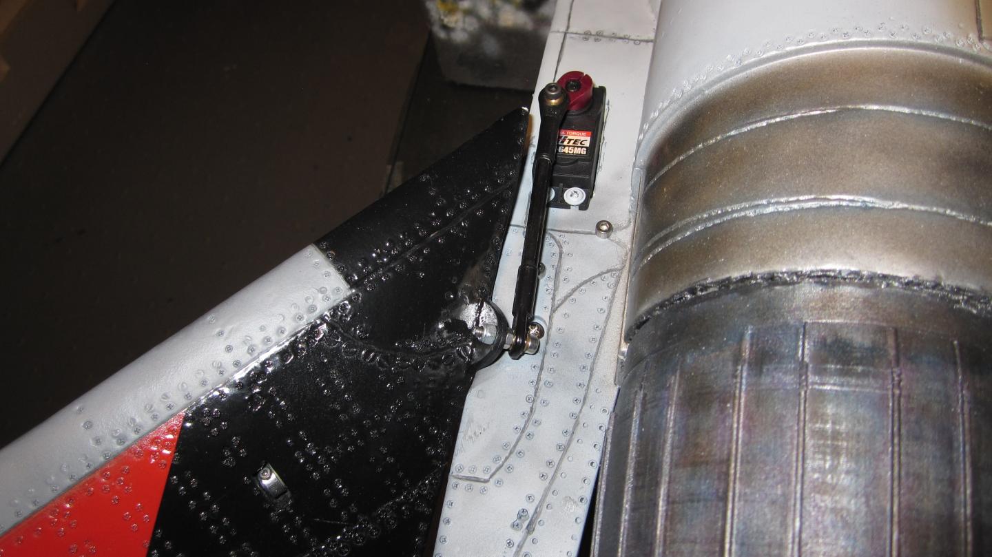

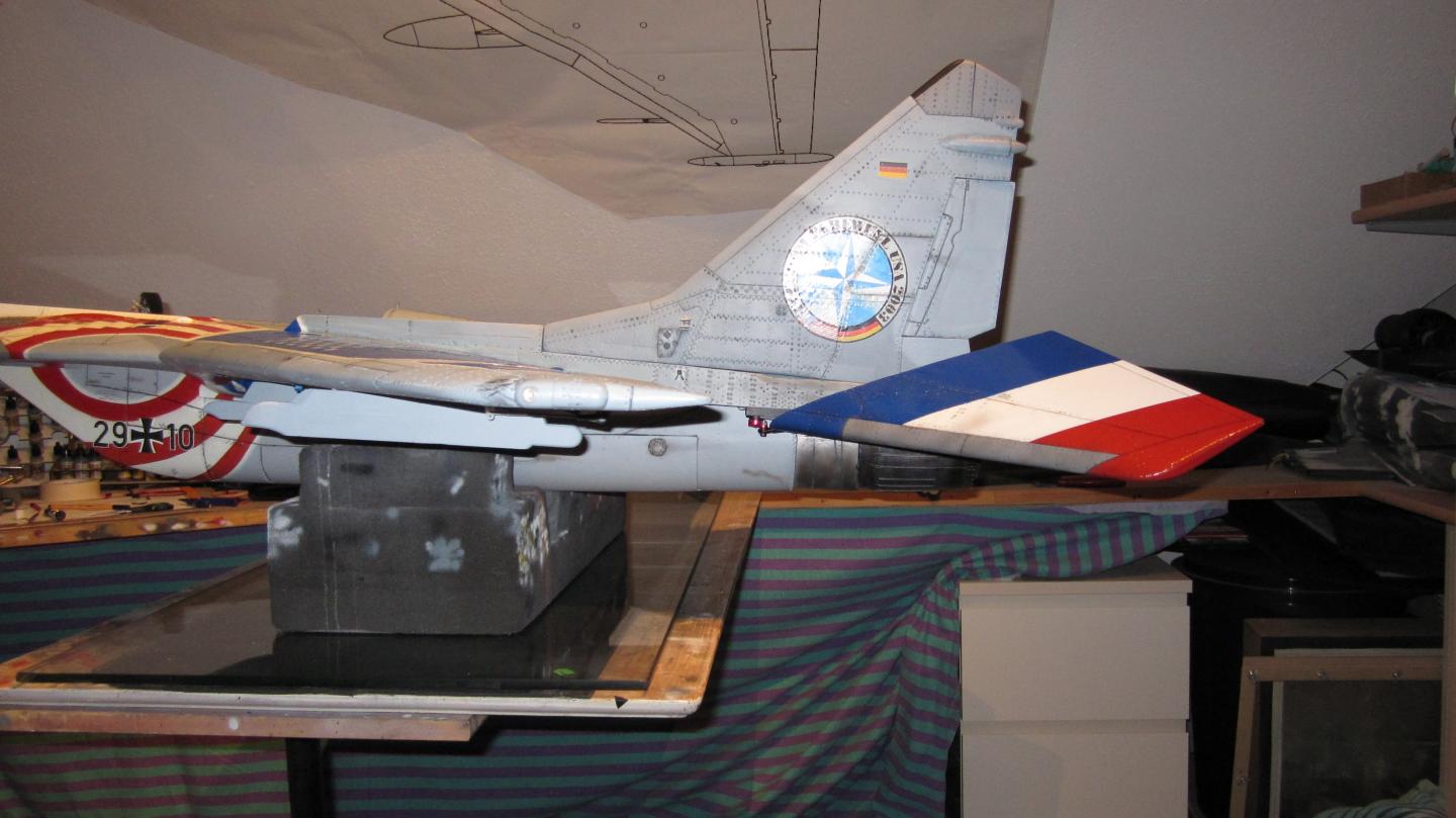

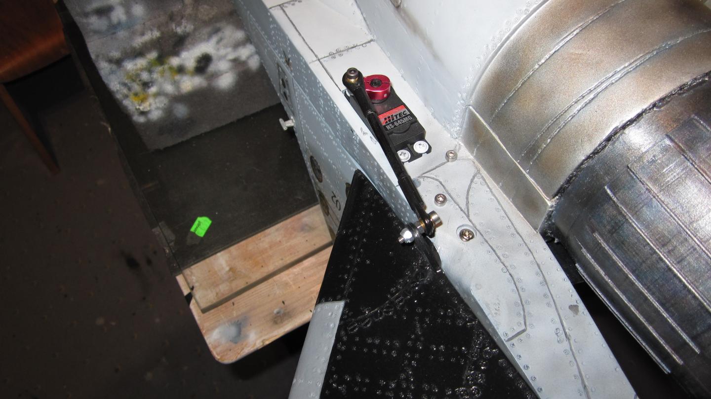

            Originally posted by heisteff
            the white stick shows just about the correct lenght of the axle. hope it helps
            Outstanding work!
            Now the stabs deflect in a proper scale fashion!
            Could you please send some pics of the model with the stabs deflected pitch up and pitch down? :D
            That configuration should indeed reduce the stress translated to the airframe, the stress seen by the own stab and the torque around the shaft that a servo would have to overcome. But since you didn't change the servo angle and it still actuates parallel to the airplane's longitudinal axis, that kinda spoils the mechanical advantage of having the correct scale axis.
            Ideally the servo linkage should act perpendicularly to the shaft. That said, the whole thing at least should translate to a more robust construction, more scale looking and more accurate flight dynamics to the full scale jet :)

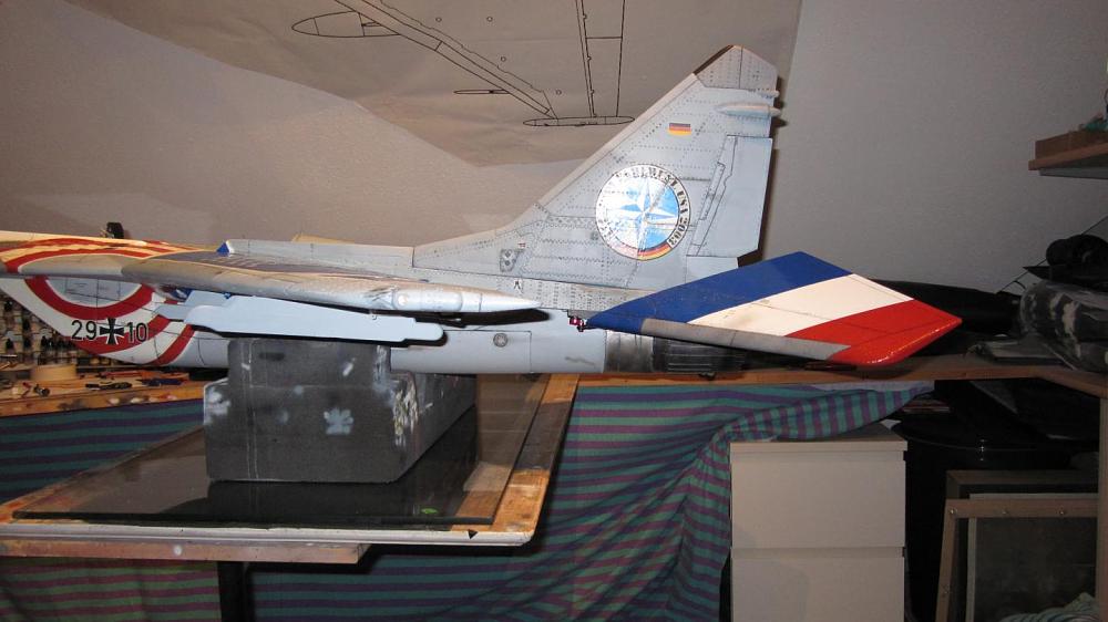

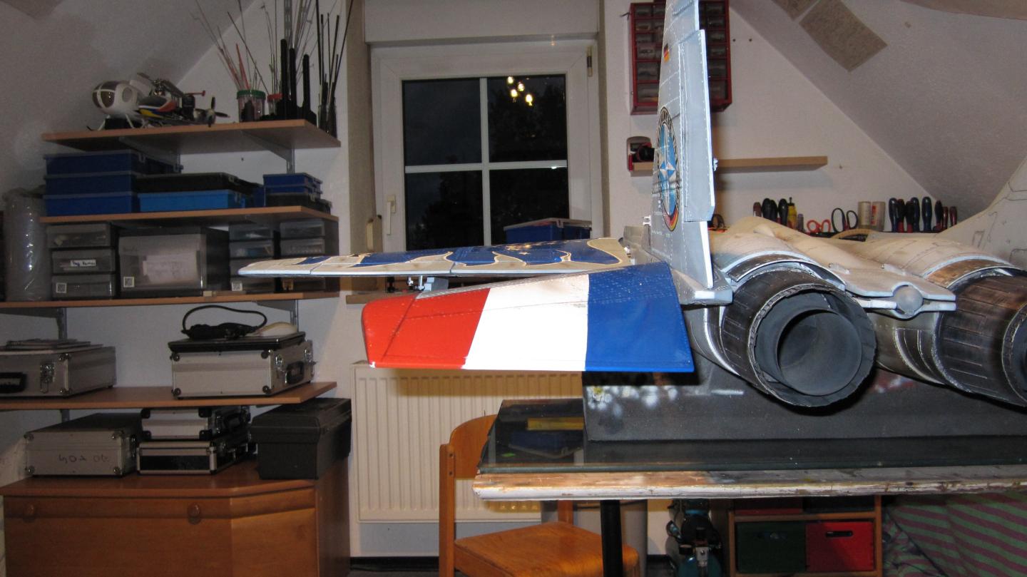

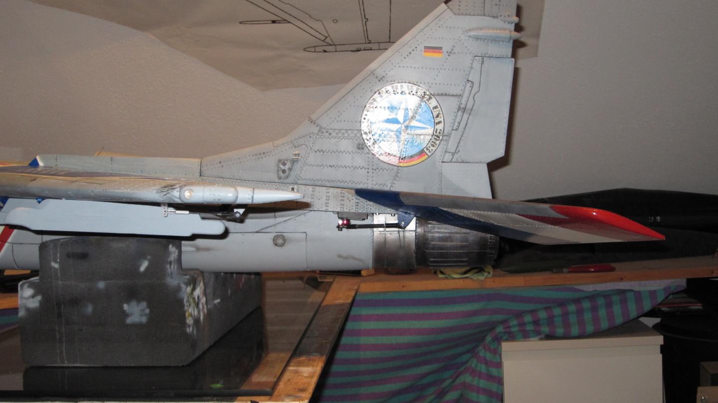

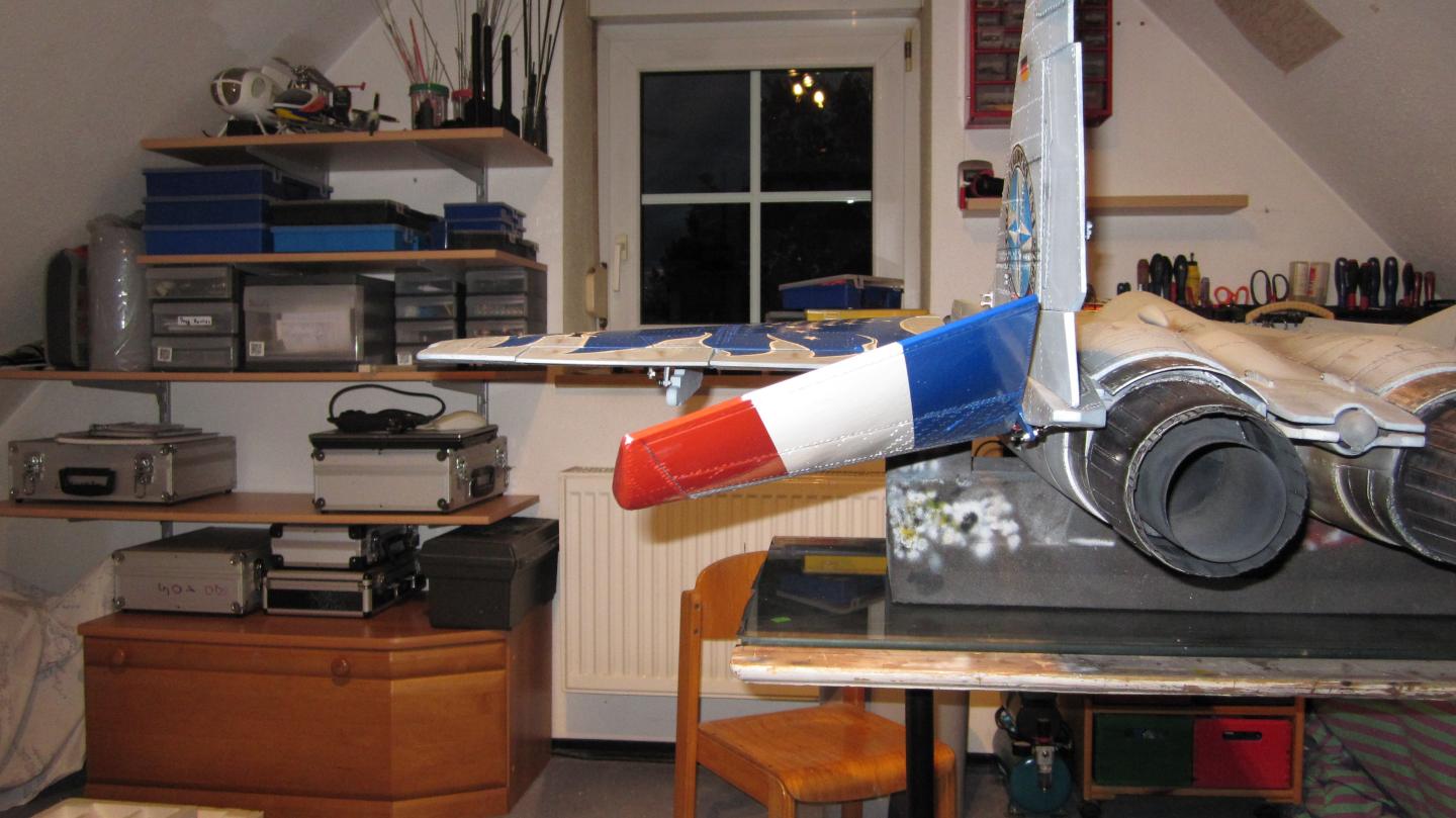

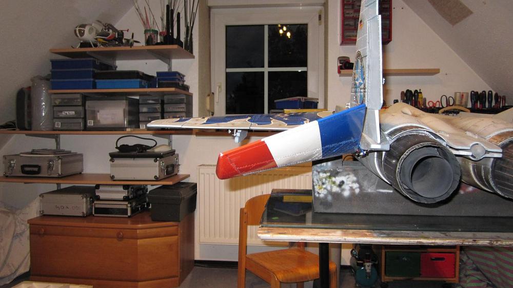

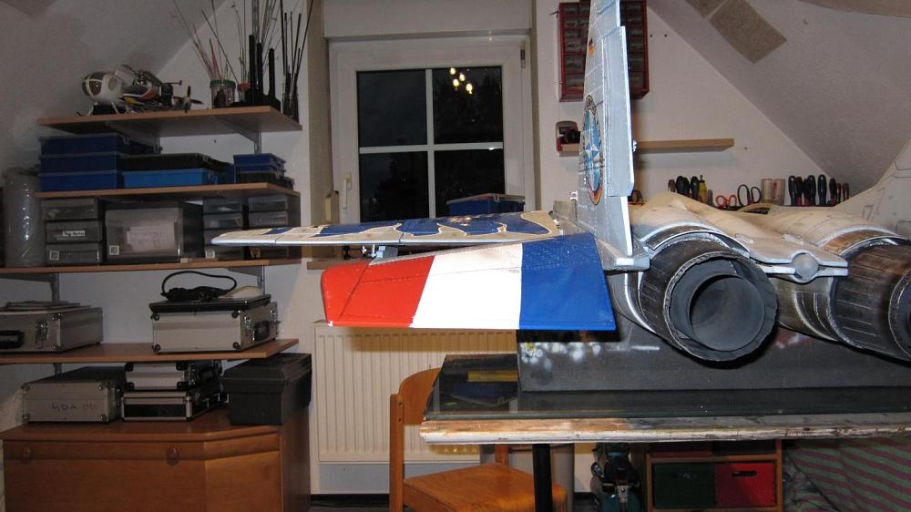

              #5686
              Hi
              here are some pics of the stabs (maximum deflection/way to high for in flight of course). yes the servo is not positioned optimal, but the problem is the space in the tailsection, the two balllinks help a lot to keep the "pushforce" straight (see pics). For the maingeardoors i have not had a idea to make it work without "wheelscratching" them, but who knows.
              Stefan

                #5687
                Outstanding work!
                Almost - there's some anhedral to the stabilators, too.
                There's a "stump" portion towards the front to provide clearance due to this angle.

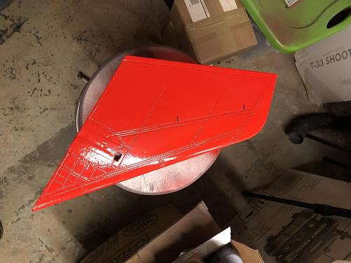

                    Well I finally decided to go ahead and get one. After getting it out of the Box and Inspection done. All I have to say is What did I wait so long ?? Plan on painting this one RED' WHITE & BLUE. I have already started sanding the horizontal stabs
                    • Wild Man
                      • 527
                      • Rapid City, S.D.

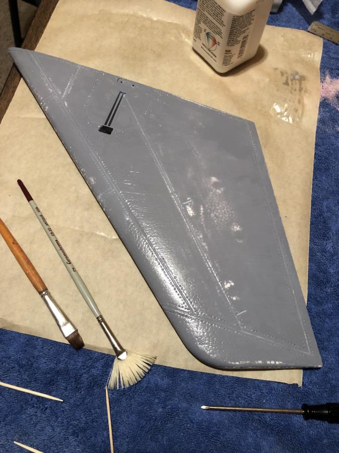

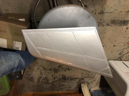

                      #5690

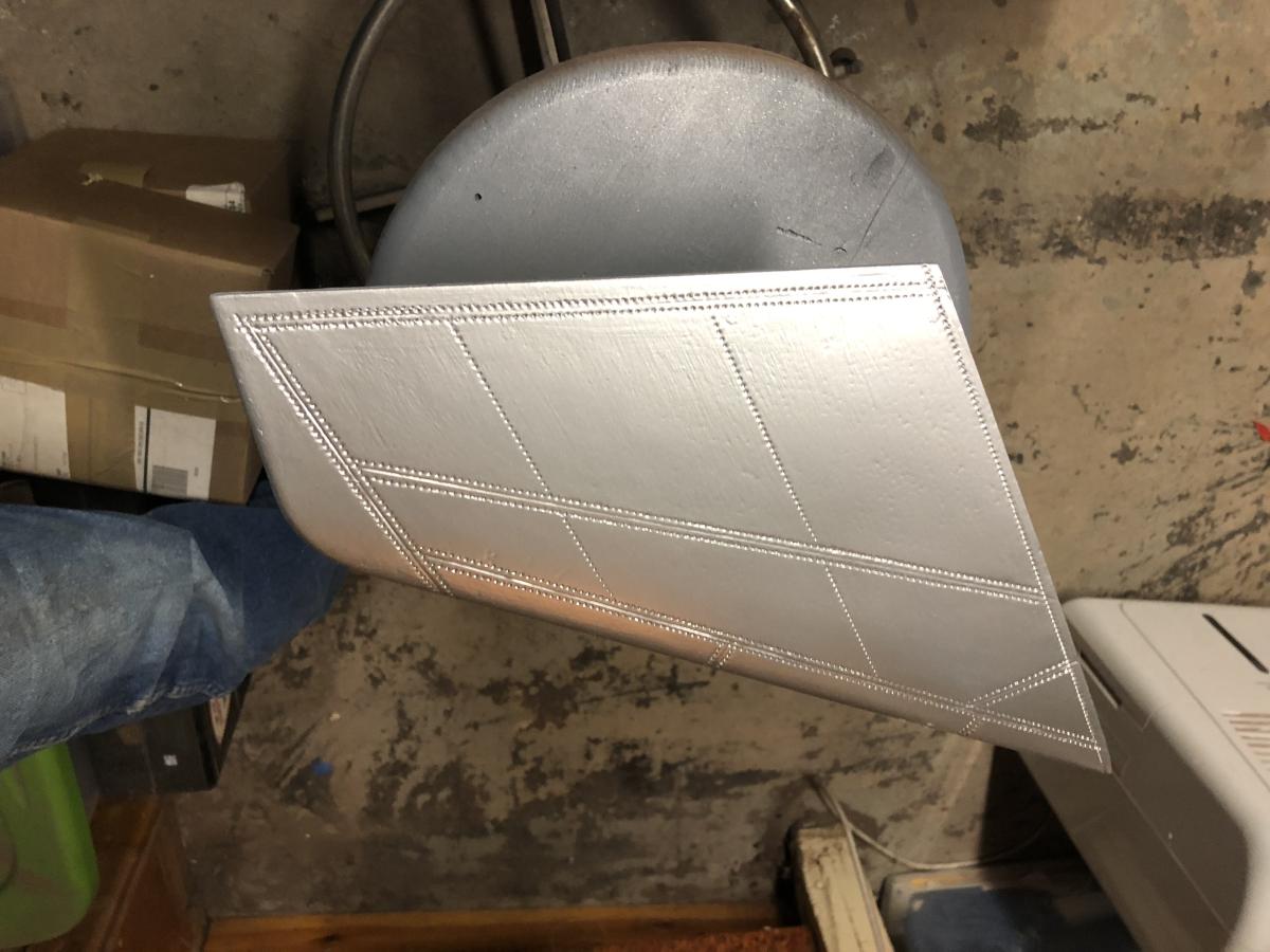

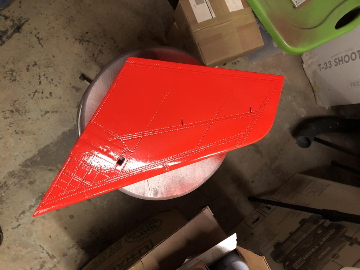

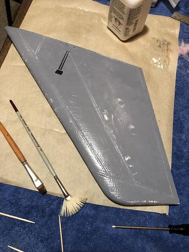

                      I knew if I started, I would be up all night. I started with the tail, ( Horizontal stabilizer's ) So far, so good. I was up all night.
                      Click image for larger version  Name:	D2C1B007-752F-48E9-BF8D-0ADA54607F9C.jpg Views:	0 Size:	102.6 KB ID:	361603Click image for larger version  Name:	1A45CA37-9735-4533-B484-36FFBA7B983C.jpg Views:	0 Size:	104.5 KB ID:	361604Click image for larger version  Name:	4B03AD20-4FB0-4969-BE60-20EFC641EB5E.jpg Views:	0 Size:	88.1 KB ID:	361605

                                  #5696
                                  Couldn't want a better image than that to see why the elevator servo loads are high on this model.

                                      #5698

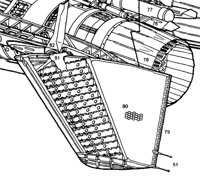

                                      Kallend So you tell me?How does .008 kg. going to raise the load substantially on the new heavier servo's for the horizontal stabilizers? Stock stabilizer .058 kg. Sealed sanded and painted stab. .066 kg. That is only an added weight of the finished stab just a tad over 1/4 oz. by .003 kg.
                                      • HangarQueen
                                        • Feb 2019
                                        • 142
                                        #5699
                                        I think (I'm sure) he's referring to the position of the axis of rotation, so far forward, i.e. there's a LOT of surface behind the rotation point, requiring very high torque from the servo to move this surface.
                                          • 5426
                                          #5700
                                          Exactly. He's not talking your paint, he's talking the pivot point. And use grams instead of minute kg.... 0.003kg is 3g.
