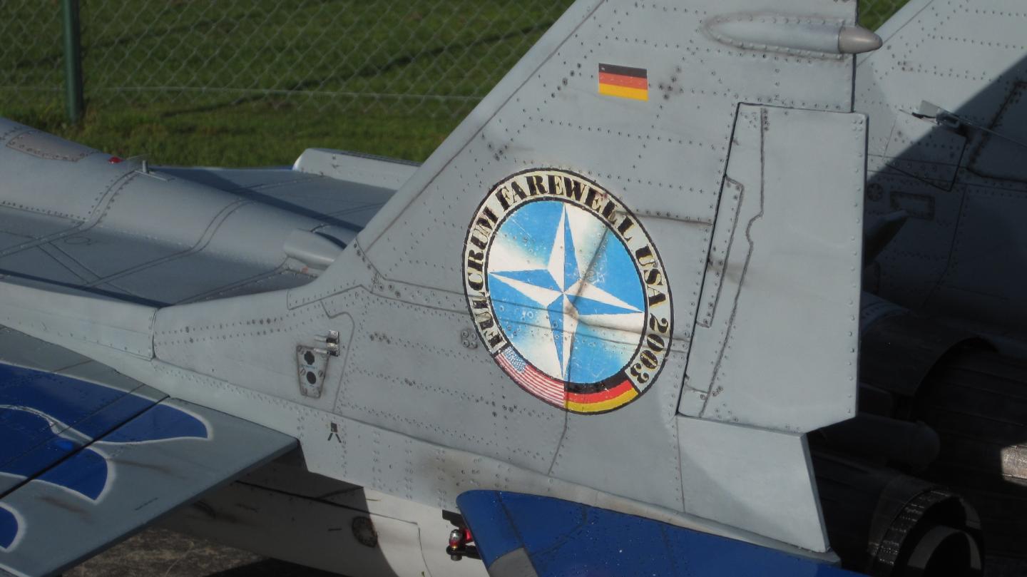

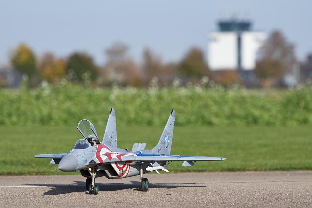

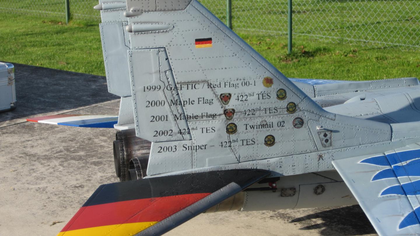

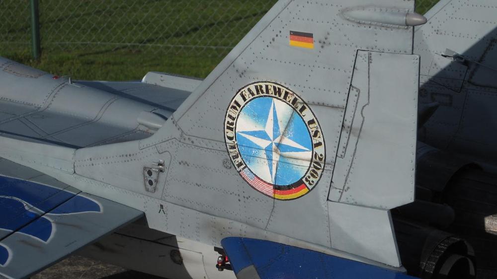

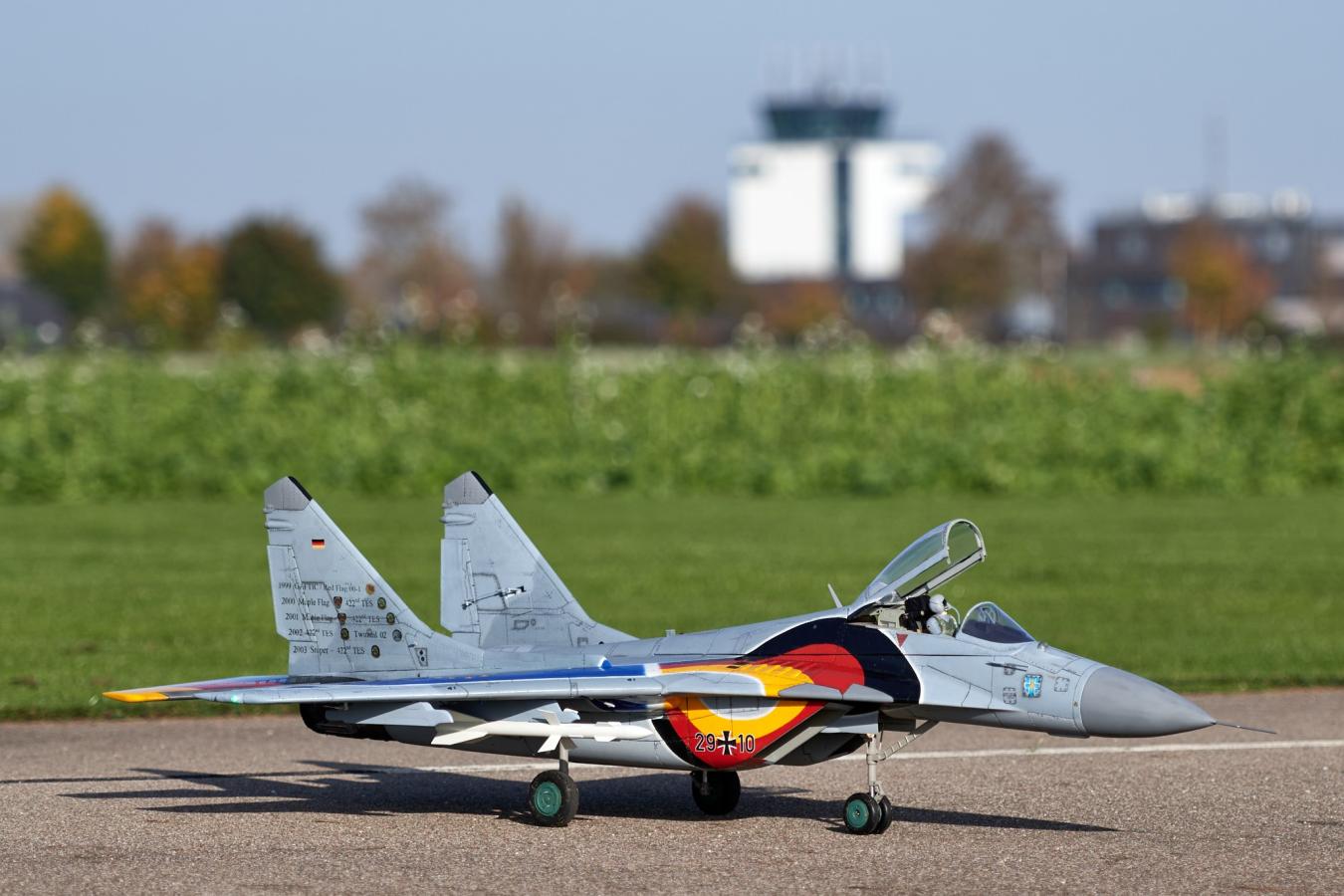

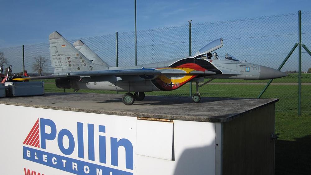

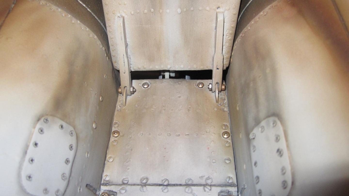

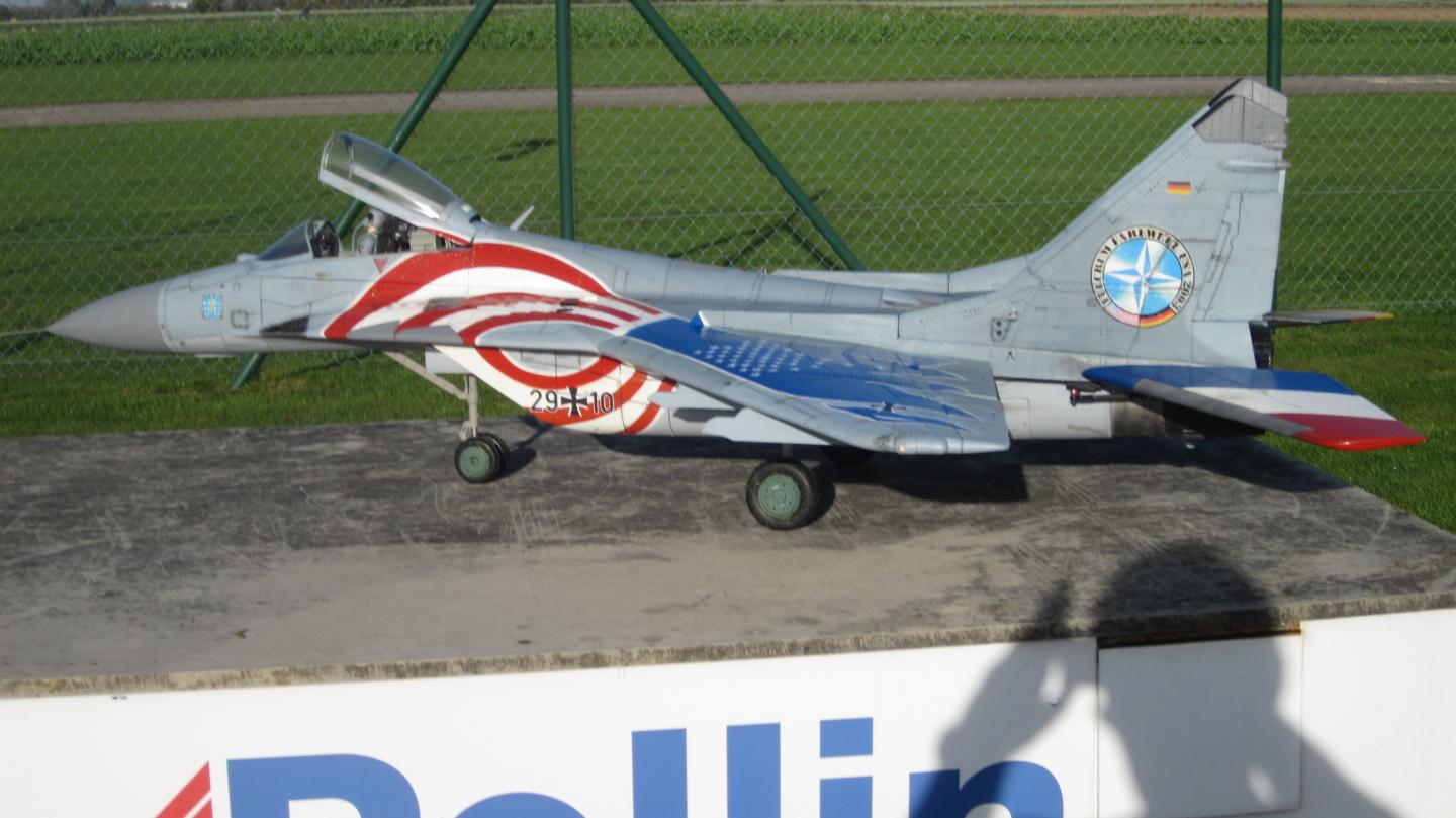

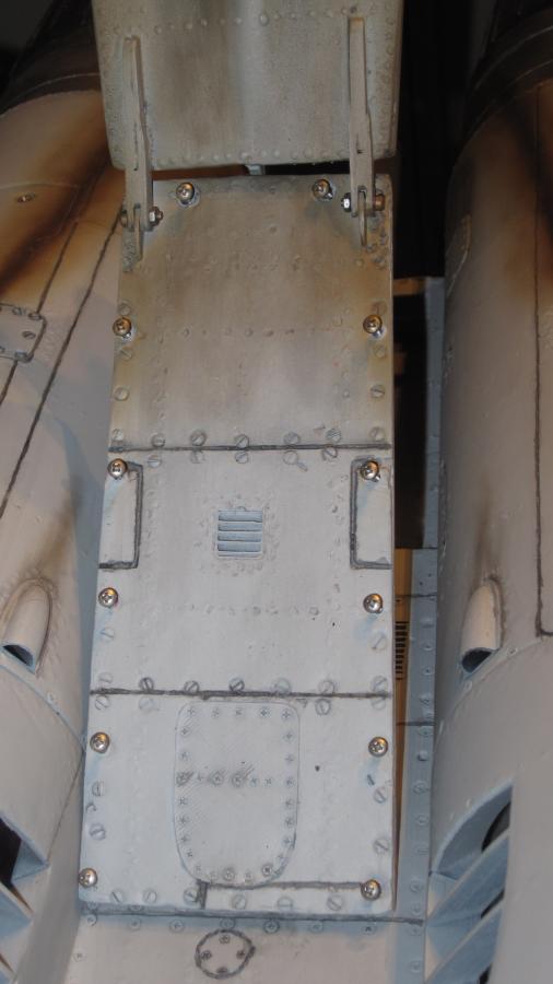

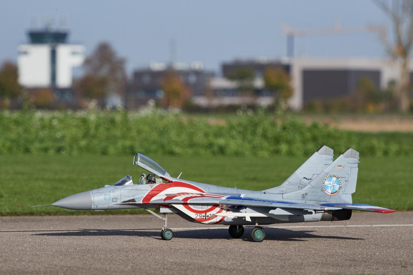

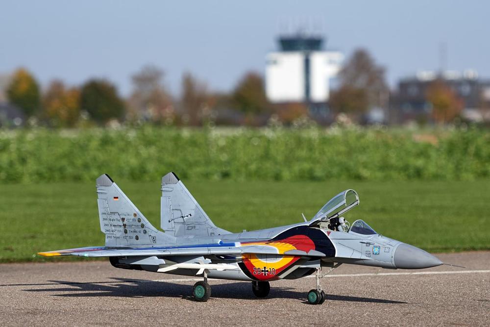

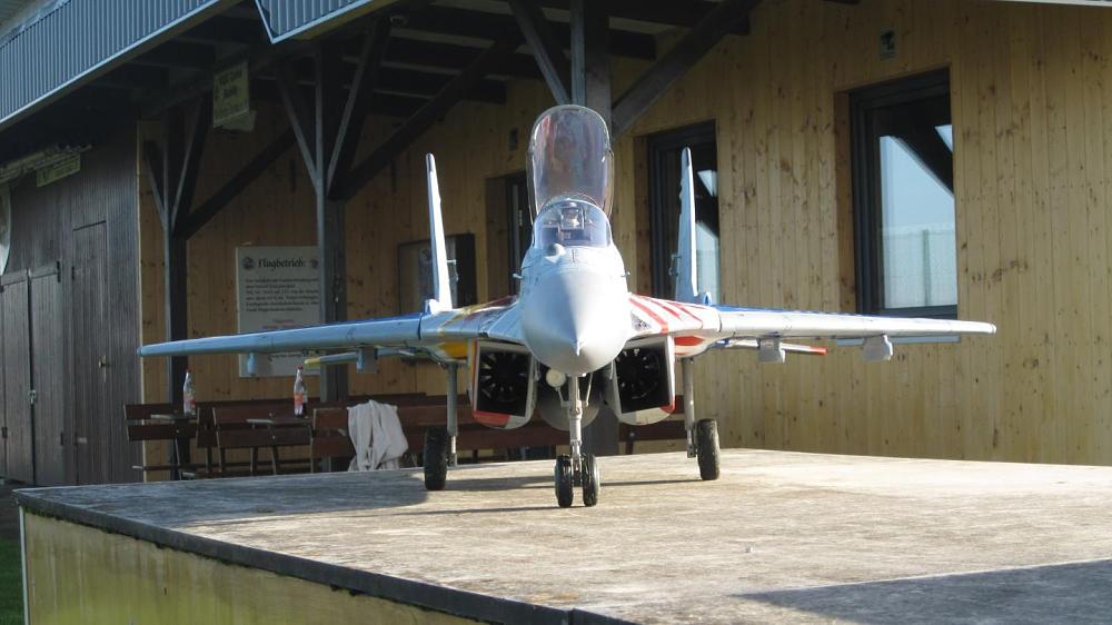

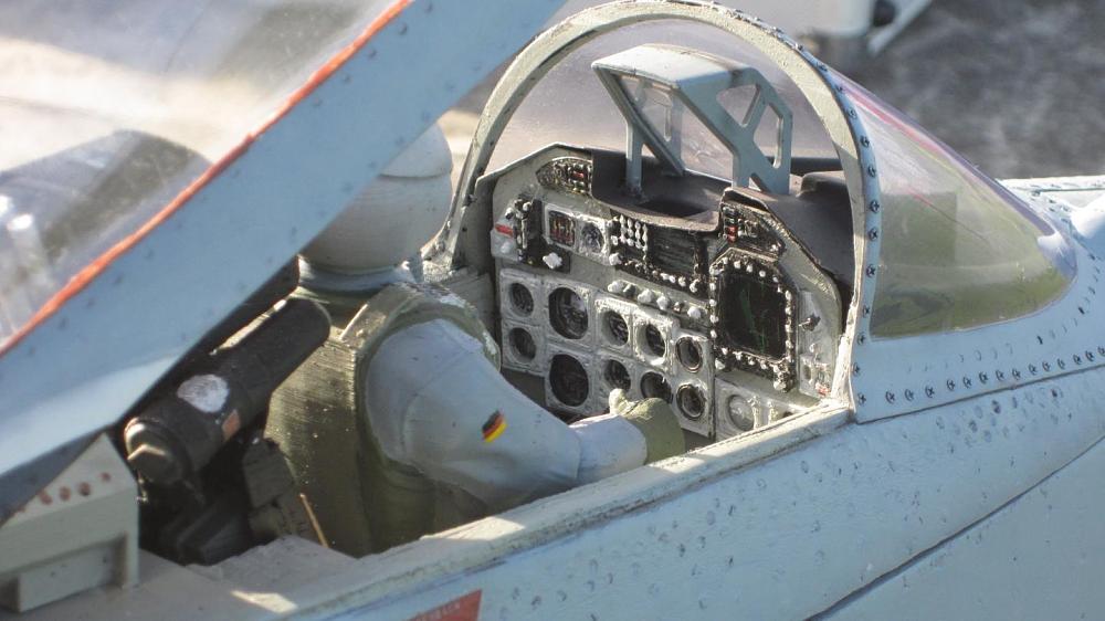

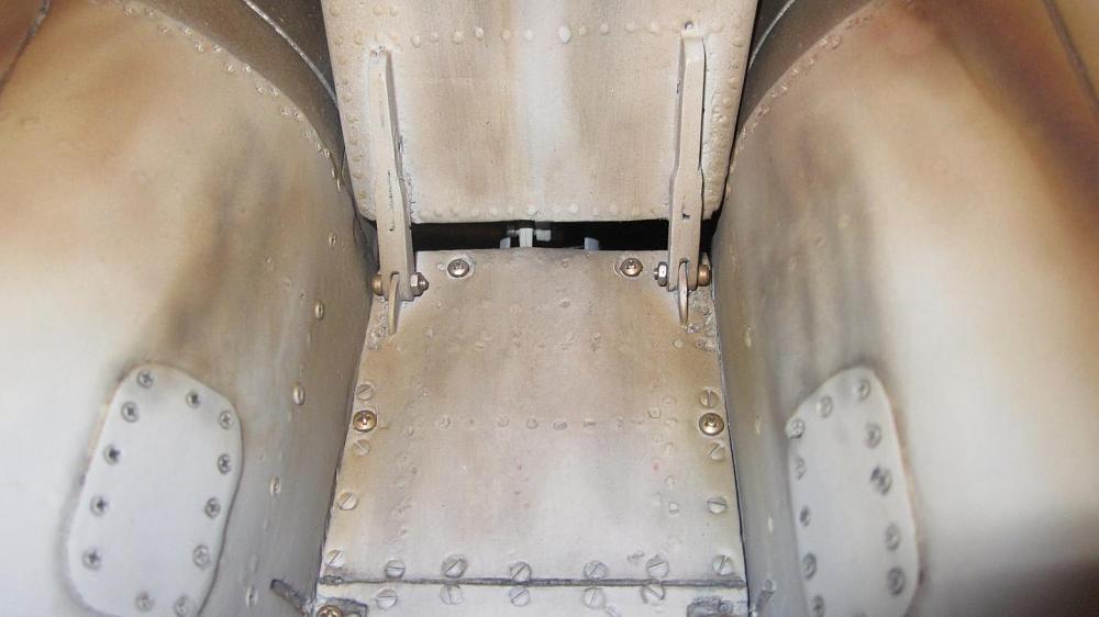

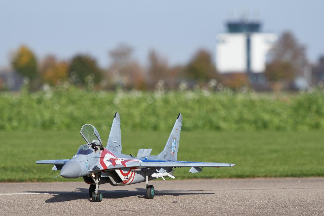

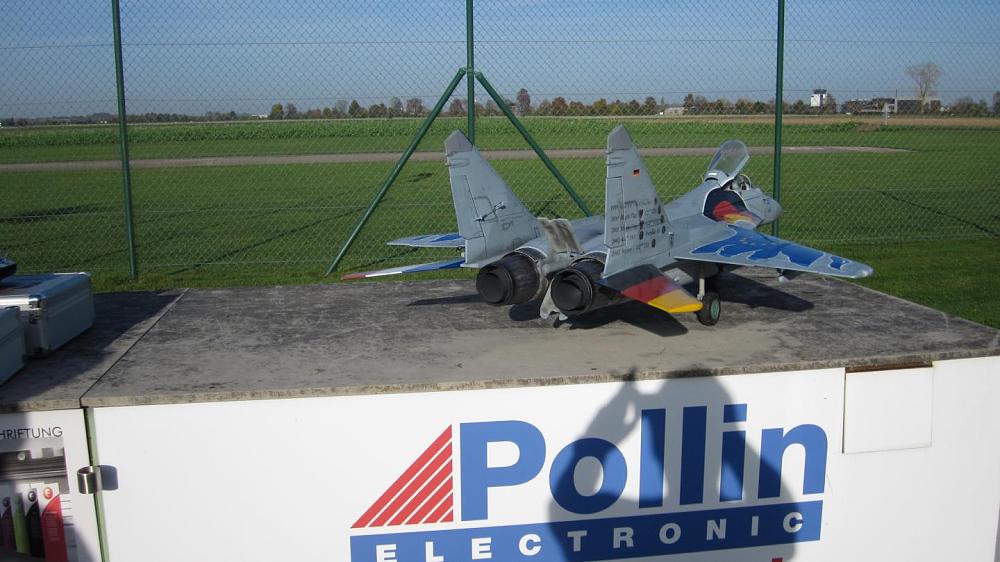

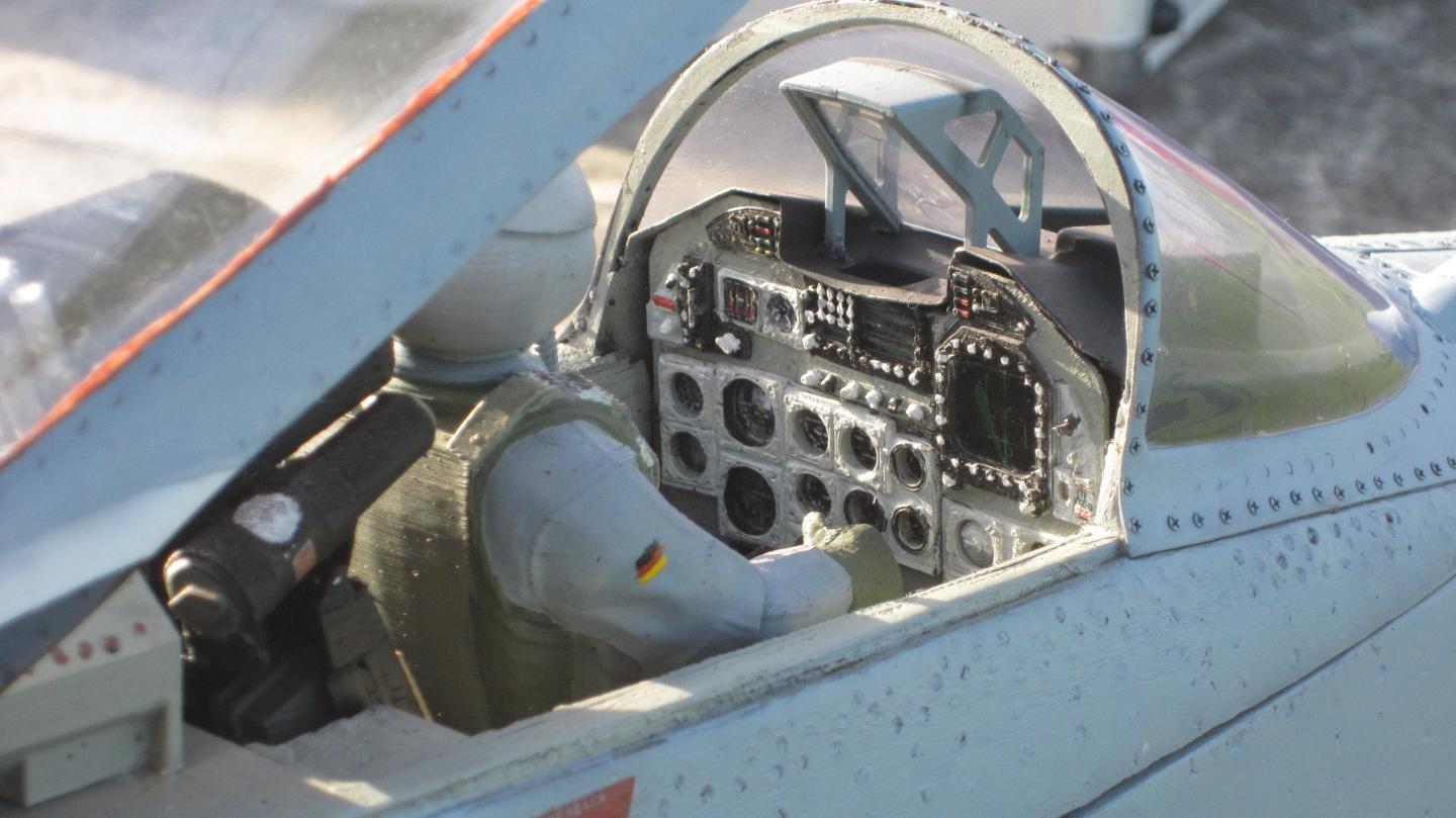

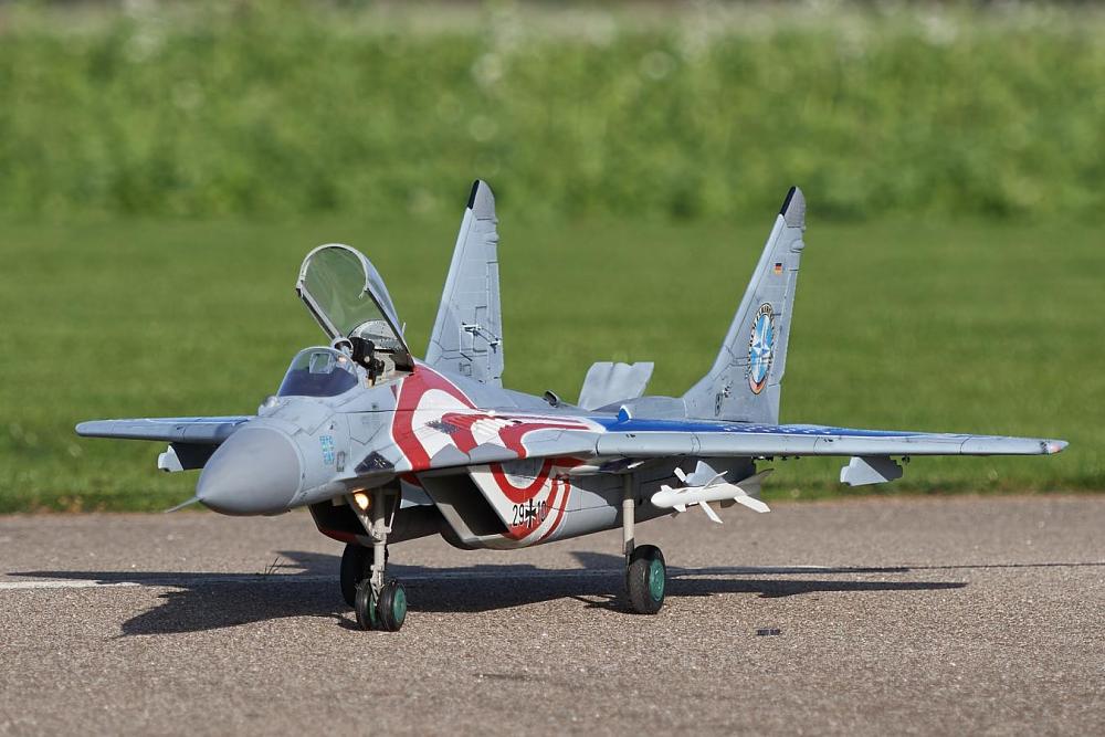

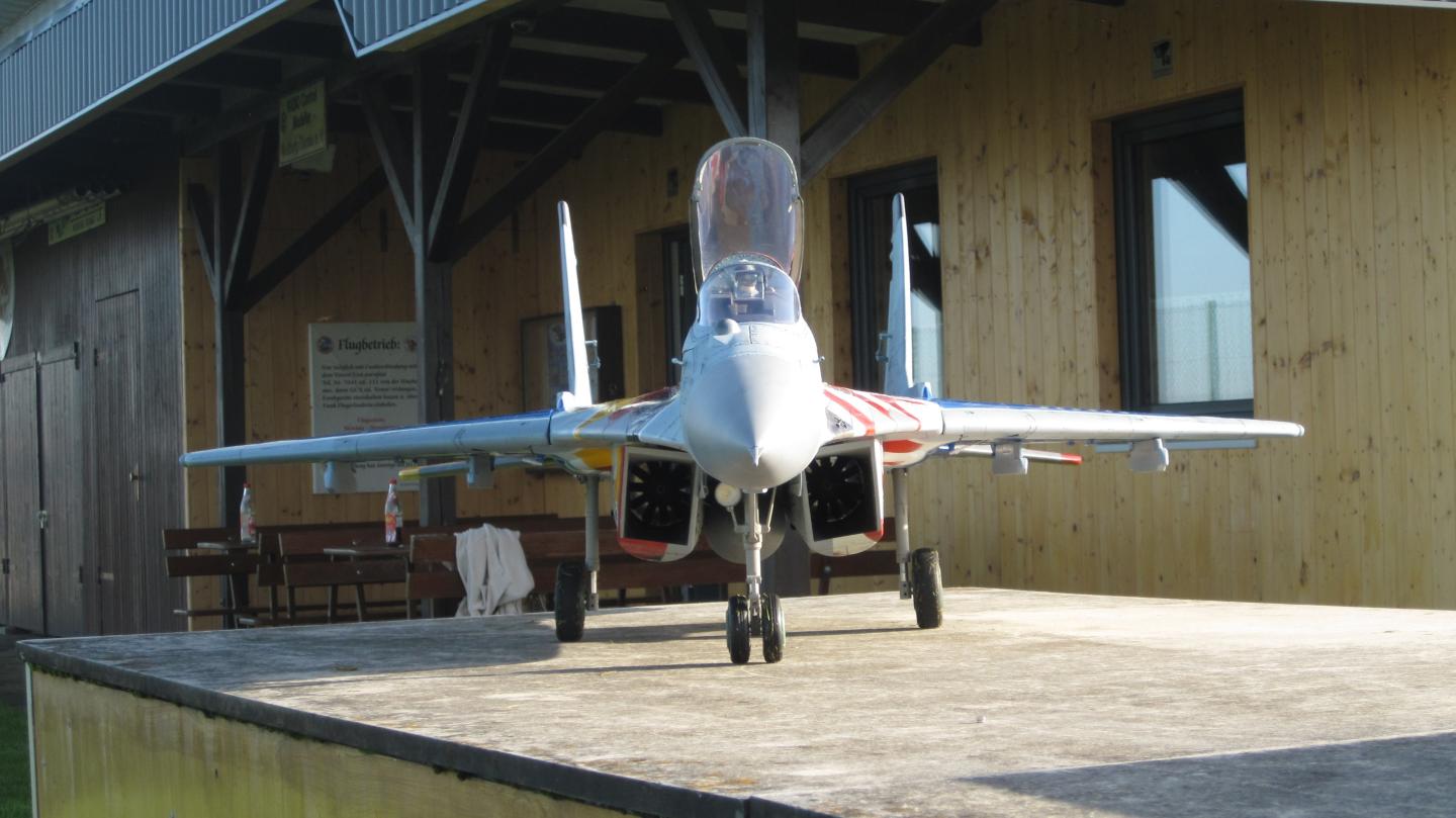

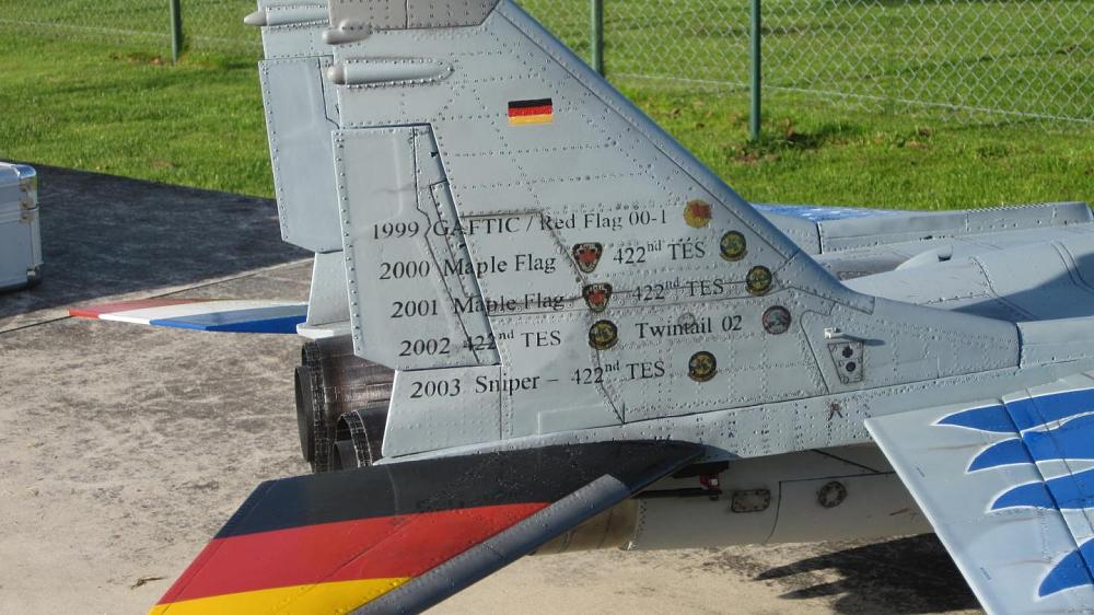

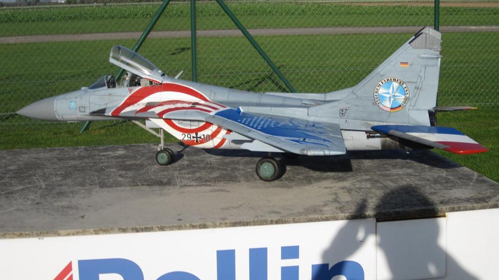

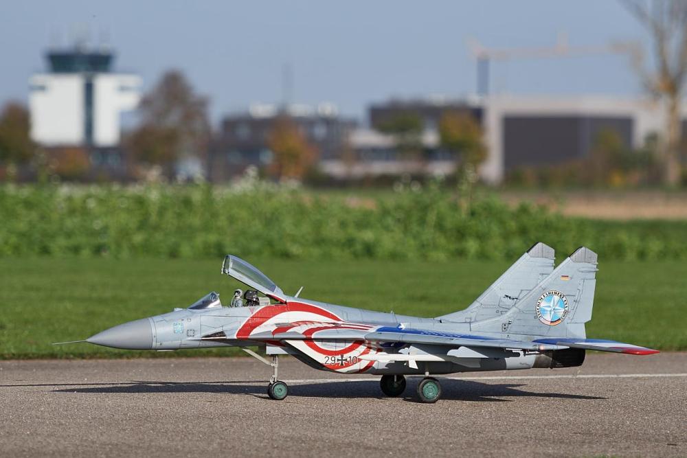

              • Hi folks

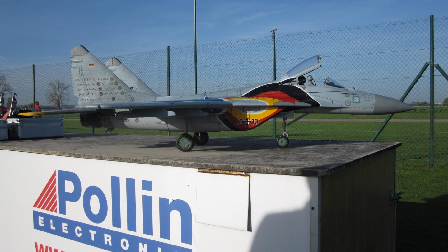

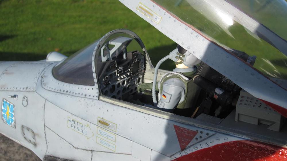

                roughly one year of work, here is my version of the mig
                greetings stefan Click image for larger version

                  Looks awesome...
                  • heisteff INCREDIBLE WORK, love the air brake, cockpit, rivet detail and of course the operable canopy. First Rate!!!
                    Hangar: FL/FW: Mig 29 "Cobra", A-10 Arctic, F18 Canadian & Tiger Meet, F16 Wild Weasel, F4 Phantom & Blue Angel, 1600 Corsair & Spitfire, Olive B-24, Stinger 90, Red Avanti. Extreme Flight-FW-190 Red Tulip, Slick 60, 60" Extra 300 V2, 62" MXS Heavy Metal, MXS Green, & Demonstrator. FMS-1700mm P-51, Red Bull Corsair. E-Flite-70mm twin SU-30, Beast Bi-Plane 60", P2 Bi-Plane, P-51.
                    • Brilliant work! It looks excellent! 👍 I just start to setup/rebuild mine, but I think I will not achieve your looks 😄
                      Did you change the servos? What about your power supply? I will use a Powebox Pioneer together with two 12A BEC from two ESCs from YGE.
                      Greetings, Kai

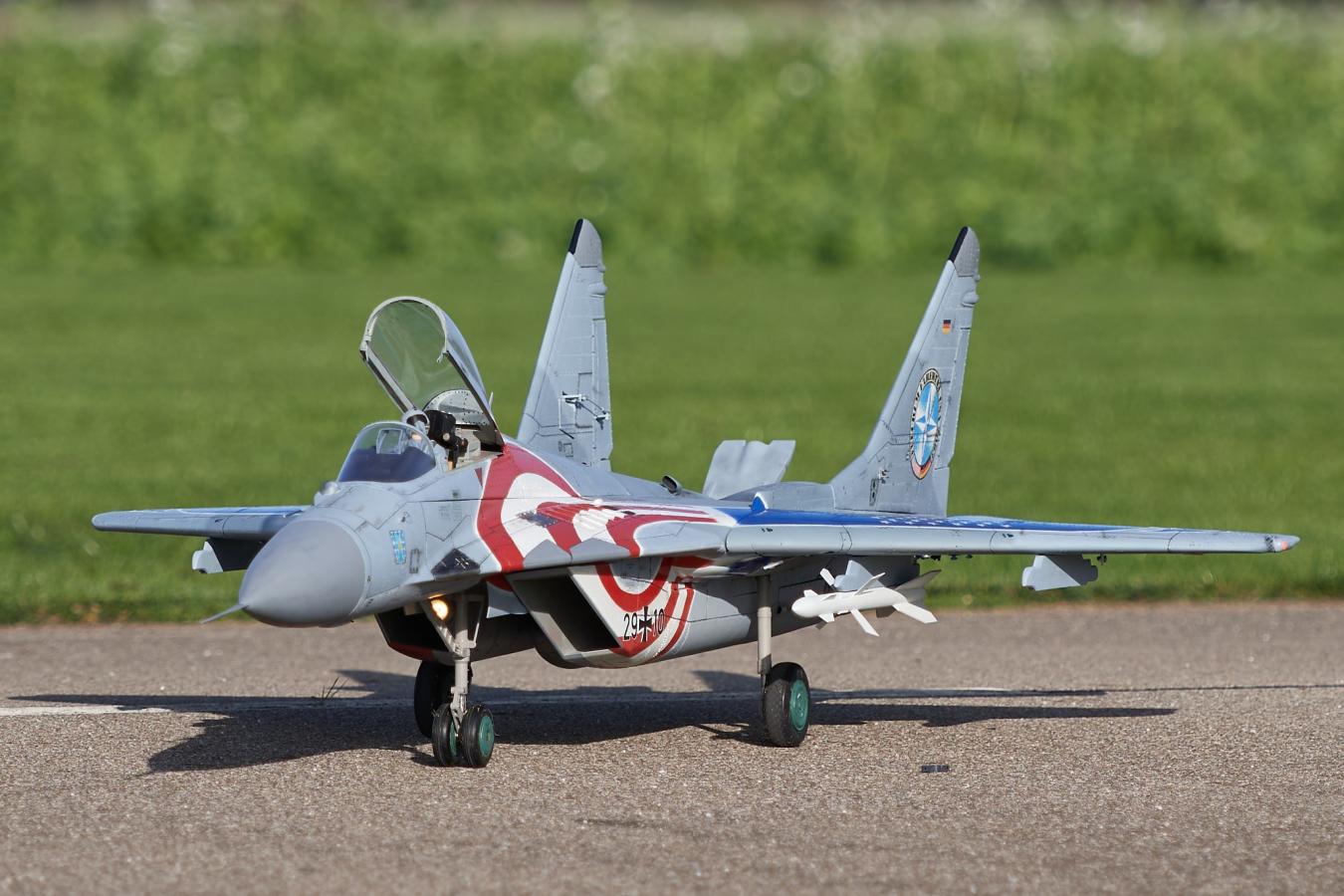

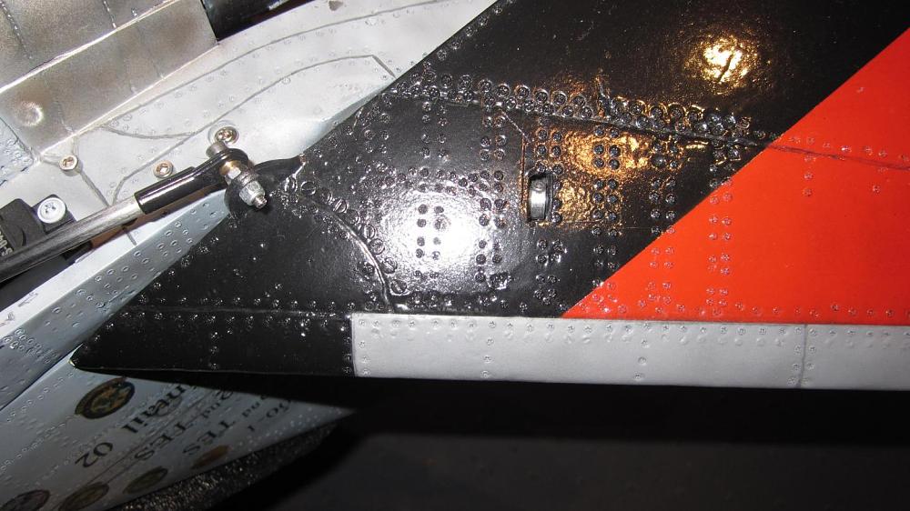

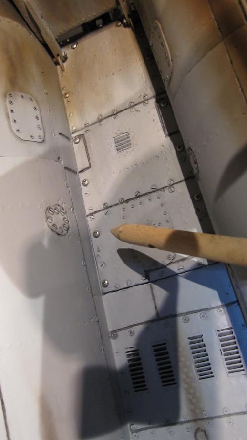

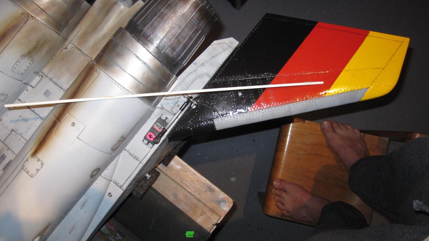

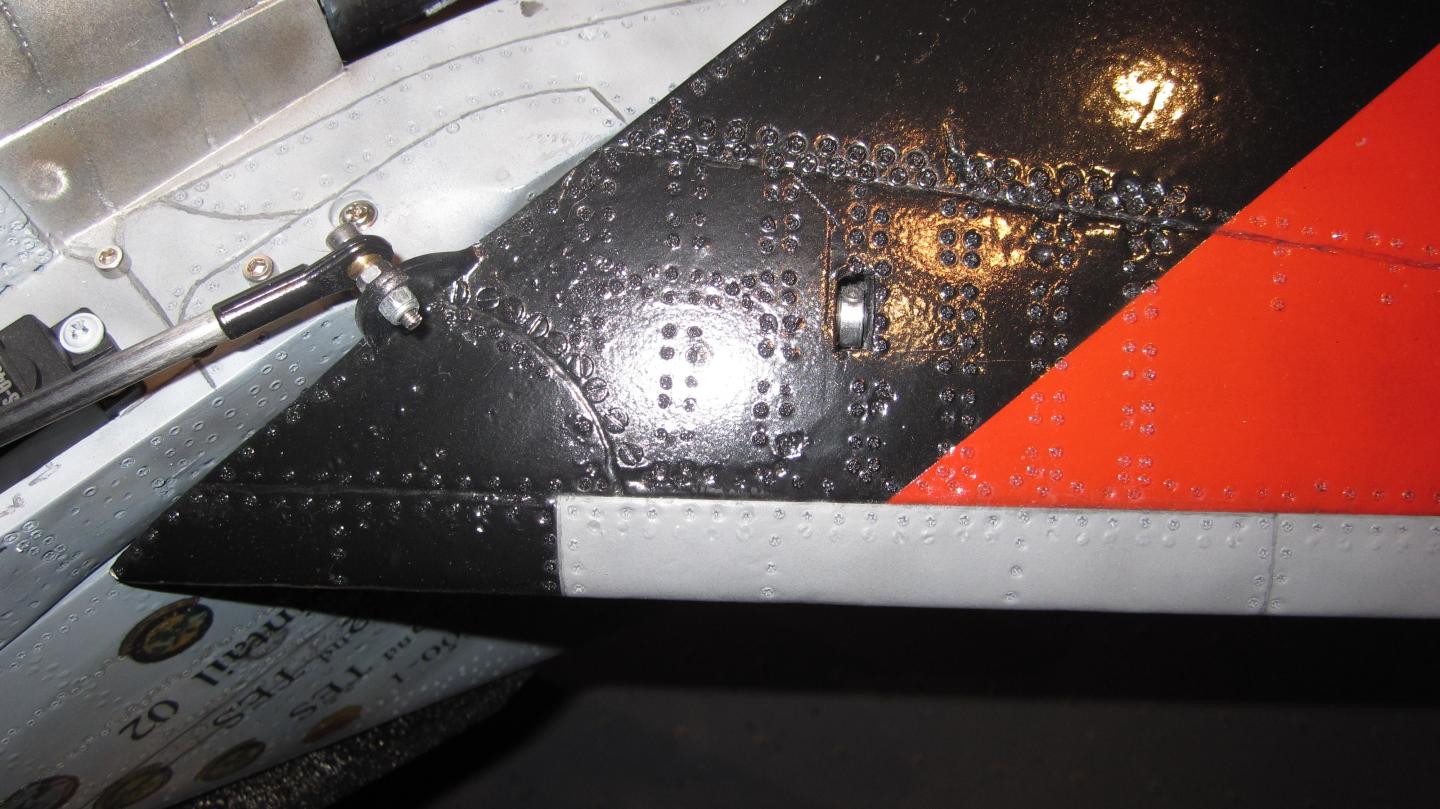

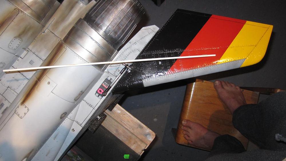

                      • Thanks happy you like it,
                        to Kai; the elevons are comlettly rebuild to scale mechanics so the axel is going halfway into the fuse, there are operated by HS 645 MG -Servos, power is supplied by the BEC of the Controllers. but i might give it a external bec since i need a little bit of weight in the nose (due to one 16000 flight battery)
                        Stefan
                        • Originally posted by heisteff View Post
                          I'm not quite sure what you mean by that. Did you change the angle of the taileron rotation axle to be swept back, like the real thing?
                          If so, that should relieve the load on the stab. servos. (See, for example, posts 2712 and 2842 in this thread).
                          I believe Airguardian reached the same conclusion.
                          • yes thats what i did, i dont know if it really takes any load of the stab, since the axle is at about 25% MAC and there is quiet some more wingarea in the "wind" then at the stocksetup (axle in the middle). so i thought more powerfull servos wont hurt, just by my feeling. most importend improvement by that mod is the stiffnes of the tail i think

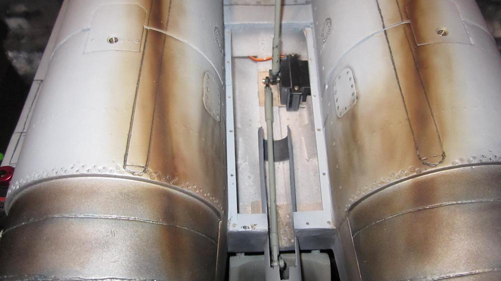

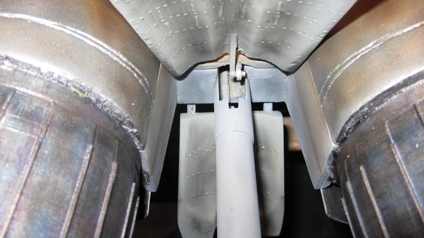

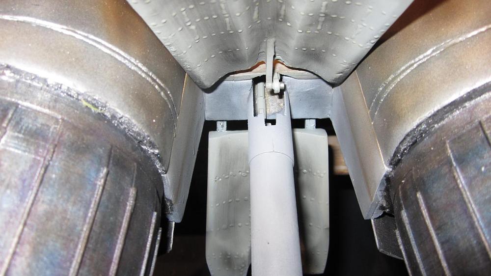

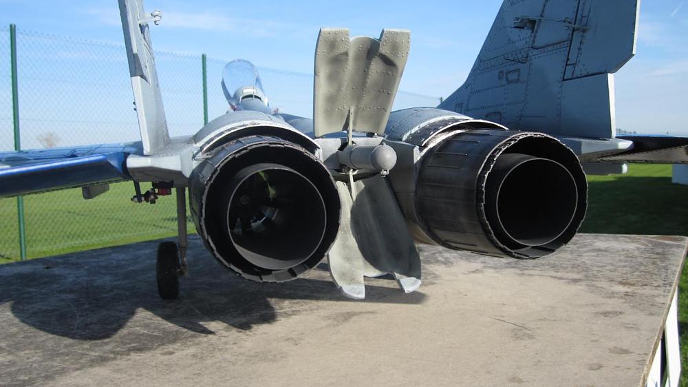

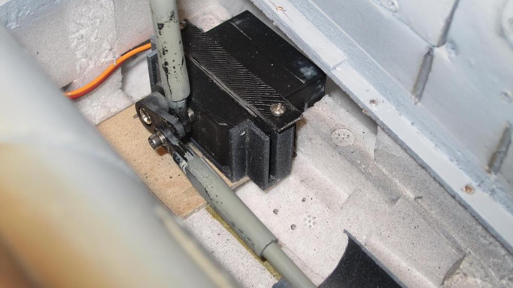

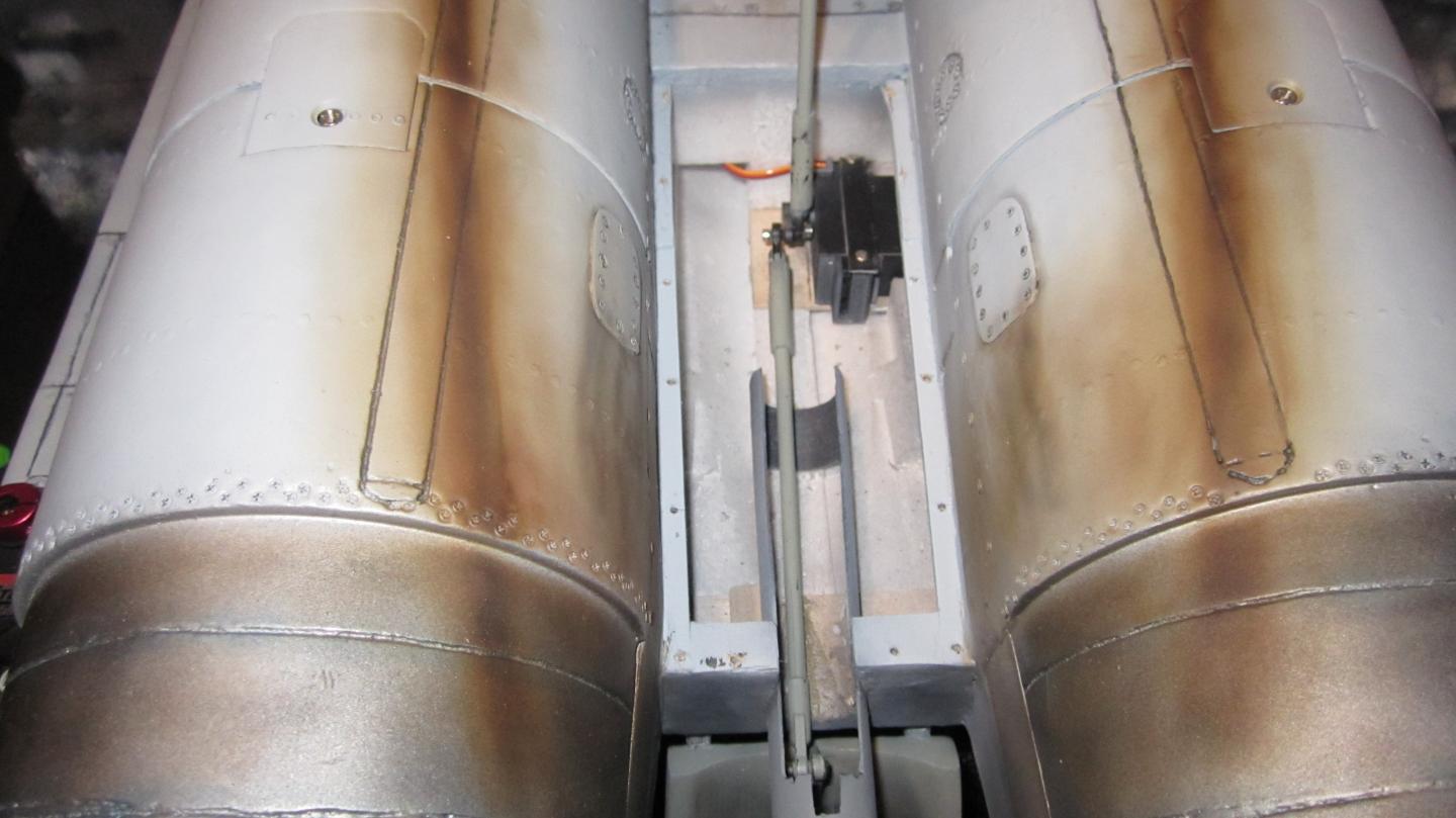

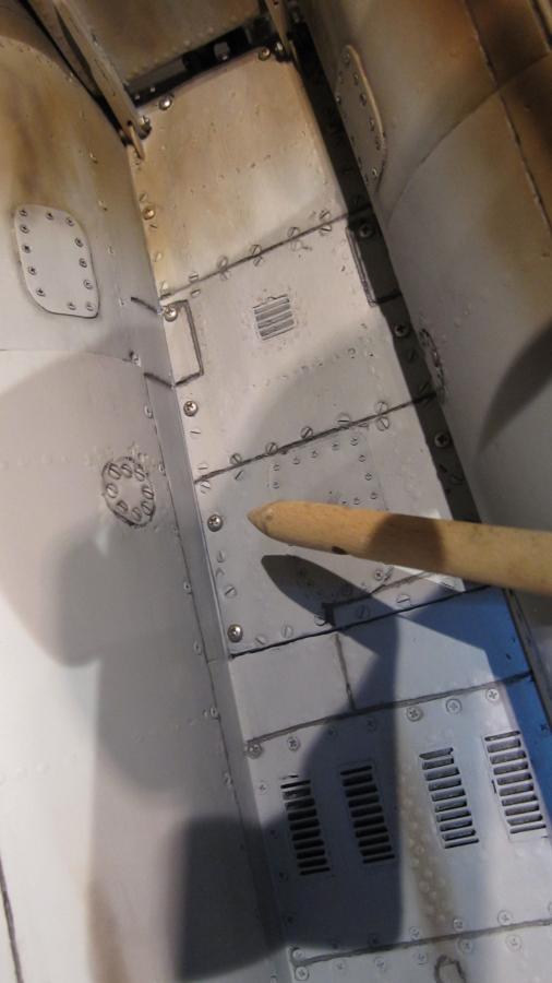

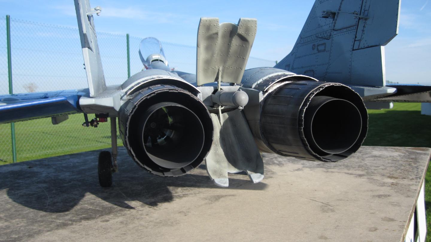

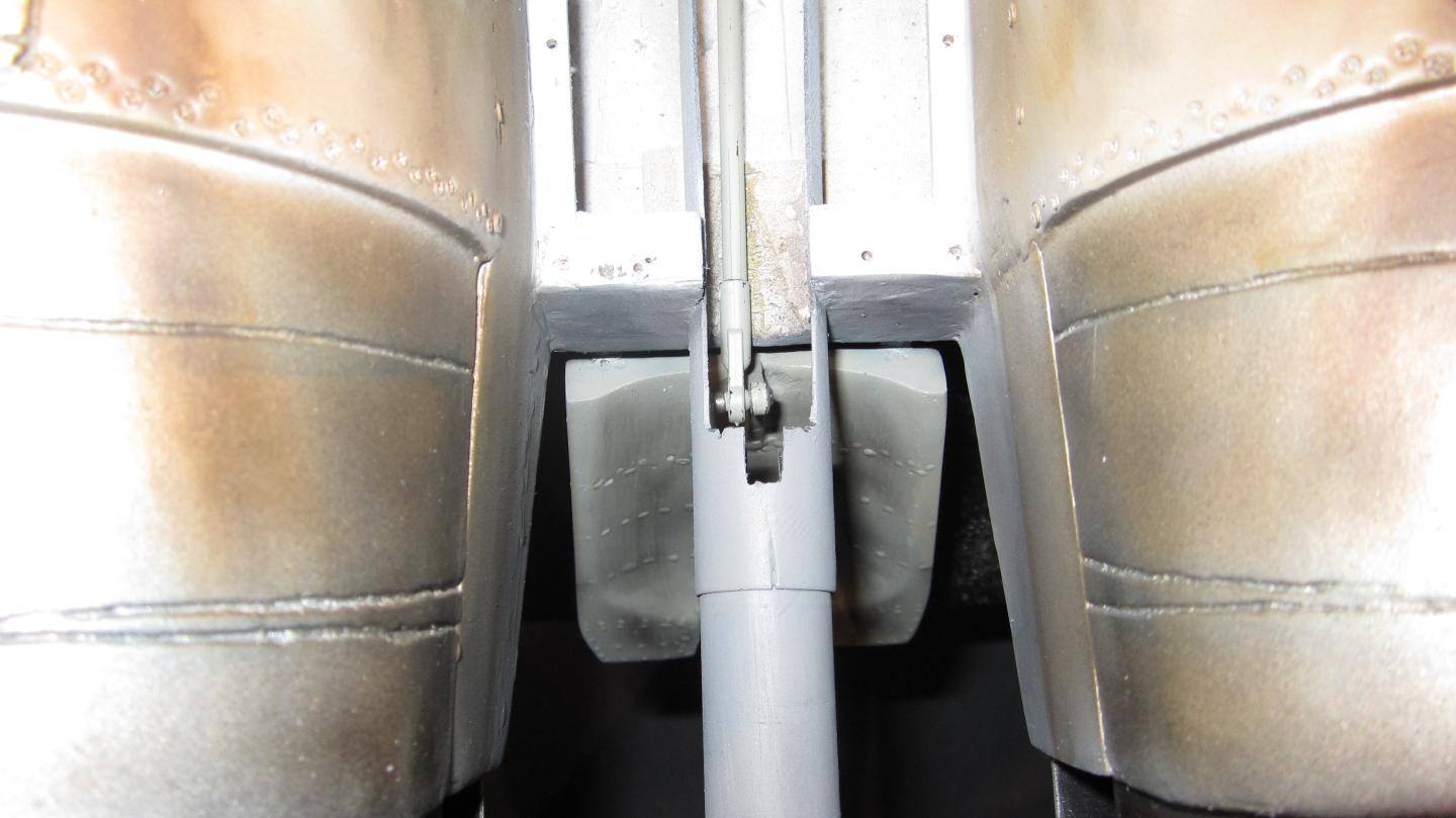

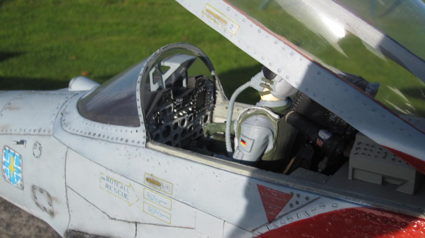

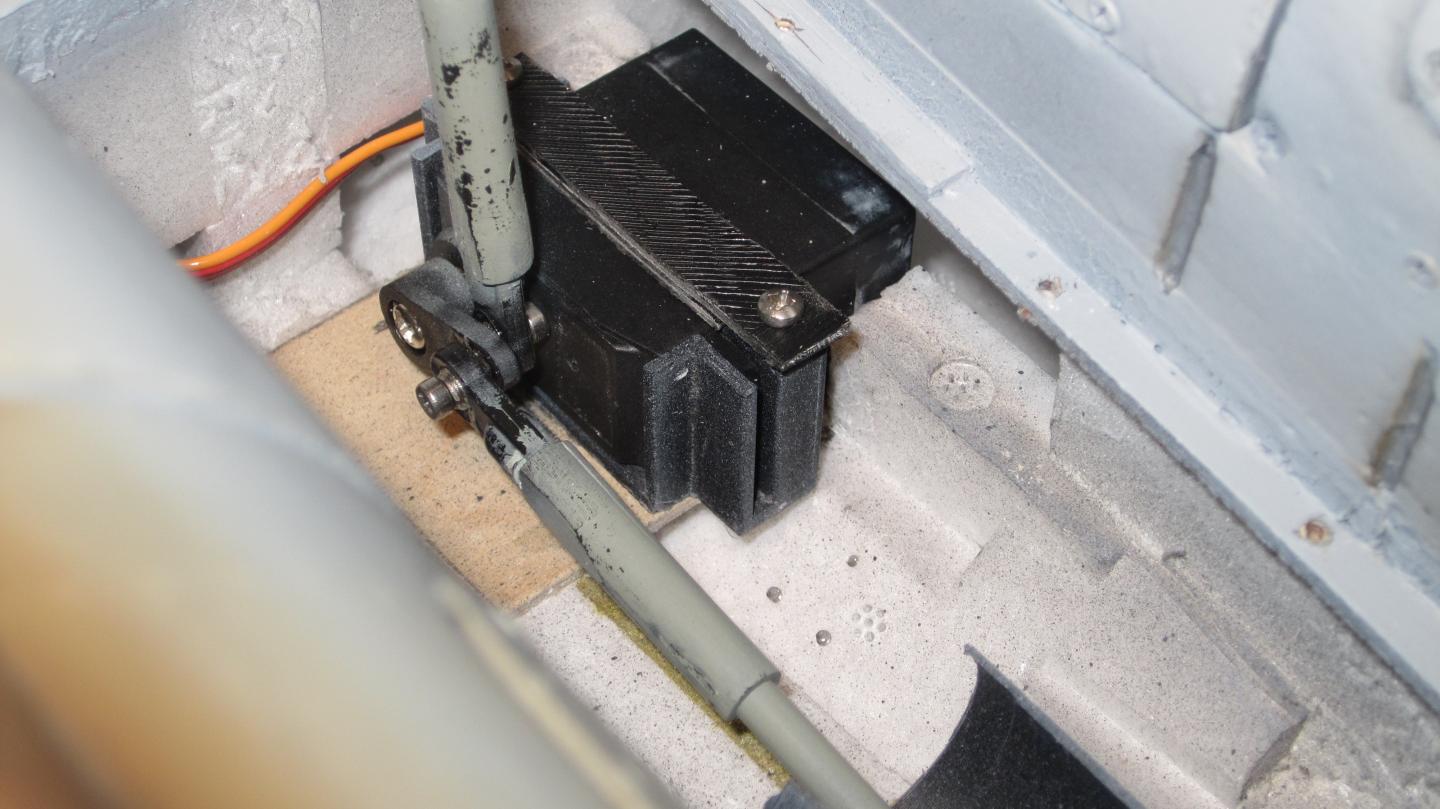

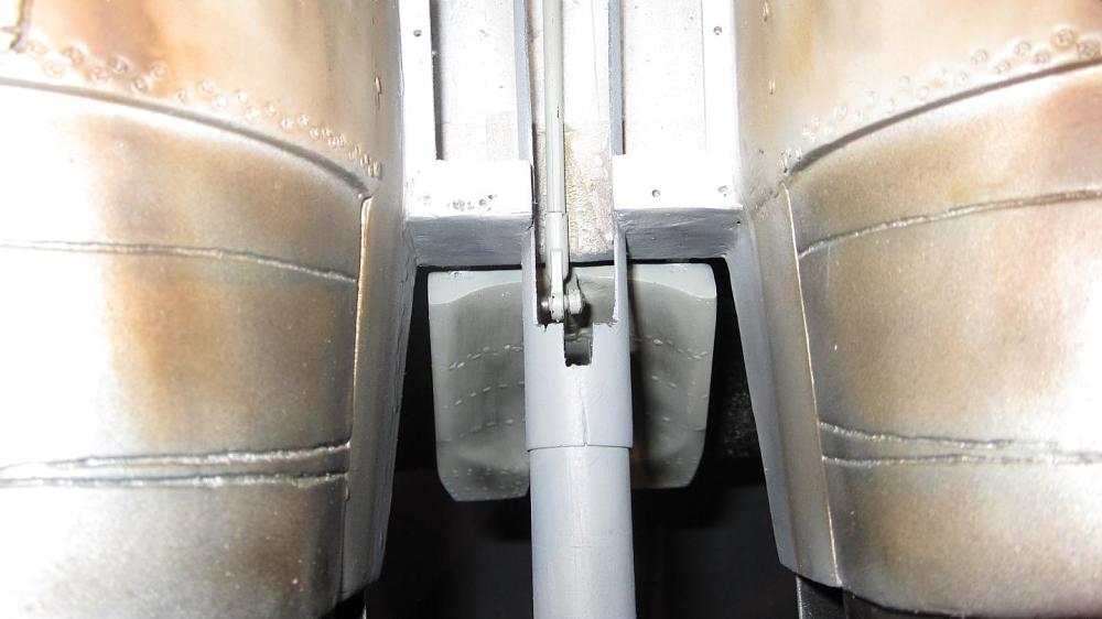

                            • @heisteff​ Can you tell us and show us what you did to get the airbrakes to work?

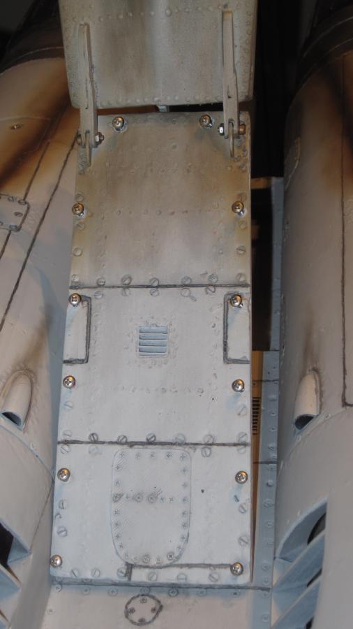

                              • ok for the airbrakes, it´s a little bit like on t33jetmans pictures. i use one 3.5 kg servo instead and a ballink leverage, printed out some servoarms ( bent forward somemore then normal). the "brakepedals" where shaped / cut out inside to fit the parachutetube (3d of thingivers) and after the hinges where done i glassed them with a 23gr fiberglas. the bottompiece (about 15 cm) that was cut out screws back on so you can access it for maintenance and for my elevators i attached some pics too. Click image for larger version

ID:	360272 the white stick shows just about the correct lenght of the axle. hope it helps
                                greetings stefan
                                • Your airbrake set up is very intricate. I don't have the talent to do it. I was hoping that Motion was going to bring out the airbrake kit when they brought out the vector thrust nozzles.
                                  Do you know if the airbrakes actually help reduce the ground roll after landing? Being such a heavy plane, my MiG rolls "forever". Airbrakes or reverse would really be of help.
                                  • Motion doesn't "bring out" things. Free Wing does.
                                    I'm 100% sure it helps as when I use crow and rudder air brakes on landing it very much shortens out my roll out.
