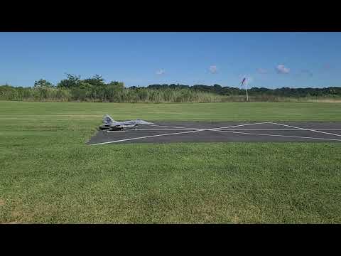

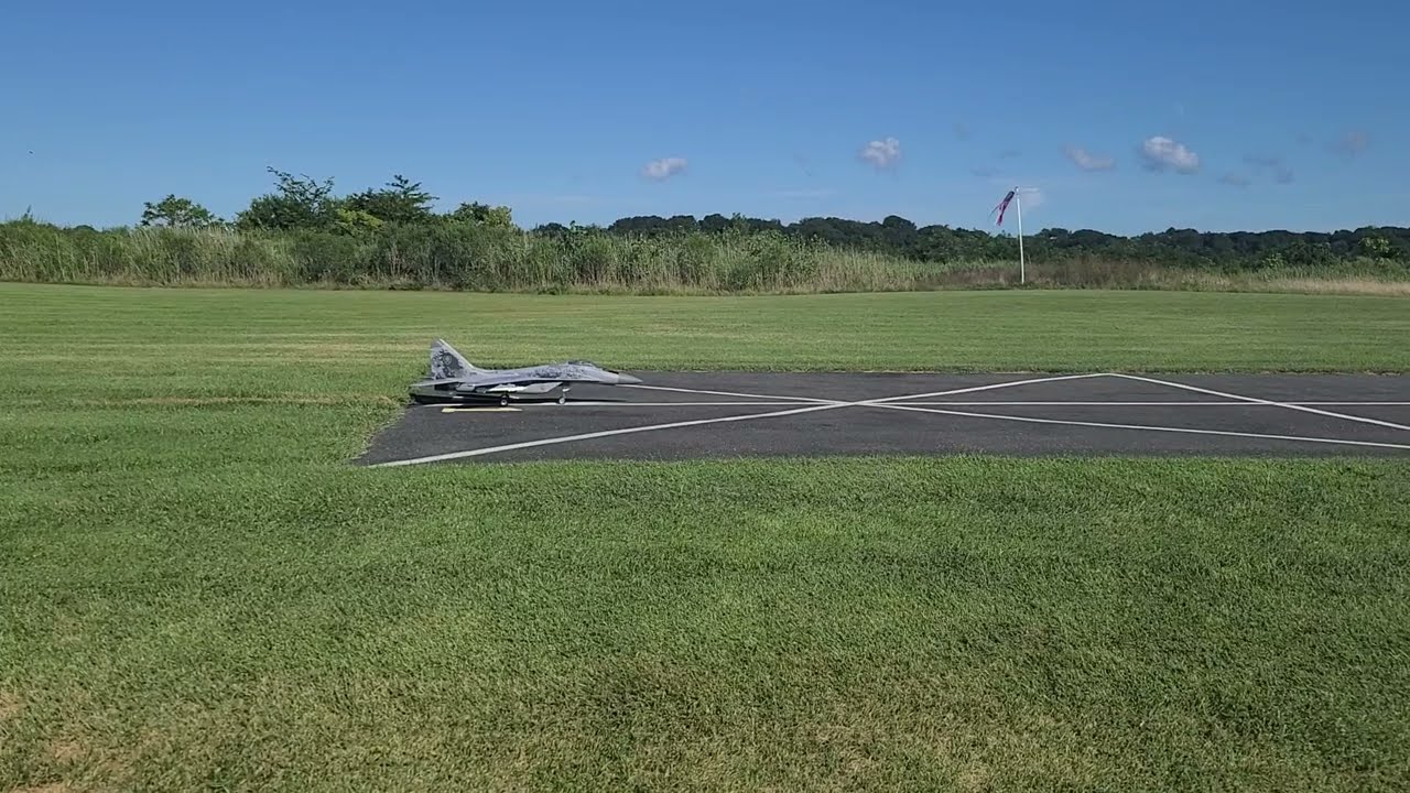

              Do you honestly think ANYONE will ever get a pair of fans in the big Mig that can do that?
              hklagges demonstrated it early on in the RCG thread. He made a huge bikini op, reducing weight, installed 12S systems, extended cheaters and posted an indoors video of his MiG hovering. He never provided a flight video though, but not that that matters anyway, it IS doable, if you have the time, patience and money... and even then it's likely going to be only good for short flights if you go crazy with hovering. But that's to be expected anyway. ;)
              Find video evidence of 12S-modded FW MiG-29 hovering here:
              https://www.rcgroups.com/forums/show...0#post46341591
