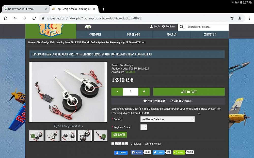

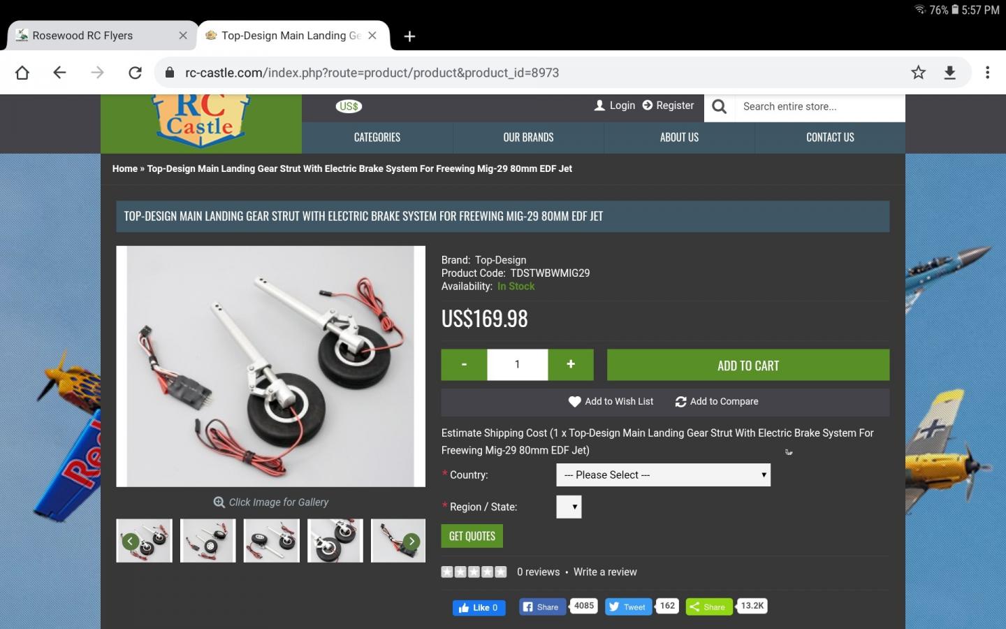

              Looking to add brakes on my Mig 29. Saw these at RC Castle. Has anybody used them?
