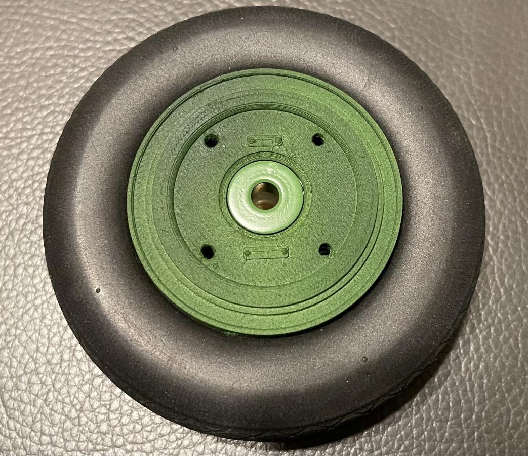

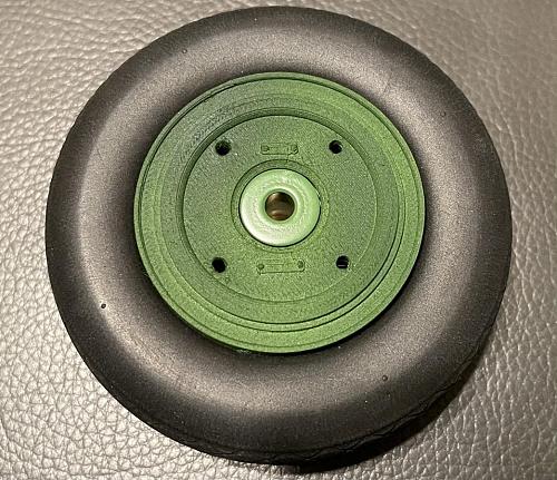

                                If interested, I designed a simple 3D printed main wheel cover for the Freewing MiG-29 that is available for download on Thingiverse.
                                If someone has spare time and a printer, please let me know if there are any clearance issues when the covers are installed on the aircrafts main wheels when the gear is retracted. I had the Freewing wheel in my possession to design the covers and ensure fitment, but I don’t have the aircraft.
                                After printing, make sure to clear out the ring/hole on the underside of the covers on the portion where it will sit above the ridge of the stock wheel. This will ensure it can lay flat/flush onto the Freewing wheel.
