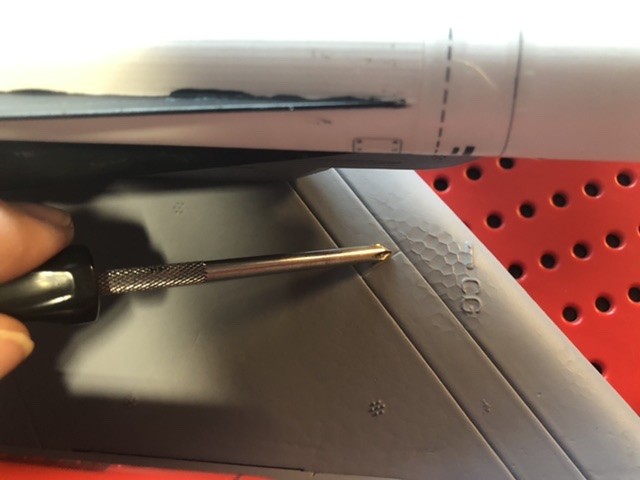

      #2842
      Originally posted by viper1gj
      Here is some data to support my theory that the micro full flying stab (FFS) servos are not up to the task on this model.
      I’m no engineer, I flunked higher engineering math in the first year college and switched majors to something I could do. But I’ve flown RC airplanes for 55 years, turbines jets for 20 years and have built and flown several scratch built turbine jets. Nothing special about that, but I have used the AMA Large Model Aircraft (LMA) guidelines for years with good success.
      [/FONT]
      I am an engineer, I have a PhD in physics, been flying RC for 56 years, and I agree with you.
      I did the calculations. The stabilizer axle is too far forward of the center of pressure.
      Problem could be fixed with surgery to make the axle parallel to the leading edge of the stab instead of perpendicular to the fuselage. Would remove the need for the super heavy duty servos some people are installing.

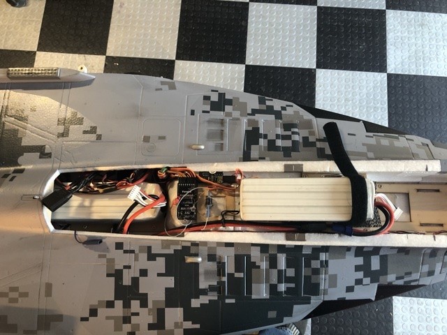

                          Tomorrow is forecast to be light winds and good weather. I’ll be trying out the MiG’s new configuration which consists of:
                          - 20 AWG (0.5mm) twisted tail servo drive wires
                          - MRC supplied Y
                          - FFS servo control rod on inner servo arm hole
                          — 4-40 threaded rod with heavy duty DuBro ball link and Kwik-Link safety lock ends driving the FFS
                          - CG 15 mm aft of wing mark / wheels down
                          — Since I am using Admiral Pro 6000, this required adding some weight to the tail area (not a lot)
                          - MRC upgrade servos (they have served me well so far)
                          - 4 mm of FFS trim removed / We’ll see where the trim ends up after the first flight
                          - 5 RF chokes (each ESC, each rear servo in the tail and one by the green ferrite ring)
                          Thanks for everyone’s inputs.
                          Until I upgrade TX/RX, this is about as far as I can “improve”.
                          Stay tuned.
                          -GG

                                  #2856
                                  - MRC supplied Y
                                  - 4 mm of FFS trim removed / We’ll see where the trim ends up after the first flight.
                                  Thanks for everyone’s inputs. Until I upgrade TX/RX, this is about as far as I can improve.
                                  Stay tuned.
                                  -GG
                                  I'm going to predict that you don't have a loss of control event.
