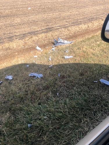

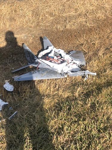

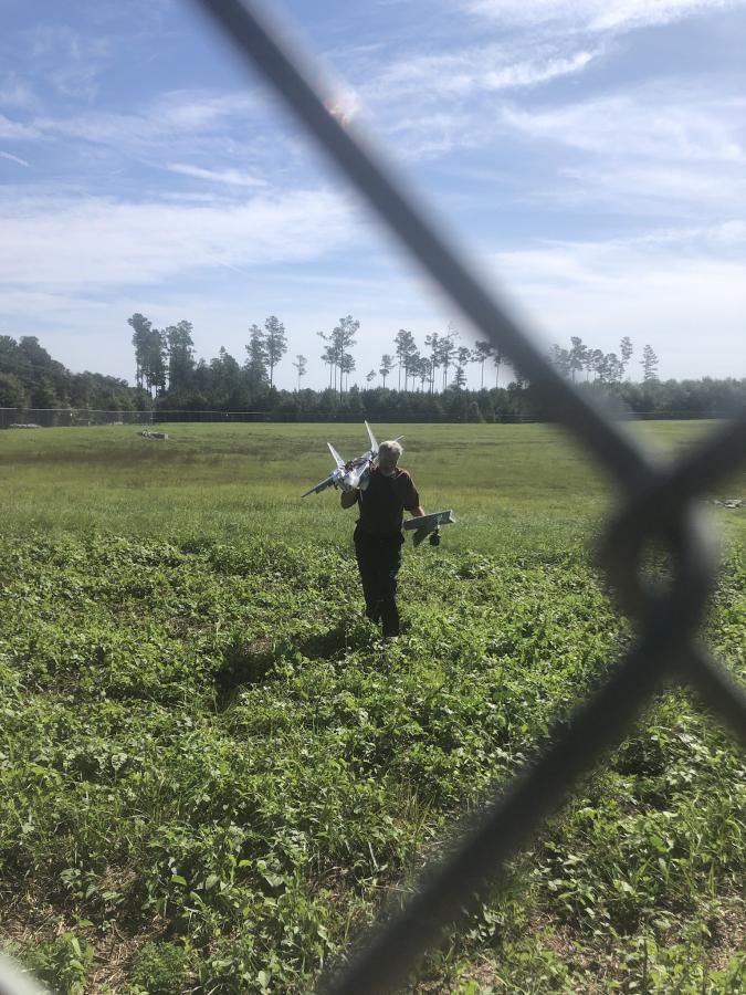

                          • Originally posted by fishface5 View Post
                            Well In my opinion something is still wrong with this jet!. I just got back from flying it and it went down. I flew it last week and it did a little dive on its own but i was able to compensate and land it ok. I figured maybe i was flying it to fast and hard so today I went and flew it scale like and it did a dramatic dive and i was able to get it pulled out and it did it again and i could not save it.
                            I have the updated servos and the updated rods and links. Hopefully some one can get this figured out.
                            Dear Fishface, I am very sorry to hear that this happened to you. Could you let us know a little more: you said it went into a dive and that you recovered, but then it did it again. Did you cut the throttle in your dive? Were the elevators working? Did they seem to work after the first dive? Did the model go into a steep dive all by itself or was it already going down and then stopped responding to the elevators? Where was the receiver located and did you check the battery voltage afterwards? (I'm not suggesting anything, just wondering if you checked)

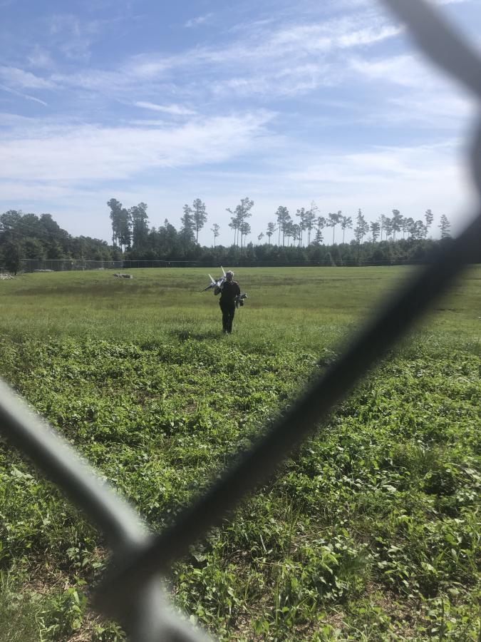

                            • It’s a long walk. Mine went in at a Star Bucks plant. Required some prison break out techniques to get to the MiG. Your pic and description are so familiar.
                              Freewing A10, F4, F22, Sebart Avanti S mini

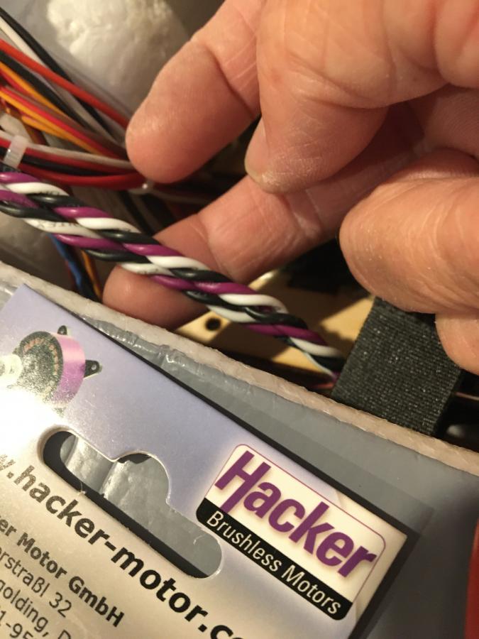

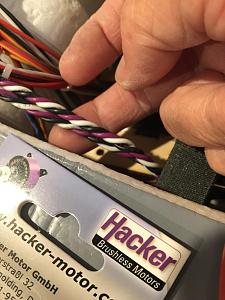

                              • Completed the elevator wiring upgrade to twisted 20 AWG. Hopefully, this will help decrease the chances of having low-voltage at the elevator servos in case of a heavy servo load. The gold contacts should help a bit, too.
                                I decided to not reroute and did a straight replacement pull (hint: Easier to pull the new wire forward from the tail.) since I wasn’t having issues and I previously added some “shielding” around the ESCs (aluminum pipe tape).
                                Since the MRC “Y” is short, not much IR drop in a short length, so I kept the MRC “Y”.
                                HK111 - What would MRC “say”? I doubt they have any better knowledge of the cause of the crashes at this point. If they knew something to tell us, I feel sure they would.
                                Pix and link follow:
                                -GG
                                https://www.hacker-motor-shop.com/Se...0025050&p=8312
                                IMPORTANT: Get the 80 cm length! Perfect length.

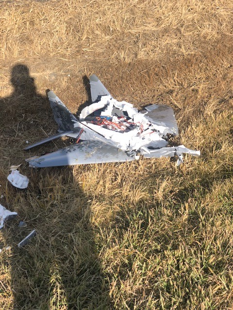

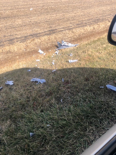

                                    I have the updated servos and the updated rods and links. Hopefully some one can get this figured out. Click image for larger version  Name:	IMG_3630.jpg Views:	1 Size:	169.4 KB ID:	284143Click image for larger version  Name:	IMG_3629.jpg Views:	1 Size:	140.4 KB ID:	284144Click image for larger version  Name:	IMG_3631.jpg Views:	1 Size:	61.6 KB ID:	284145
                                    This really sucks. I am very sorry to see you crash as well. Been there and know exactly how you feel. Mine went down two weeks ago. My advise is to contact MRC and give as much details as you can. MRC was great with my issue and helped me a great deal. They are truly trying to figure this out - including some very intense discussions with Freewing. We just need to keep reporting the crashes and details. Please have a look at the elevator horns. Is the pic above after the crash or before? ... are they bent post crash? Any more close up pictures of the wreckage is welcome.

                                      • I was flying out of a turn and going level and then it did the dive all by itself i was able to pull back on the elevator and get it going straight up and then level and it did it again and then it was a struggle to get it recovered i got it to go inverted then got it turned right side up and then it was diving again and would not recover. I replaced the factory BEC because i have had troubles with that brand. I was using a castle 10amp bec. I have several large EDF Jets and the HSD F16 has similar size elevator stabs and on that jet they are using 25g servos. I wonder if this is what is needed on this jet

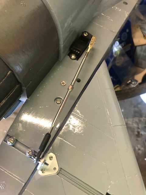

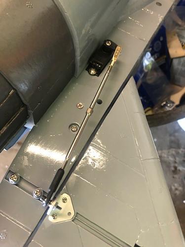

                                        • Originally posted by Captain MoMo View Post
                                          The picture of the elevator rod setup is post crash
