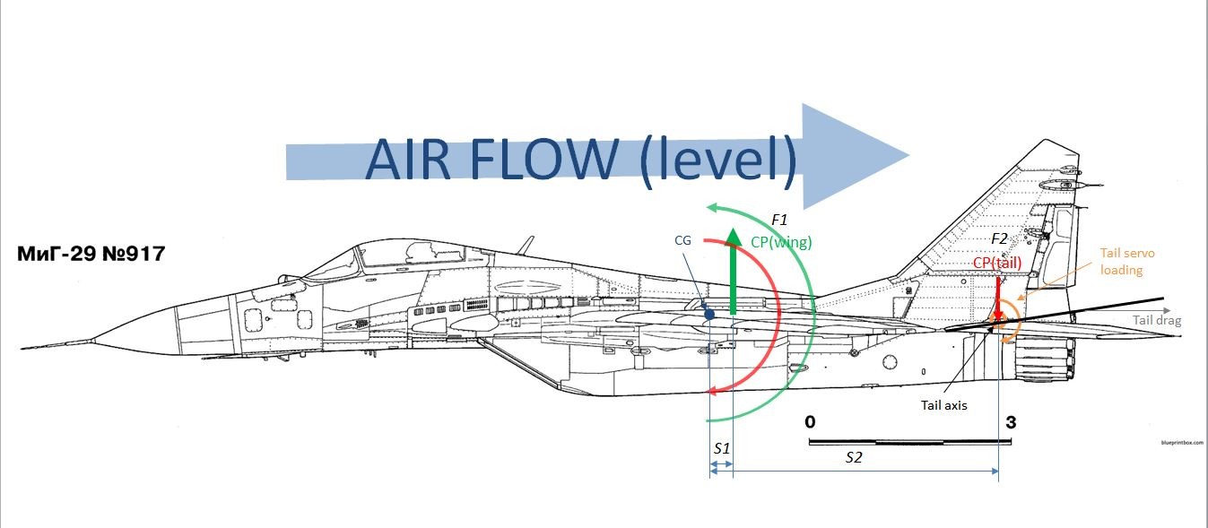

              Was just thinking, is there any way to static test the elevators with some weight that would correlate to simulate in flight load? One would have to figure out an approximate amount of weight that would simulate cruising speed airflow and then also weight for full throttle speed. I'm thinking this would save some jets because the failure would occur on the ground in a controlled way. You could even run the throttle to simulate voltage drop like it was happening during an actual flight. Any thoughts?
                In addition to gravity, tail drag adds to the load on the elevator servos.
                The attached figure assumes the tail's CP is at the tail axle - but that is not the case, so its lift force is yet another additional load.
                          No need to assume anything. The CP is already known and it's way behind the axle.

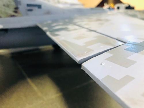

                            I know that most of you have something else on your mind, regarding all these crashes (I've read every single post on these 139 pages) but I still would like to share these nice pics a fellow pilot made of my Mig:

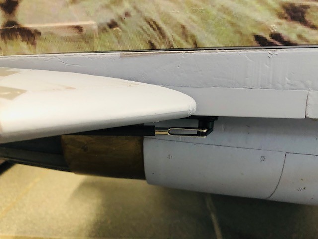

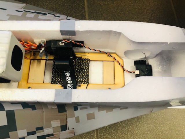

                              I had two flights yesterday.
                              Flight 1 - battery 5800ma (+/- 880gr). CG spot on the marking on the wing.
                              The first test with batteries 45C and no racks I forgot to put the flaps on the takeoff, but no problem.
                              I have been flying with Spectrum for years and the receiver and satellite is at the front of the nose.
                              The servo's were replaced with the included upgrade, but I also replaced the steering rods and connections with 3mm rods.
                              The elevators are both on a different channel directly in the receiver. All the rest goes through the blue box.
                              Here the wheel doors have been moved to the double function.

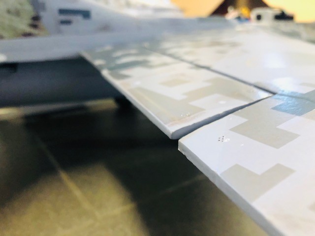

                              What I did change is that both ailerons and flaps are set in such a way that they both end up in neutral position just above the wing. This was something that was in one of the previous posts and according to this would prevent the nose from sinking into high speed low pass.
                              did not have anny issue with all of that.
                              Flight 2 was one with the rockets on the aircraft and 35c batteries and on our grass terrain I had to give a hard pull to the elevator to get off the ground.
                              Maybe this was just because of the higher C content of the battery, this will have to be tested further.
                              maybe with these settings i use, of ailerons/flaps up above the wing and elevator setting (see pictures), I could give it another trim click down, the plane has something of a tendency to lift the nose in full speed now bud it is ok to fly.
                              Too bad but yesterday time went too fast here in Belgium.

                                  Thanks Pieter, we need some of that good stuff too :D
                                  In all of this investigation going on, it is important to not forget how gorgeous this model really is.
