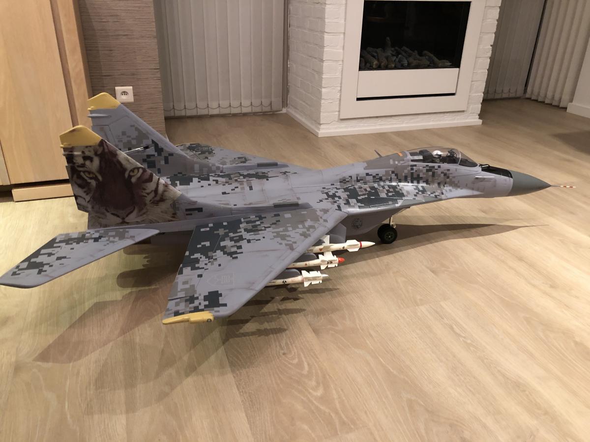

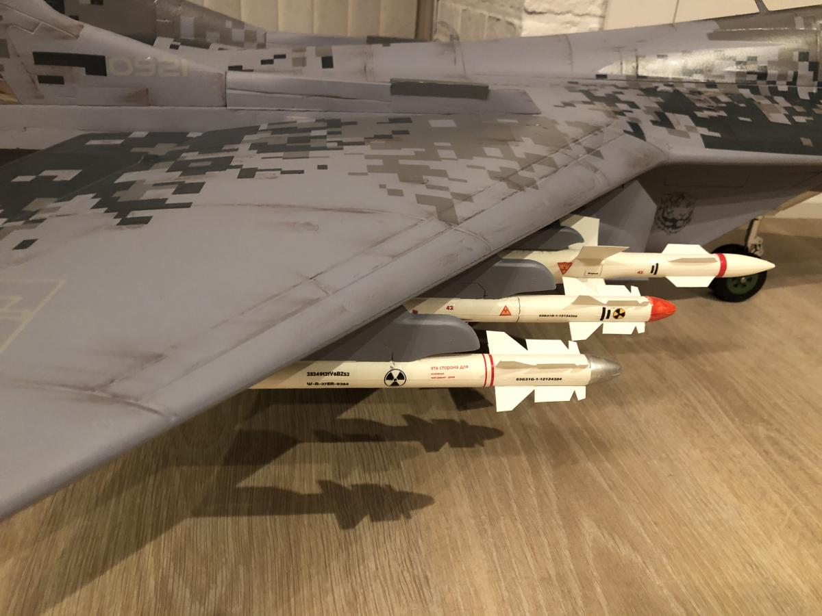

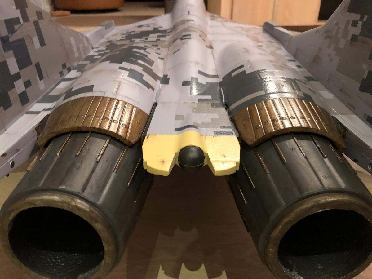

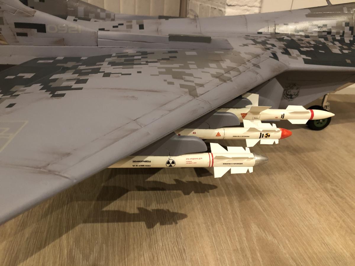

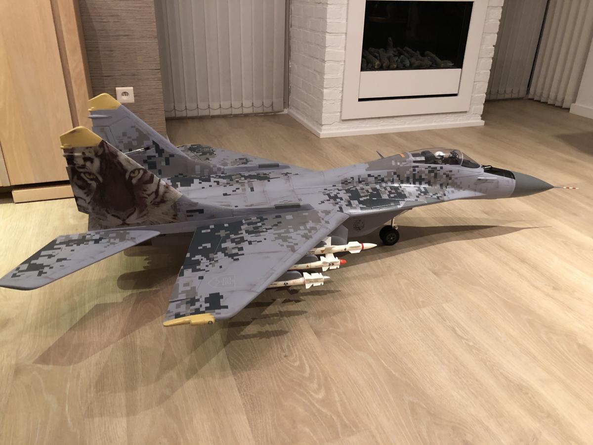

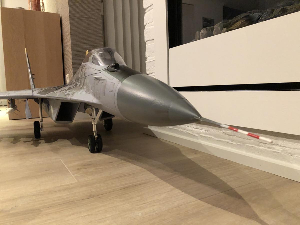

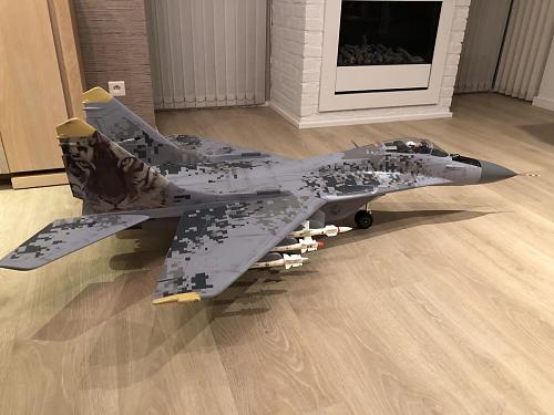

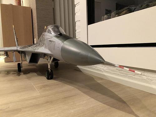

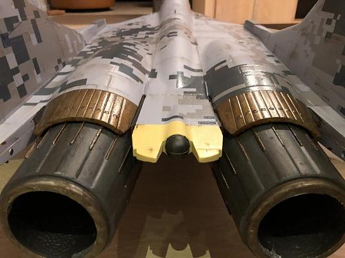

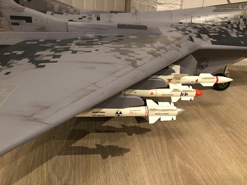

                          Made use of a rainy day in Belgium to weather and pimp the Mig. Possibly not everyone's thing, but tastes differ.
                          Upgraded the elevator servo's and puchrods. Printed some décals for the missiles. A full day work 😁. The following will be the maiden.

                              Edwin your "pimp" looks really great, I love the extra detail you added!! Is the color on the wingtips and fin tips correct to scale? I really like the way it looks.
