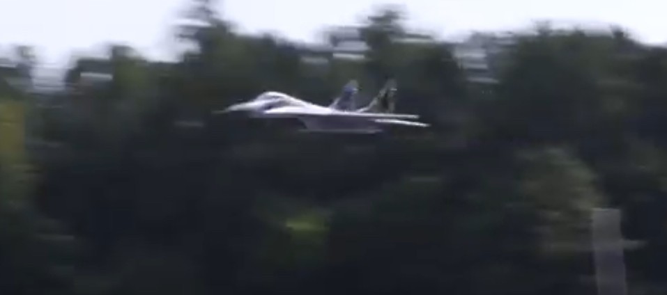

          Here is a capture from the MRC video on their website. I waited for a high speed, no flap pass. No anhedral is apparent. Seems like the flaps being down at high speed may indeed induce the anhedral due to air loads.
          -GG

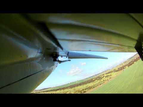

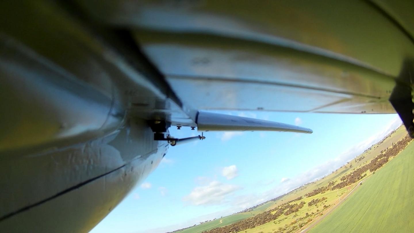

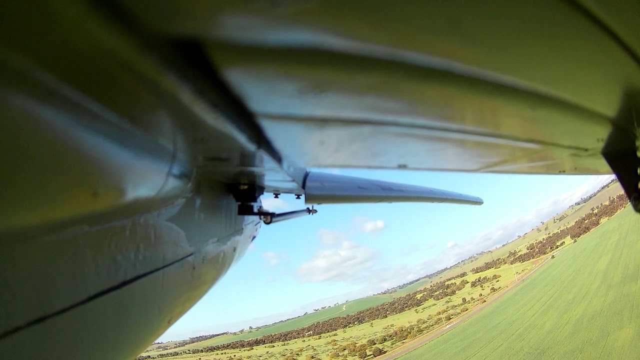

            EDIT: just trawled my footage folder and have about 2 minutes of flying from my maiden day, with the camera pointed straight at the horizontal stab. I'll upload it to youtube and you guys can go crazy with the analysis lol (dont worry it's not a monetised channel). Unfortunately no footage of high energy/flaps down configuration because, well, i generally dont do that.
            Here's a teaser. Got flex? This is particularly noticeable when she's settling in for a fast pass along the flight line.
            Click image for larger version  Name:	Fulcrum Stab.mp4_snapshot_01.27_[2020.11.06_14.19.53].jpg Views:	0 Size:	77.6 KB ID:	284467

                There seems to be a bit of flex but nothing crazy. I guess the failures happen on just the few airframes that may have some glue problems and/or under the most taxing conditions (dive at full throttle with flaps down and nose heavy).

                      I think it kinda have to be flap induced, or at least they make it worse.
                      I maidened mine with a rear facing cam, which unfortunately cut out halfway through the flight, but I did get a fair bit of footage of both half flaps and no flaps. Flew to the first couple laps with takeoff flaps to get that flight mode trimmed out first. Don't see any unusual amount of flexing at all, but that was typically around 50% throttle too, maybe a touch more, but nowhere near wot.
                        That amount of flex indicates the downforce that has to be opposed by the servos, given that the CP is way behind the pivot axis.

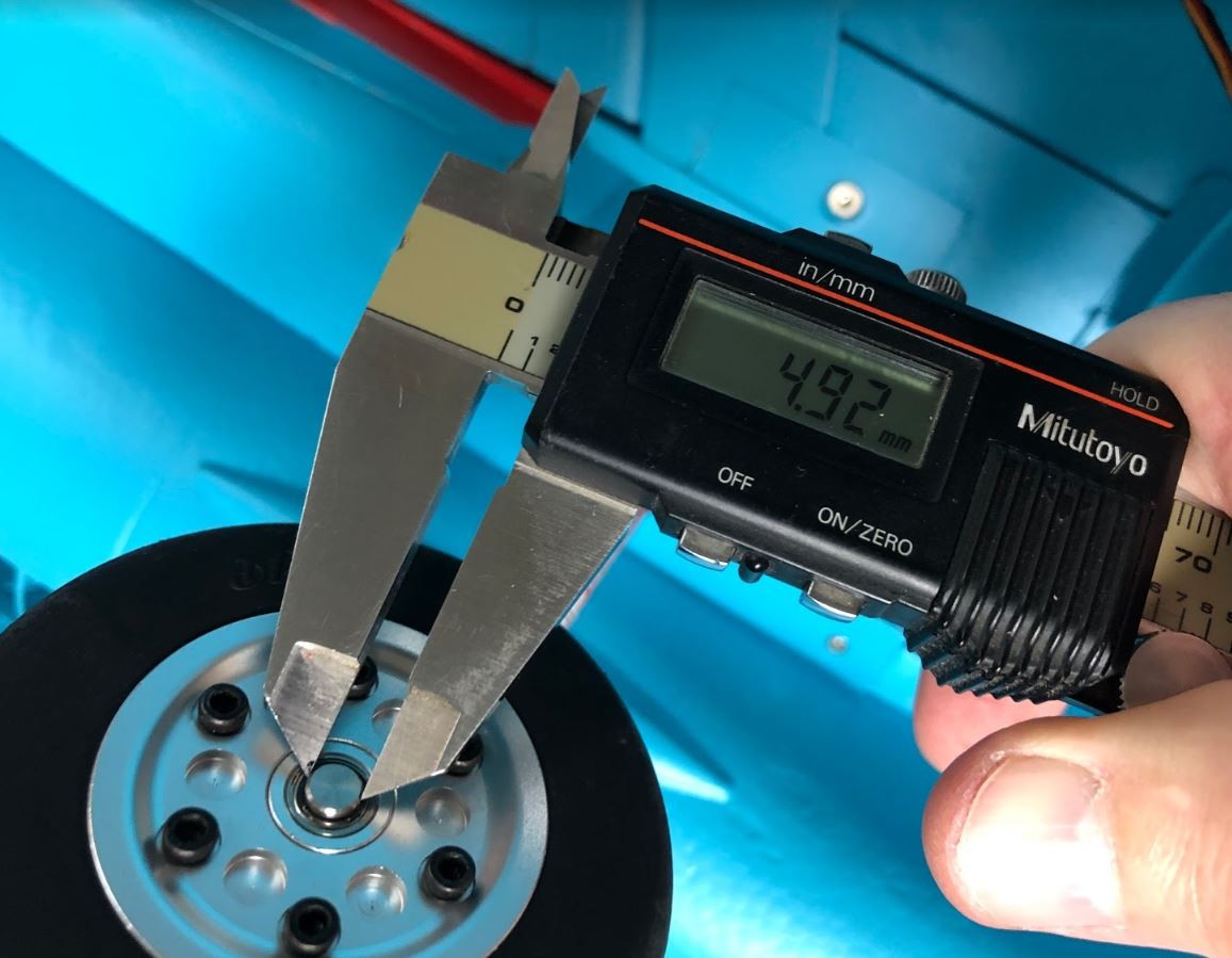

                              Originally posted by DForbes
                              Click image for larger version Name:	Axle.JPG Views:	0 Size:	138.9 KB ID:	284333image_63992.jpgimage_63992.jpg
                              OK, is this what you are showing as an Axle size for your brakes. The main axle is 4mm on my SU30 and I wasn't able to use it and it looks like the same wheels?
                              Yes, the front axles are 4mm the rears are 5mm
                              The JP brakes with 5mm axles takes a lot of work to install. The back of the wheel does not fit the Freewing strut. The 4mm brakes mount flush on the backside of the wheel. When you move up to the 5mm, they have a flange on the backside. I had to do some work to the strut to get it to work. The JP brakes with 4mm axle would fit much easier but you would have to sleeve it somehow to make it fit the 5mm hole in the strut. I think an easier alternative would be the HSD replacement brake set for their F-16. They should bolt right up.

                                Me too! Moving my CG back ASAP. The photo and video are quite telling.
                                -GG
