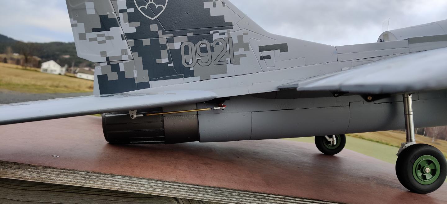

                              My current trim: (still nose heavy) ​

                              • Originally posted by janmb View Post
                                I would not dare fly this model that nose heavy in the first place. It is definitely asking for trouble.
                                All I can go by is 400+ flights on mine and no trouble. Not saying that this trim set-up works or will work for everyone.
                                -GG
                                • I wonder if the reflex in your flaps changes your trim a little. 🤔 I got uncomfortably tail heavy (the tail was dropping on me and the jet felt like it would begin pitch up at anything less than half throttle) and I don’t believe I had that much down trim. Then again, I didn’t put any reflex into my flaps or ailerons. With my CG roughly 10mm back from the stock marks with the gear down I’ve got the leading edge of the elevator just about in line with bottom edge of the fuselage and it’s where I personally found it to fly comfortably and felt neutral.
                                  Click image for larger version  Name:	IMG_20201104_150102.jpg Views:	0 Size:	103.0 KB ID:	284121
                                  • The flaps.and ailerons are aft of the cg. Deflecting them upward pushes the tail down and the nose up.
                                    • Thanks for the info. That would make sense then. 👍
                                      • Originally posted by RudyD54 View Post
                                        Yes, the slight flap reflex does indeed affect the elevator trim (positively)
                                        I had no signs of the model wanting to sit on her butt, neither during turns or when slowing down. That would have been a good sign imo - a neutral or close to it model typically does.
                                        I don't consider it a fault or drawback if a model hangs it's tail if you bank and yank though. A balanced model *should* do exactly that if you don't use your rudder. If a model tracks through a turn, having the nose seek into the turn during bank and yank, it is nose heavy.
                                        There are far better ways of actually testing balance, but this too is a nice little tell to look for.

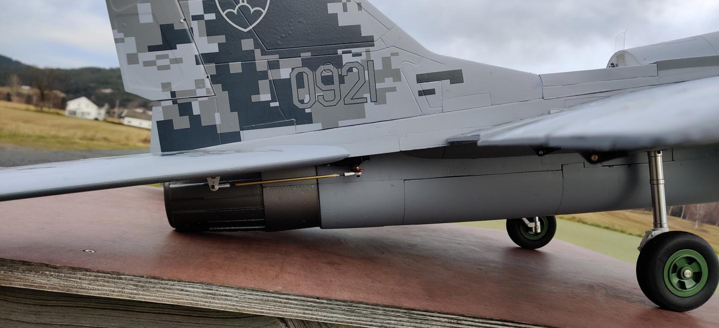

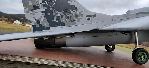

                                        • Well In my opinion something is still wrong with this jet!. I just got back from flying it and it went down. I flew it last week and it did a little dive on its own but i was able to compensate and land it ok. I figured maybe i was flying it to fast and hard so today I went and flew it scale like and it did a dramatic dive and i was able to get it pulled out and it did it again and i could not save it.
                                          I have the updated servos and the updated rods and links. Hopefully some one can get this figured out. Click image for larger version
