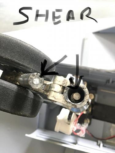

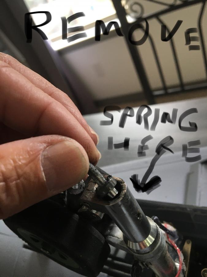

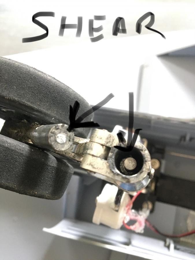

          Something to be mindful of….might warrant a periodic replacement. After well over 1000 flights, the nose gear pin that is internal to the main nose gear shaft and connects to the articulating knuckle snapped. You can’t see this small (about 3 mm dia) shaft unless you take the main shaft apart…or it snaps.
          It was a smooth, main gear first, landing but when the nose came down, it kept going down. I thought initially that the servo had an issue. Nope!
          I always fly off pavement, so the stress of non-pavement surfaces may cause this metal fatigue to happen sooner.
          Replacement is easy…one screw and one Jesus clip. Or….replace the entire assembly.
          The “take-away” is, have a spare nose gear assembly on hand.
          Photos so you can see what broke. Lucky me….I had a spare nose wheel assembly.
          -GG

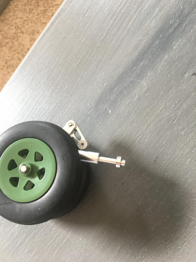

          First….the unbroken assembly:
          Click image for larger version  Name:	38CEE4B7-83D1-45D6-9A66-D3ED4A3EE9AE.jpeg Views:	0 Size:	77.2 KB ID:	314534
          Now…What broke;
          Click image for larger version  Name:	8C47A02D-CDF4-4E17-9A0B-483987585D97.jpeg Views:	0 Size:	56.3 KB ID:	314522Click image for larger version  Name:	E3F853BE-D0F6-4B08-9CB0-EBA9FA45BD6B.jpeg Views:	0 Size:	58.6 KB ID:	314523Click image for larger version  Name:	C24D2E89-5FC2-425F-85FF-97636A5EDCC0.jpeg Views:	0 Size:	62.8 KB ID:	314524

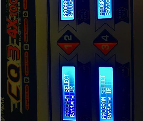

                                        I found the documentation...screen captures shown. I knew I wasn't dreaming. Also showing a photo of the front with Battery IR option showing. This option comes up right after the Battery Meter option as you scroll through the menu. Only one of my 3 CQ3 charges have this option.
                                        Click image for larger version  Name:	CQ3_Display.jpg Views:	0 Size:	101.5 KB ID:	314641

                                          • 2716
                                          #4740
                                          GliderGuy seeing is believing! Checked mine out and it definitely does not have the IR function. That's certainly a nice feature. Both of mine are a couple years old so they must be the "antique" versions, although my AC plug is on the top of the side panel and not on the bottom, so maybe your 3rd unit is the latest and greatest! Just my luck, I'm usually "a day late and a dollar short". Even so, these quad chargers definitely are nice units and save plenty of time.
                                          As long as your total IR values for 6S 5000-8000 mah batteries are in the 15 to 25 milli ohm range, they should be acceptable for these high current draw EDF's, Since I fly off grass, any thing more and the take-off run is laboring.
