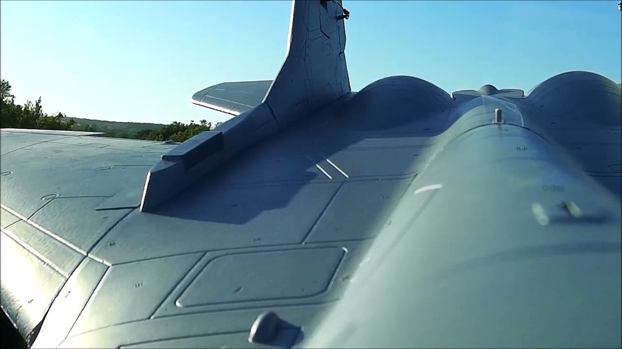

                                    • Jump to 2:22 and 4:44 for the flap-stab issue showing in full glory.
                                      • But the plane recovered and flew level. At full throttle, before and after. No irrecoverable dive. Is it a big issue for an infrequent scenario? With the stronger servos, the pilot will soon enough notice that speed is sluggish for the throttle setting, as well as the elevator compensation, and correct the situation. If your nose pitches down and you don't do anything, then it's a pilot issue.
